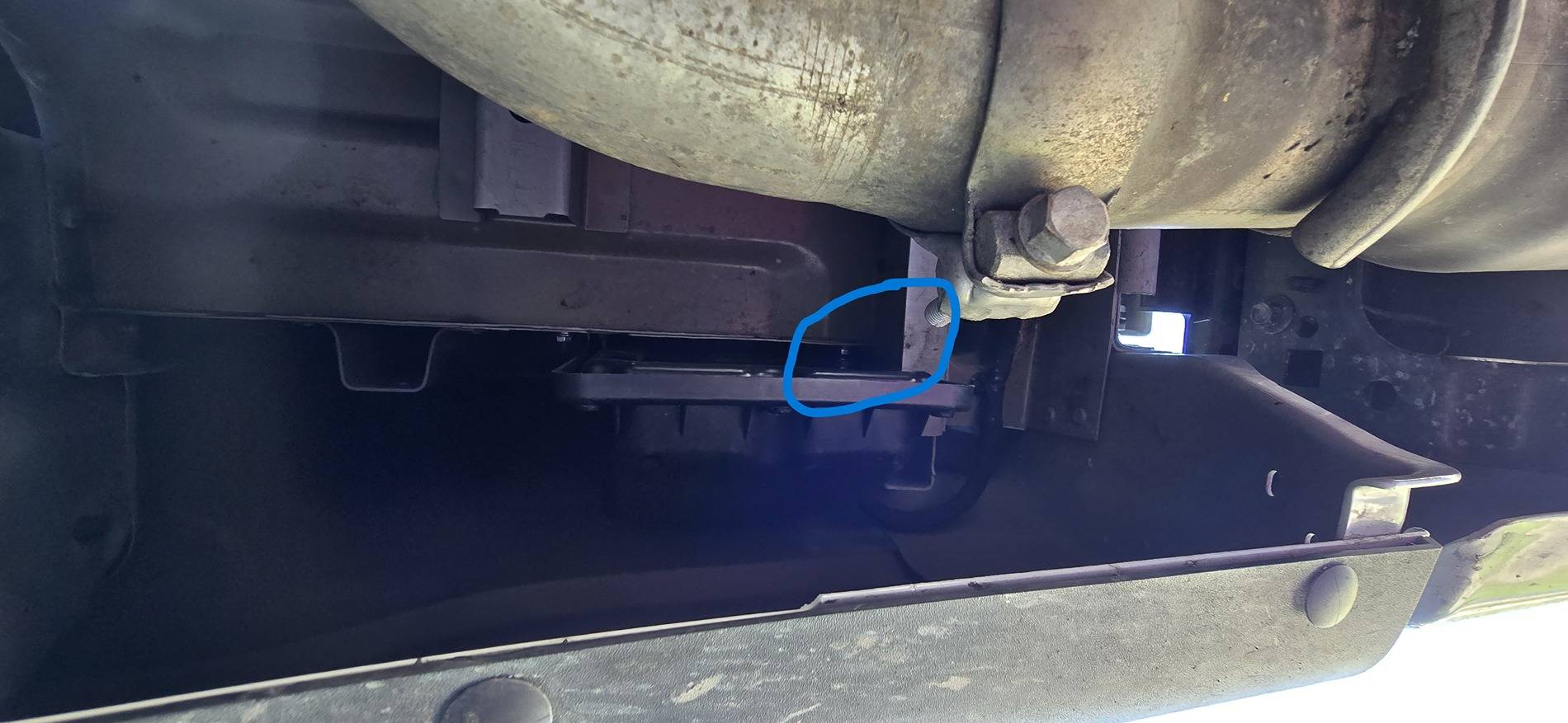

Position the template on your bed panel side, see Figure 6 7. Note out you will be constrained by the bed back, bed ribs or corrugations and floor. Keep in mind you will need to use cutting tools for the LCP hole and drill holes in these tight spaces and corners.
Crawl underneath your truck with a good light and inspect the area around where the LCP will be installed. Note anything that may keep you from installing the LCP or using your tools. Compare what you are seeing with how the LCP is mounted in a MY24, see Figures 8A 8B 8C 8D.

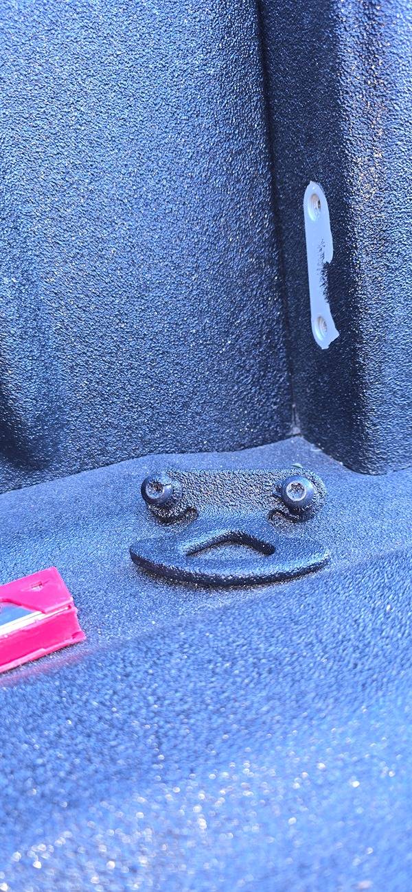

Take any tie downs off and out of the way. Take your taillight out and zip tie the wiring back so its not blocking your view and to where it can be avoided by cutting tools, saw, or drill bits. Cover the connectors so they do not get aluminum dust in them. Cutting and drilling are very dusty. See figures 9, 10, 11.

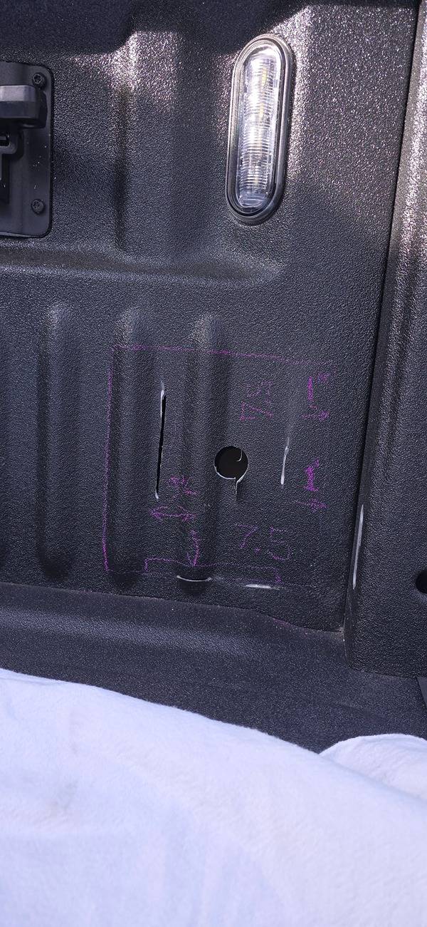

Using your templet mark the hole to be cut and mounting holes, I used a grease pencil. Put on your gloves, eye protection, and mask (aluminum dust is not good for the respiratory system) and make a few practice cuts and holes on the piece you will be cutting out. See Figure 12.
I used a step bit and carefully drilled holes on the inside of the corners of the area to be cut out. Following this I cut the area out for the LCP using a small hand saw, with of all things, a drywall blade. It worked very well. Keep in mind that it is better to start small and trim than to be too big and not be able to drill positioning and mounting holes. Where I cut is about the only place I believe can be used. There are issues in the bed panel and the underneath framing that prevent being even a few millimeters off on placement of the LCP. Be careful, go slow, sneak up on it so to speak and measure, check, and measure again before cutting to final.

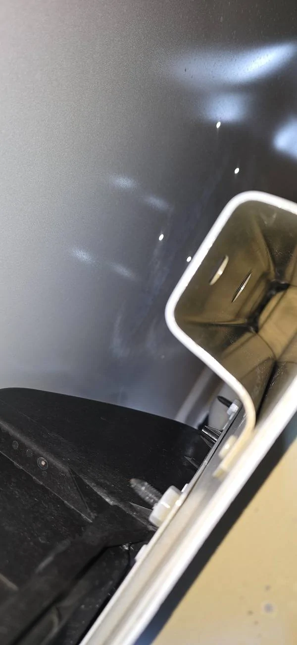

Position the LCP in the it hole (using its set posts) exactly how you want it to be positioned once attached to the bed. Mark the LCP mounting holes. I did this by drilling small pilot holes into the bed side panel using the LCP mounting holes as a guide. Again, make sure the LCP is steady and does not move from its anticipated final position when marking the holes or drilling pilot holes. Remove the LCP and drill the final mounting holes just large enough for the bolts.
STEP E) Mounting

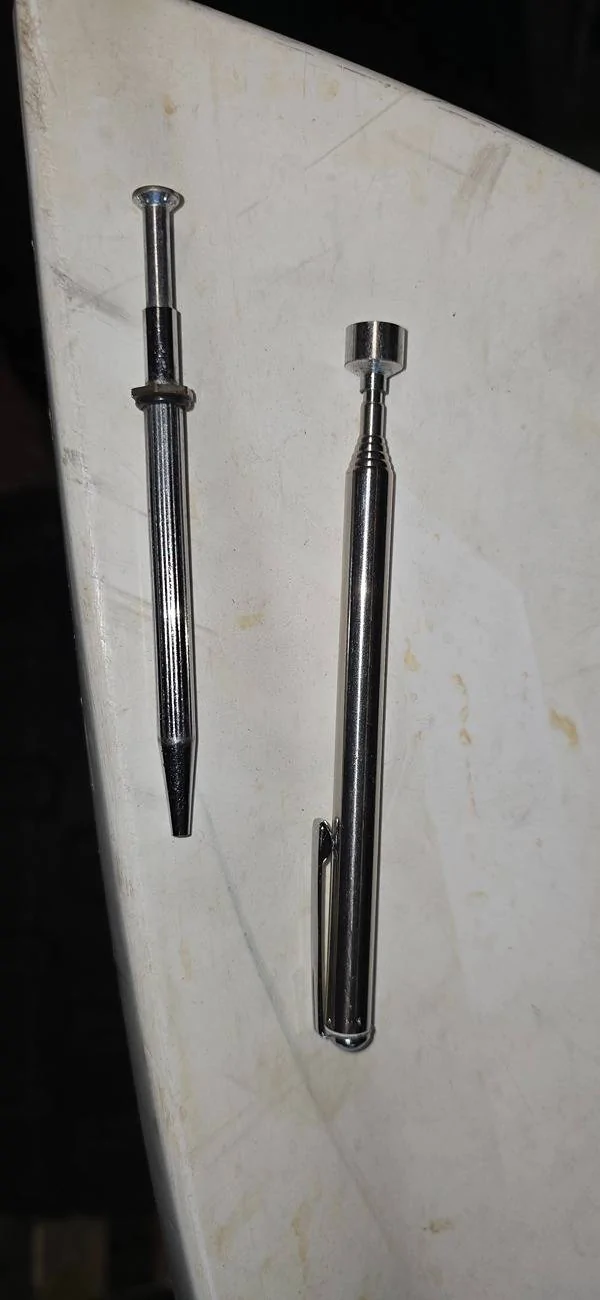

Insert the LCP back into the large cut hole lining up the set posts. It should be snug. Apply some blue thread lock to the bolts, line up the bolt holes and insert the bolts through the LCP and truck bed. Install a washer, lock washer, and nut on each bolt. The two bolts on top were accessible through the taillight hole and the bottom bolts are accessible from the bottom.
Getting the washers and nut on the bottom back bolt is a PIA and for me the most difficult part of the installation. Because I could only just touch the bolt end with one finger I had to use a magnet to play a sort of ring game to get the washer on the bolt, then a similar ring game using a grab tool to hold the lock washer until it was placed on the bolt end. For the nut, I taped one side of it inside a ratcheting box wrench, held it on the bolt end while my wife turned the bolt head from the bed side to start it. Once started I spun the nut with a single finger to seat it and then used long nosed needle nose pliers to keep in from spinning as my wife to torque the bolt into the nut.
