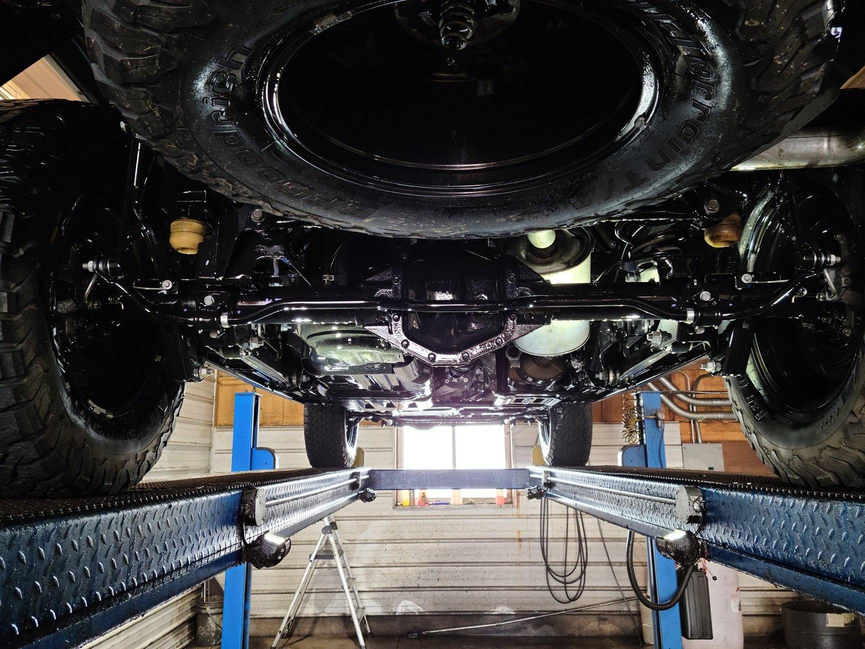

Hey folks, just wanted to add a quick post on how we apply fluid film to our vehicles. I use this on our tractor, implements and just about anything that is metal and exposed to the elements. This stuff keeps rust at bay, finishes looking new and wiring insulation/grommets/harnesses supple. I shot the truck the first week we had it. I do the routine seen below once a year on our vehicles. I use the 360° every few years. I show how it works in a video but you don't need to shoot the frame cavities but once every few years, the stuff just stays put. This means that you can shoot the entire undercarriage yearly in about 30 minutes.
A gallon can be had on prime or walmart for right around $50. They offer black and original, I always go original because I don't like the idea of hiding or masking anything. So far I have zero rust in the typical problem areas but I wouldn't know if I shot the entire undercarriage with black FF. As for a gun and wands, I've been using this kit for years and it has been flawless. One nice thing about FF is there is no cleanup of the tools, containers, gun etc. The product just maintains its state and even the gun fully globbed up can sit for years and just shoot again when needed. I just wipe stuff down and let it sit until I'm ready again.
I don't do this to ensure the truck lasts 1000 years, I do it so that come resale time there is no haggling or question as to how the truck has been maintained. People, whether they know what they are looking at or not, bend down to look at the undercarriage. When they see one glistening like new right there the decision is made even if your truck has the higher miles of the options the buyer is exploring. Preventative maintenance of course is comprehensive but I can't tell you how beneficial it is to have a new looking undercarriage come sale time.
A few tips:
- Park the truck outside for a few days after shooting. FF has a unique smell that gets old quickly (at least for me, some like it) but after 2 days outside it dissipates.
- If any lands on the exhaust (mine always does) it will smoke a bit when you warm it up, after a drive it burns off. Same with overspray on rotors, after the first hard stop it will have burnt off.
- As mentioned in the sink video, if you don't have access to a hot water easily just use a bucket. Get a few extra canisters and just leave them in warm water until you shoot.
Here is my gear including the kit mentioned along with a few additional canisters.
Ford F-150 Applying Fluid Film to undercarriage, quick write-up with tips to make it very easy. fluid-film-supplies
Here is the best way (I've found) to fill the canisters. As mentioned above I never clean these, after I shoot a canister it just sits until I refill again next time. No need to rinse yada yada.
Here is the gun setup, really basic.
Here is the 360° wand.
Here is how FF flows. This canister was a bit low and would spurt but you get the idea.

Krown for me. I think any oil based product that creeps a little is going to leave you in great shape. Do you do a full rinse prior of some other prep. Your rails look very clean prior to spraying. Mine are covered with road grit from prior applications

I love Krown, we'd leverage them every other year while we lived up in the Poconos. Sadly outside of the Northern Tri-State area they don't have any applicators. Now that we're back down south I've been sticking with FF. Back up north we'd Krown every few years then FF touch-ups along the way.
No prep underneath, I shot the entire undercarriage lightly upon delivery. It certainly isn't anti-stick but when it rains anything trying to gunk or pile up rinses off pretty quickly. I avoid undercarriage pressure just from living up north and seeing salt forced into crevices, essentially backfiring and defeating the whole purpose.
This 2016 Golf R was Krowned nearly its entire life (every 2 years, sometimes every 3) and served as a DD in some of the craziest PA mountain winters. It was 6 years and 90k miles old in this photo, undercarriage looked nearly as good as new. This second shot is our gladiator, sold it at 60k miles still looking new underneath, Krown as well.
Ford F-150 Applying Fluid Film to undercarriage, quick write-up with tips to make it very easy. rear_left
Ford F-150 Applying Fluid Film to undercarriage, quick write-up with tips to make it very easy. glady
