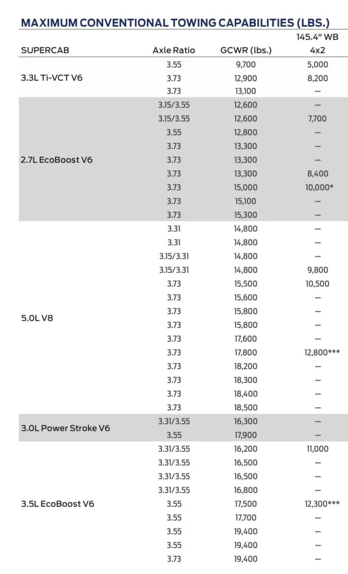

Might be worth calling your dealer as it appears to be available but may require max tow at the bottom
Ford F-150 3.31 rear axle vs 3.55 1C6318EA-28E3-43BC-A950-20C2DE1B904C
