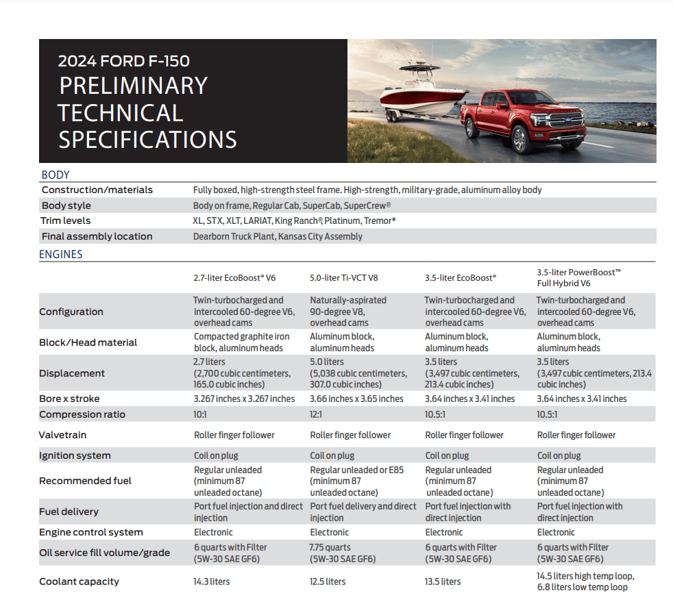

They advertise E85 compatible when you build the truck....

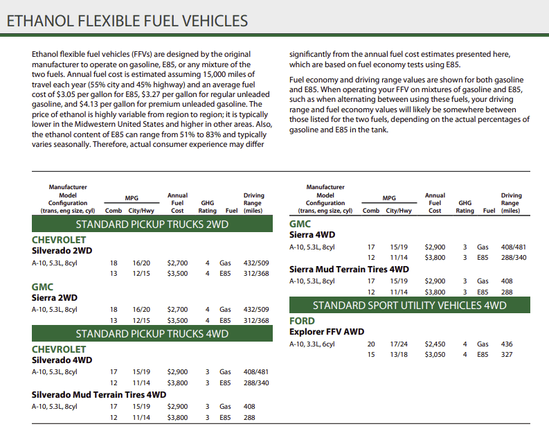

Key word in that spec sheet from Ford Media website is "Preliminary". Everything I've seen recently - the '24 F150 OM, '24 F150 specs from Bodybuilder site (now in Ford Pro for some reason), and even '24 EPA Fuel Economy Guide - do not show the 5.0 liter as Flex Fuel, 87 octane min. only. Guess if you want a FFV PU you get a Silverado/Sierra with a 5.3 (or an Explorer with the 3.3).
fordpro.com/en-us/upfit/publications
Ford F-150 2024 5.0 and Flex Fuel... 5.0 fuel
2024 Fuel Economy Guide
Ford F-150 2024 5.0 and Flex Fuel... epa ffv

I can’t find any change in the fuel pump or injectors, so a tuner will be able to simply turn it on like GM with the 6.2

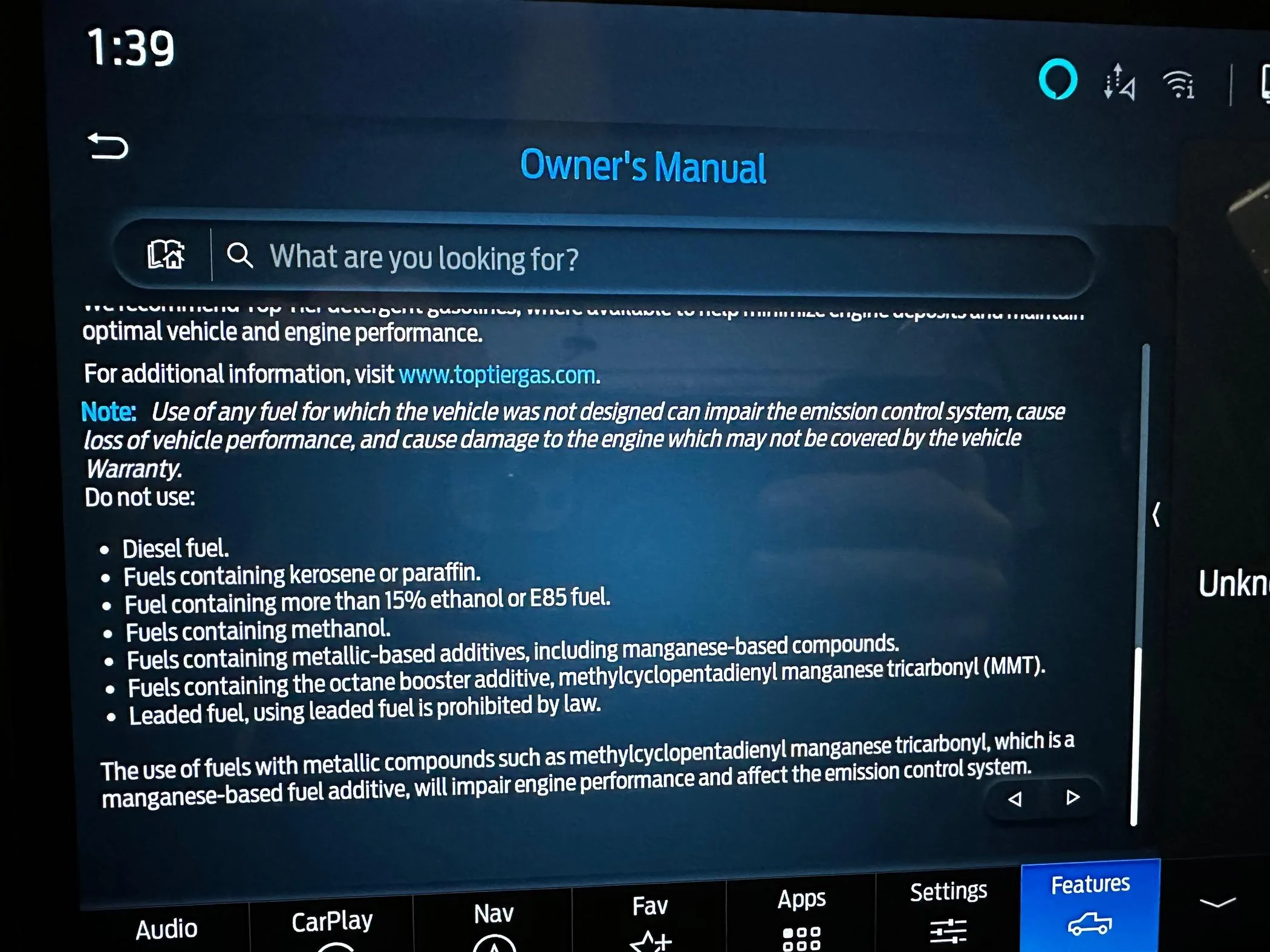

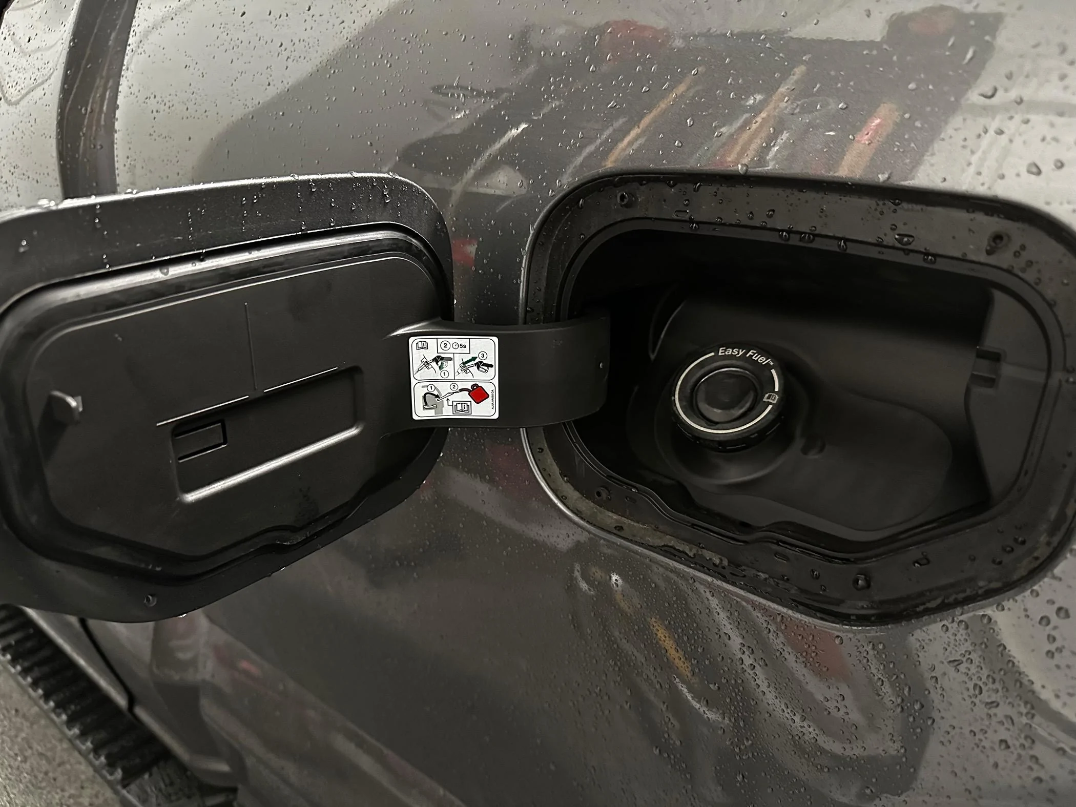

Picked up my 2024 5.0 this morning and got these pics
Ford F-150 2024 5.0 and Flex Fuel... IMG_5105
Ford F-150 2024 5.0 and Flex Fuel... IMG_5108
