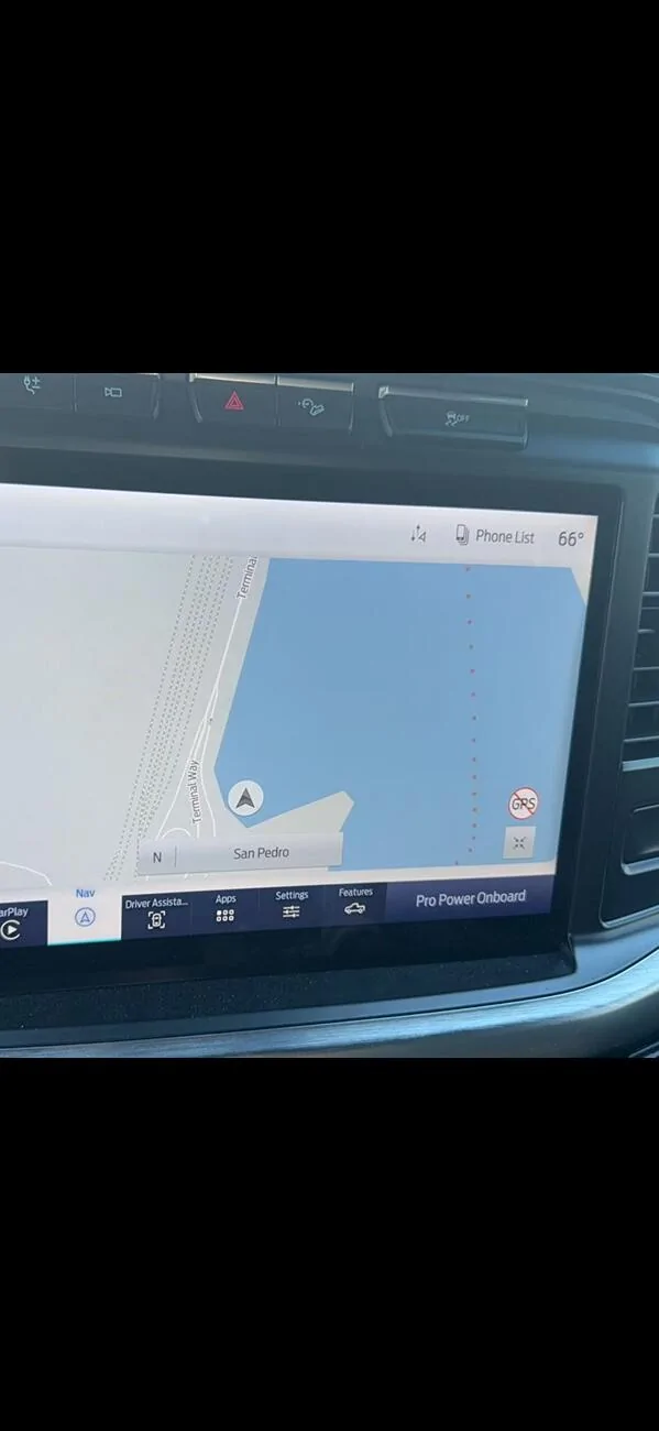

Navigation has a red line across the GPS sign, and the vehicle location of the vehicle is out of whack. I’ve tried to restart Sync4 by press and hold the volume and the right seek buttons for a long time, but the screen didn’t restart. Is this the correct way to restart the sync4 screen?

Thank you. No wonder it didn’t do anything lol. It actually fixed itself when I went home last night. Guess the truck been off for a couple hours reset something.
