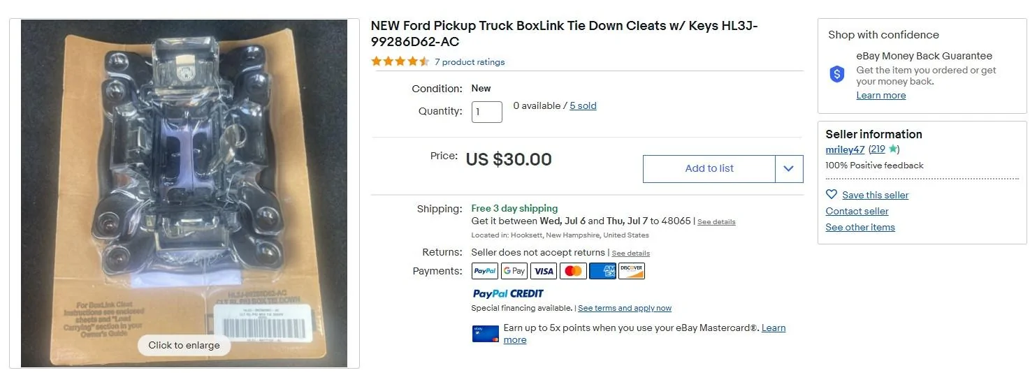

Apparently a lot who get the Bed Use Package don't use it because the cleats are all over Ebay. I offered $25 shipped and the seller accepted, still in the blister packaging. Maybe it's a Lariat thing but even though I didn't get the Bed Utility Package/Tailgate Step/Light....my truck had the metal plates installed.
Ford F-150 2022 without Bed Utility Package Box Link Options? Screenshot 2022-07-01 075301
