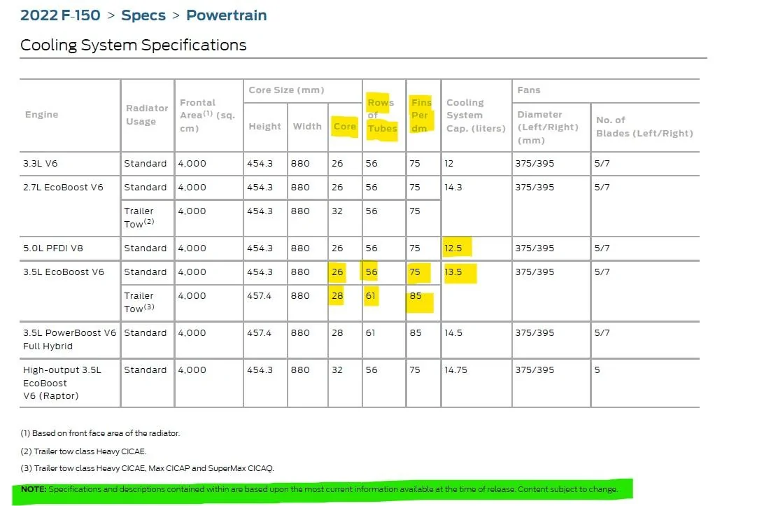

I'm not sure if you've seen this but I'll attach a page out of the 2022 E-book that might make you feel better if you ordered the 53a. That DOES say you at least get the upgraded radiator, which would've been enough for me to order it. However, they do say "subject to change" on the bottom, which could explain why it didnt make it to the Tow Guide....it changed by the time they printed the guide?

I'm attaching a page out of the 2022 E-book that might make you feel better if you ordered the 53a. That DOES say you at least get the upgraded radiator, which would've been enough for me to order it. However, they do say "subject to change" on the bottom, which could explain why it didnt make it to the Tow Guide....it changed by the time they printed the guide?

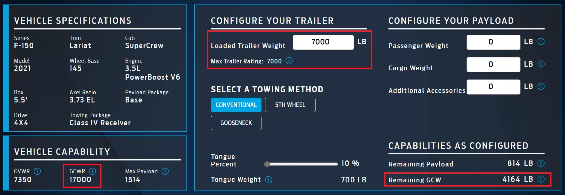

In the never-ending discussion of "what can my truck tow?", here is what the calculator gives me for my 2021 F150 Lariat Powerboost FX4 501A with the Tow Technology Package 17T (not the Trailer Tow Package and not the Max Tow Package).
Ford F-150 2022 Lariat PowerBoost: Tow Tech (17T) vs Trailer Tow (53A) Screenshot 2022-08-18 143108
The calulator recoginizes that I can only hook up a 7000 lb trailer, but since I have a GCWR of 11,000, that leaves me 4,164 of left over GCW. (I didn't bother adding passengers, payload, etc).
So ... based on that, where am I supposed to put that additional 4,164 lbs? Can't put it in the truck, as that would be over the payload limit. Can't put it in the trailer, as that would be over the 7,000 lbs tow limit.
WTF Ford? WTF?
