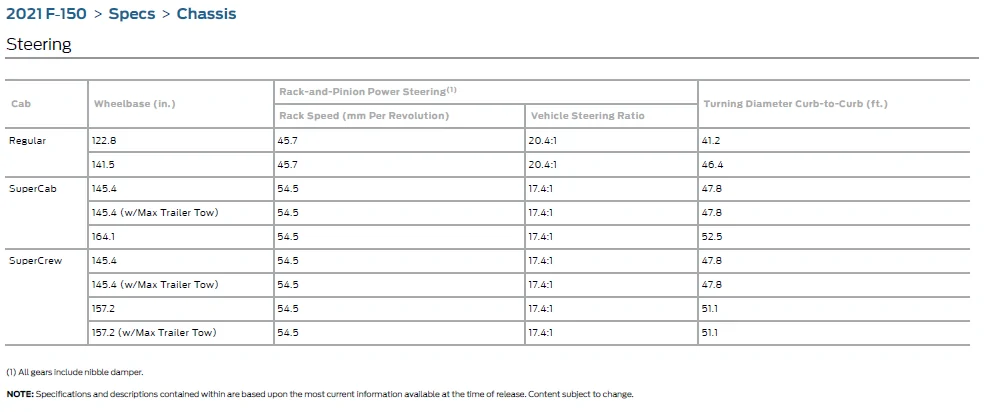

This is what I found from Ford on the 21's
Ford F-150 2021 Turning Diameter 1623931348377
I know I rarely am able to park mine at a single attempt in most spaces. :)

Yup. This is the 2015 (which I assume is the same until 2020) :
https://media.ford.com/content/dam/fordmedia/North America/US/2015_Specs/2015_F150_Specs.pdf
Ford F-150 2021 Turning Diameter Screen Shot 2021-06-17 at 12.11.56 PM
47.8 for 5.5ft bed Supercrew 4x4 and 4x2. Same as 2021 listed specs...
I'm hoping that the extra inch of tire on the 20's caused the ford engineers to adjust when steering locks for rubbing purposes. I ordered mine with the 18's so if it ever comes I'll let you guys know if it's any different.
