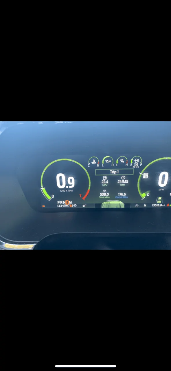

Actually in the instance in the picture ICE was running as evidenced by the tach. Not sure about other instances.
Sure am looking for any help I can get because tech at the shop I scheduled to look at it was definitely deer in the headlights.

Hope the picture shows that the ICE was running . tach at idle RPMS
