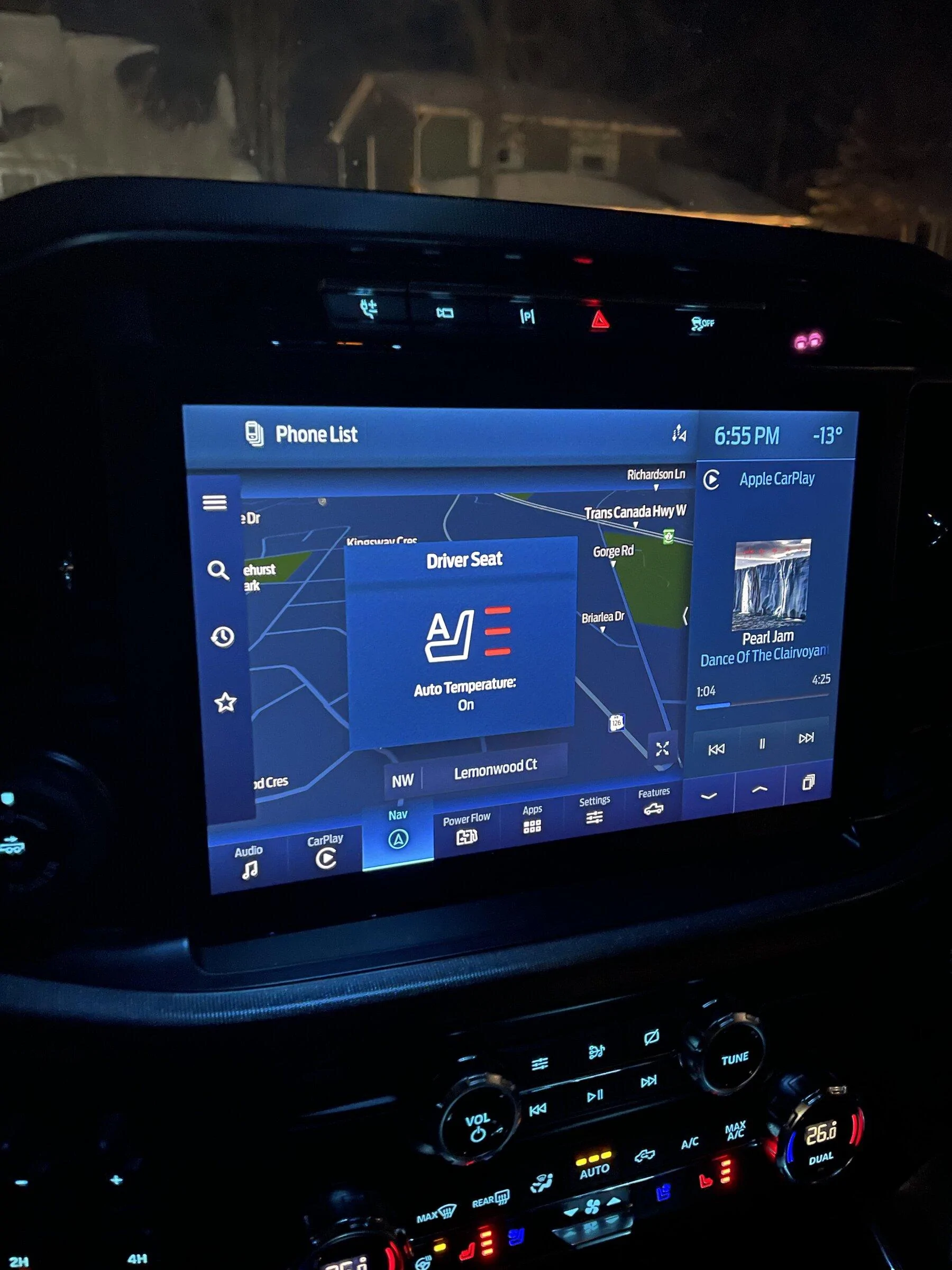

Can someone explain to me what auto seat temp actually does? I dont get what the purpose of this is.
it adjusts the heater and cooled seats to align the set HVAC temp. If HVAC is raising the temp, the heated seats come on varying the intensity to align. If the HVAC is lowering the temp, the cooled seats come on to align.
