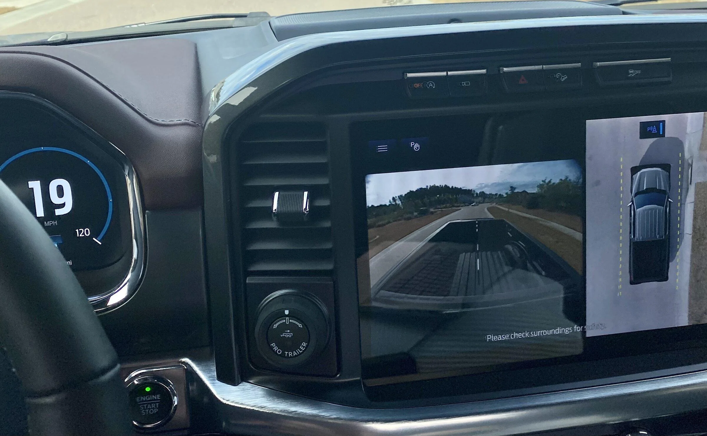

Did you get it to work on the main display (I.e. get up to speed and then push the camera button)? Mine works, just takes up the whole screen. This is at 19 mph. The second picture shows my sync version too. It updated to this version before my cam would work at speed. It went to this version with an over the air update.
Which sync version are you on? I’m on 2.1.1
My sync version is the one pictured above 21146 revision 145 . I am on power up 2.1.1, but power up and sync version are not the same thing. Power up is the updates, but may update more modules than just sync, if that makes sense.

Today I learned! Thanks for the clarification. So to achieve the cameras past parking lot speeds, do you remember which values you changed? Also do you mind sharing your f150 specs? Mine is XLT 302A, crew cab, fx4, 3.5 eco.
