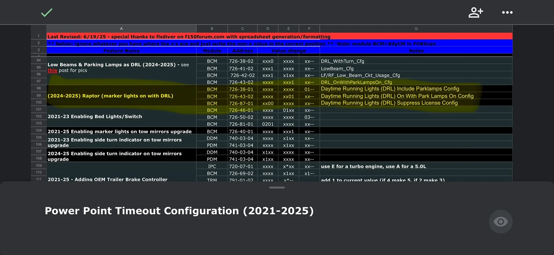

I’m trying to get my parking lights to stay on all the time (because I’ve tied vent lights to them), similar to a raptor light install.
I’ve checked these settings, and they all seem to be correct, but my parking lights still turn off shortly after starting the vehicle.
any ideas what I could do? 2025 XLT
any ideas what I could do? 2025 XLT...
Ext Courtesy Lamps Config
726-17-02 x1xx xxxx xx-- change to x0xx xxxx xx--
DRL by Autolamps
726-21-01 x0x0 x0x0 x0-- change to x2x2 x2x2 x2--
DRL by Autolamps Feature List to BCM Initial Value
726-27-02 xxx0 xxxx xx-- change to xxx2 xxxx xx--
And:
726-43-02xxxxxxx*xx--DRL_OnWithParkLampsOn_Cfg (DRLOWPLOC)
Set to 1
These are the settings that will leave the DRLs on regardless of headlamp switch position. Your current problem is auto lamps which, when you change the switch, leaves DRLs off. I did these all on my '23 and except for the last one (which was located at a different BCM address), they are the same.

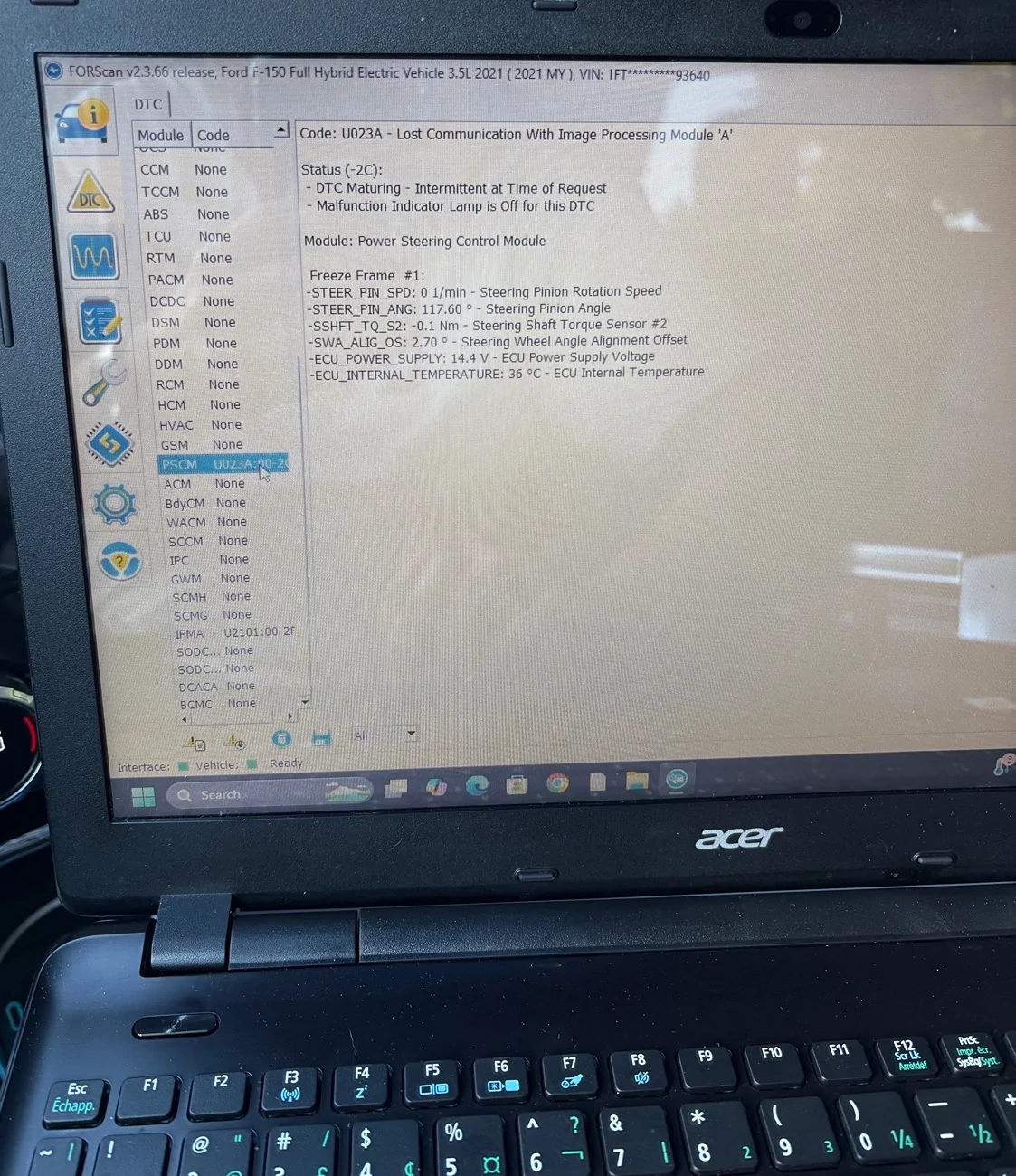

Hi all, I am also trying to get hitch assist to work on my 2021 job 1 PB. My truck took the pcm, abs and apim changes fine (apim was actually already set), but I am having a problem with the ipma. When I switch the value I immediately get a pre-collision assist not available error that won’t clear. DTC shows an error code U2101. I can get the hitch assist menu to show up with it enabled but looking for ideas to resolve this conflict?

@eventhrzn80:
1. What are the details of the IPMA DTC? Post a screenshot of them.
2. Precisely what change are you making in the IPMA for auto hitch? Before value and after value.

5 is correct for that position in the IPMA. You also have a DTC in the PSCM. Likely that is related as the PSCM is required for steering input for auto hitch, PTBA etc. So:
1. what are the details of the PSCM DTC?
2. Do you have Pro trailer backup assist? What do you have for PSCM:
730-02-02xxxxxxxx**--TBA: 00=TBA Disabled 01=TBA Standard Enabled 02=TBA w/5th Wheel Enabled 03=TBA w/TRG Enabled 04=TBA w/5th Wheel and TRG EnabledTBA=Trailer Backup Assist TRG=Trailer Reverse Guidance

This is the PSCM DTC. I can clear this one after the change but not the IPMA one.
Ford F-150 2021+ F-150 FORScan List / Database / Spreadsheet IMG_3775
for 730-02-02, it is set as 03 (TBA with TRG enabled).

This is the PSCM DTC. I can clear this one after the change but not the IPMA one... for 730-02-02, it is set as 03 (TBA with TRG enabled).
Well, no probs with the PSCM DTC. 03 is correct if you have Pro Trailer Backup Assist.

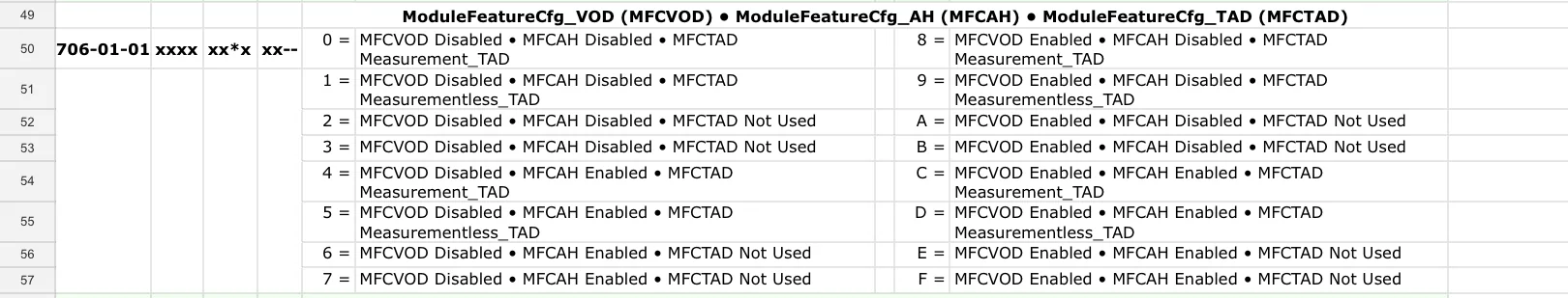

Great news! I was able to figure out the issue.
I noticed an inconsisent setting for the Trailer Light Module. 706-04-01 *xxx was set to F which said Trailer Light Module was present. 706-18-01 xxxx xxx* was set to 4 which said it was not present. I changed this to C, then turned auto hitch on, and it works and there are no error messages on the dash or DTCs. Turning auto hitch on must have exposed this existing inconsistency.
Thanks everyone for the help.
