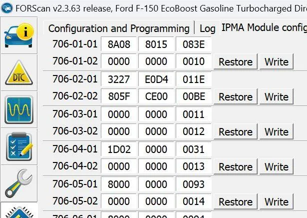

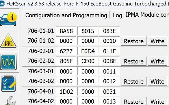

@SilverPigeon I made these changes and most of it worked. The SSR definitely works outside of the ACC too and was able to pick up speed changes along my drive without any issues. QQ - has SSR anyway stopped FWD collision prevention?
However, if I keep the SSR enabled within ACC - it throws me an error on IPC when I start ACC and ACC doesn't adapt to the speed signs. Screenshot below:
Ford F-150 2021+ F-150 FORScan List / Database / Spreadsheet 1731666976029-w1
These were the changes I made on IPC and IPMA and rebooted modules as per the order in the last message:
Ford F-150 2021+ F-150 FORScan List / Database / Spreadsheet 1731667030674-q5
Ford F-150 2021+ F-150 FORScan List / Database / Spreadsheet 1731667065915-5z
Greatly appreciate you. :)

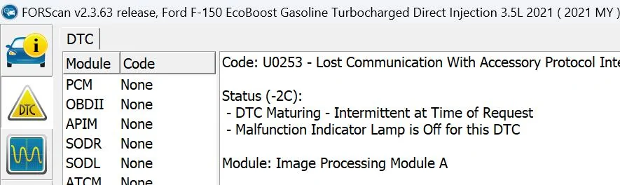

Cheers mate, I made the changes, taking the truck for a quick spin to test. Will circle back in 5 minutes or so.
@SilverPigeon Back from the quick spin. It picked up the IACC the first time around and when I'd break the CC - after that every time it threw the same error, till I rebooted the APIM with the radio buttons and it would kick in again after that.
Let me explain. In Dubai, we have a buffer of 20kmph on the speed sign, so if a road is 100kmps, you are fine to go till 120kmph. I got to a road where it is 80 kmph and IACC kicked in with tolerance of 19kmph so CC moved to 99kmph on its own. I switched off ACC with the steering button for a while as I went through small roads and next time I switched it on, it threw the same error as before. I rebooted the APIM and the IACC worked again when I pressed the button with no errors this time.
Weird issue. The SSR seems to be consistent and working fine. There was a DTC in FORScan that I cleared.
Ford F-150 2021+ F-150 FORScan List / Database / Spreadsheet 1731671070950-wg
