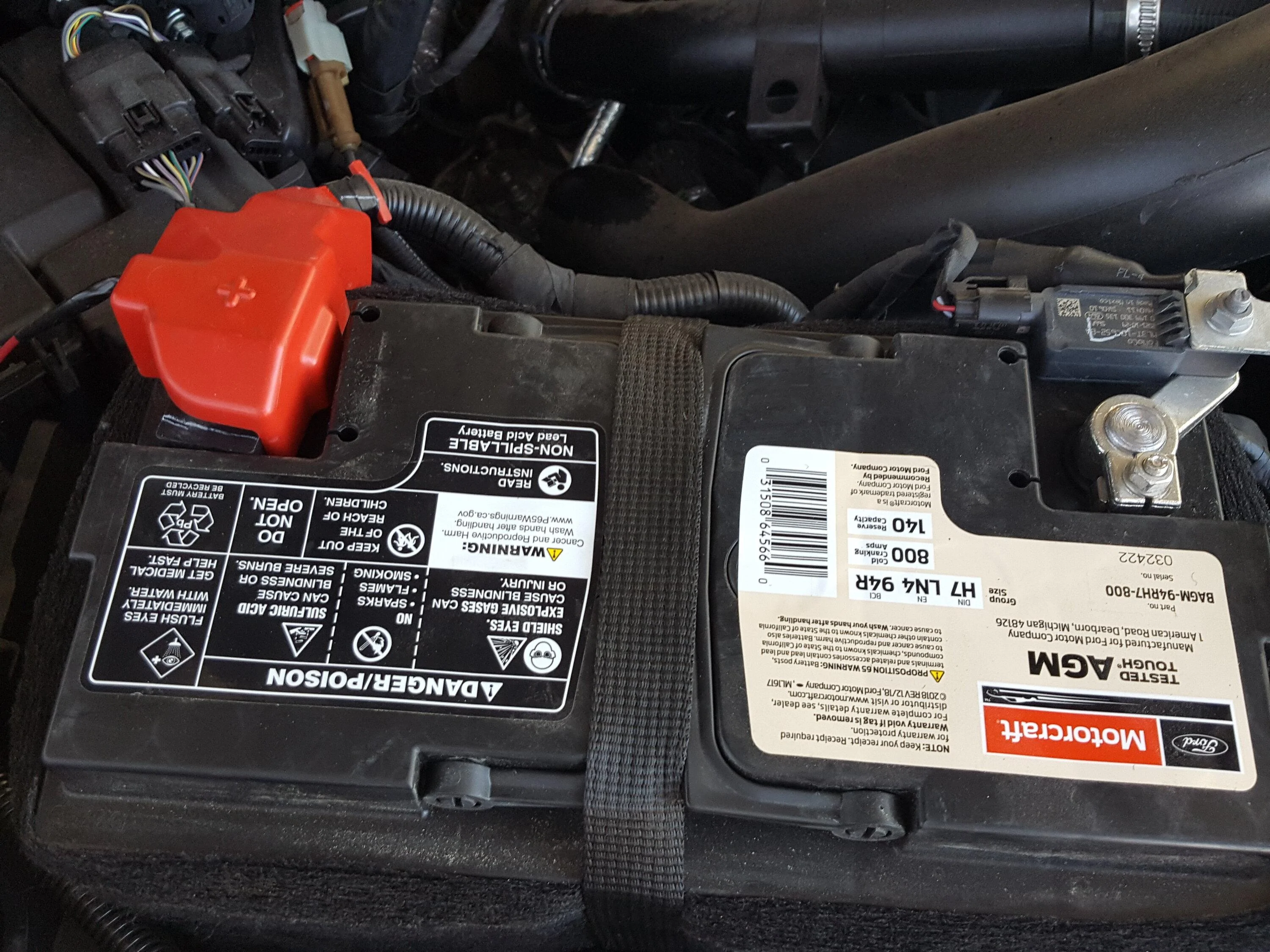

on my 2022 i had battery issues from week one
deep sleep, 40% soc, etc.
i found in the 2022 spec build sheet the battery that was installed in my 2022 was not what was specified , so ford rep here and my dealer arranged ( i think) to put the bigger specified battery 860 in the truck and i increased soc in forscan to 95%. it seems to help, unless truck sits for a week then it goes to sleep but seems to do this at 60 -65% soc as read by my battery charger.
also if i open truck more than 4 or 5 times without start and running it to recharge, i get the sleep notification earlier. so i try to limit opening to get stuff

Yup. Solved it by installing an aftermarket AGM battery the first time this happened. About 11,000 miles later it hasn't happened again.

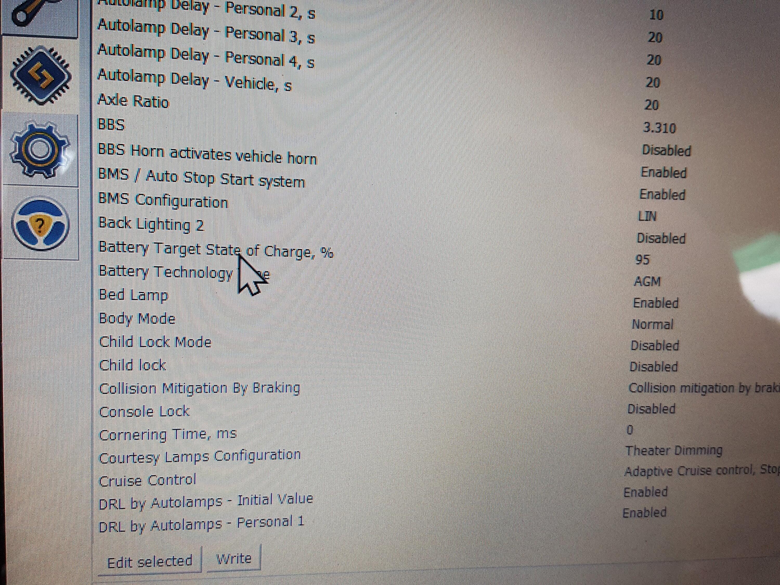

Hi all
All of the issues described in this thread I've experienced with my 2021. Last December my SOC must have been very low without my understanding of all of this, and in retrospect I now think that this is part of the reason that my truck failed to complete the now infamous 1.7.1 OTA lock out.
In May of 22 my battery completely died after a 1 hour trip to my mother in laws house and being parked for only 4 hours, couldn't get home without a jump start from my laughing brother in laws old Chevy!
The dealership replaced the battery with another H6 the next day.
In August as a proactive move I replaced the battery with the larger H7 and adjusted the SOC setting to 90% in forscan.
On the 7th of December the SOC fell below 70% this is immediately realized because auto start stop discontinues to function. And at 60% the interior lighting stops working. So I fully charged the truck with my agm charger for 8 hours back to 100%
After last weekend's super cold spell -14 the truck just barely started after being parked for 3 days, I checked the soc and it was at 57% there is definitely something wrong with the charging system strategies that Ford has implemented with ice engine trucks. In my opinion.
In an effort to try to understand what's going I've started logging every trip I make to gain an understanding of what's going on. I intend to do this for a week or to and then compile the data to try to find a trend as to when the battery is loosing its charge. When I complete this I will post my findings. Attached or the things I'm monitoring and notating for my eventual report
