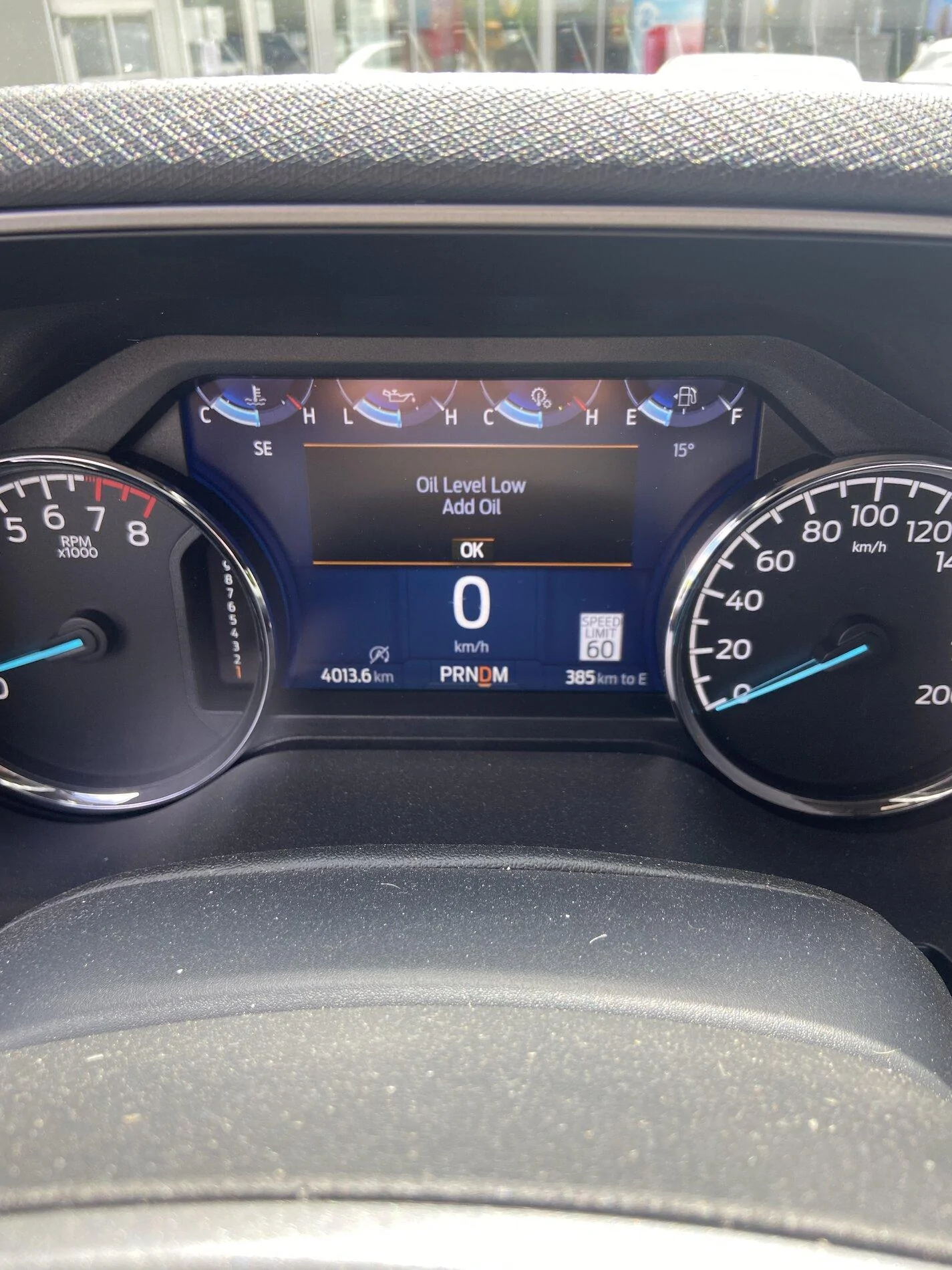

Ok, went to the dealer after second oil light warning at 4000km. They changed oil/filter and have requested I return so they can check levels every 320km until I burn another litre.. It’s an “oil consumption test”.
I live 154 km from dealer, so can only drive to dealer then home again for 320km interval, repeat 6 times to confirm 1 litre burn. Frustrating waste of time and money since they get FordPass notification of prior two oil light warnings.
