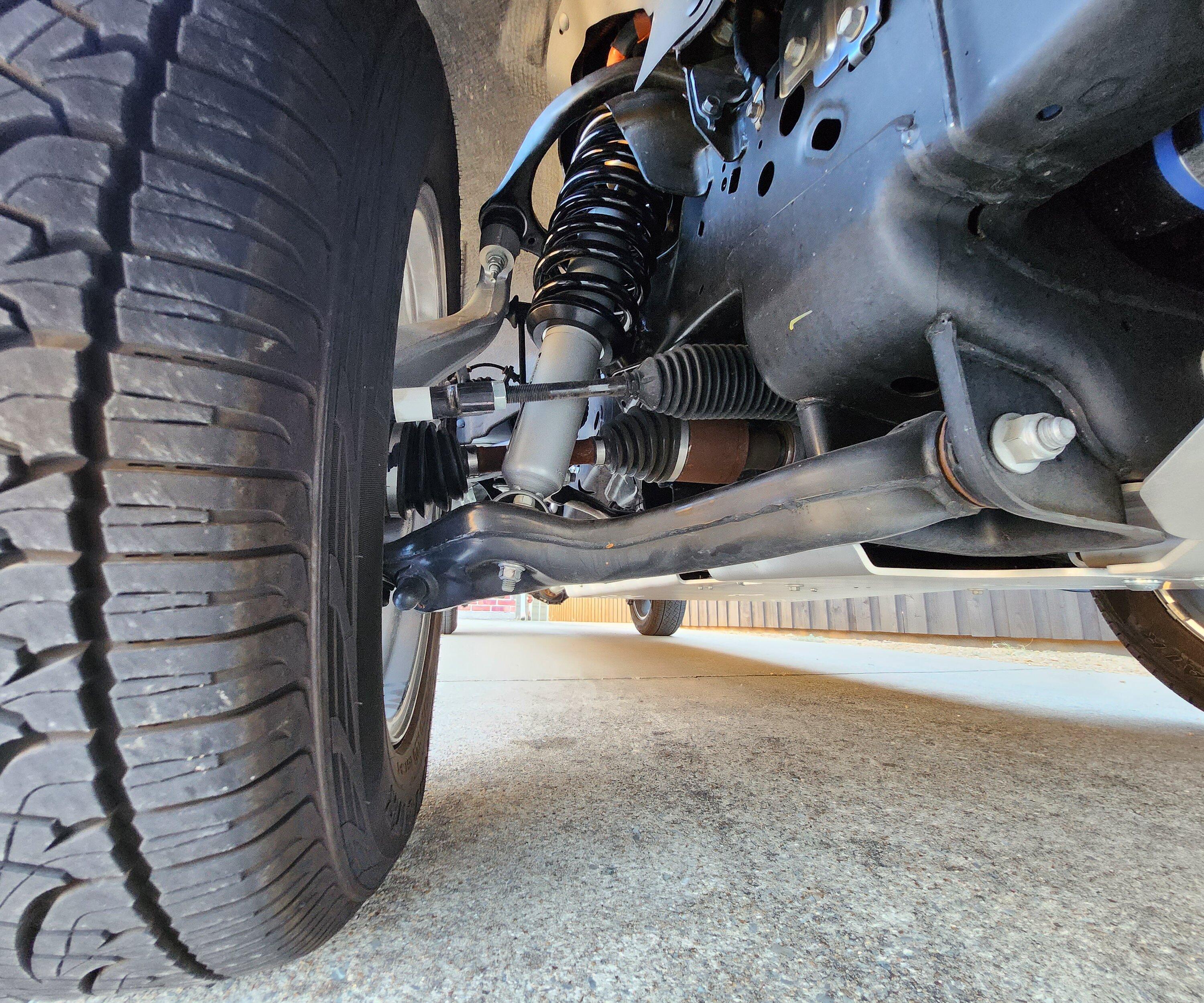

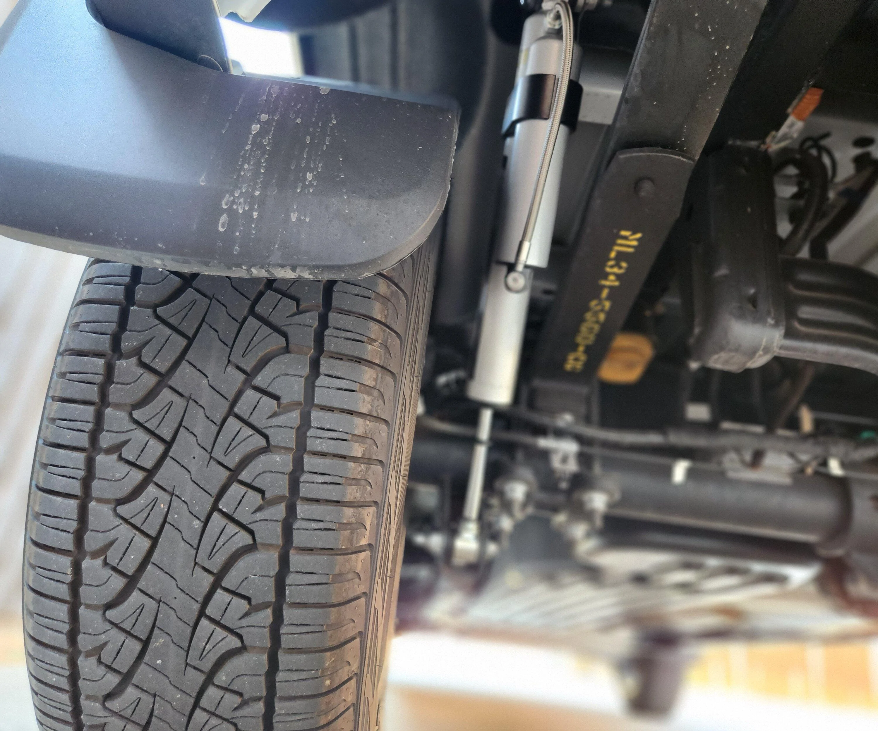

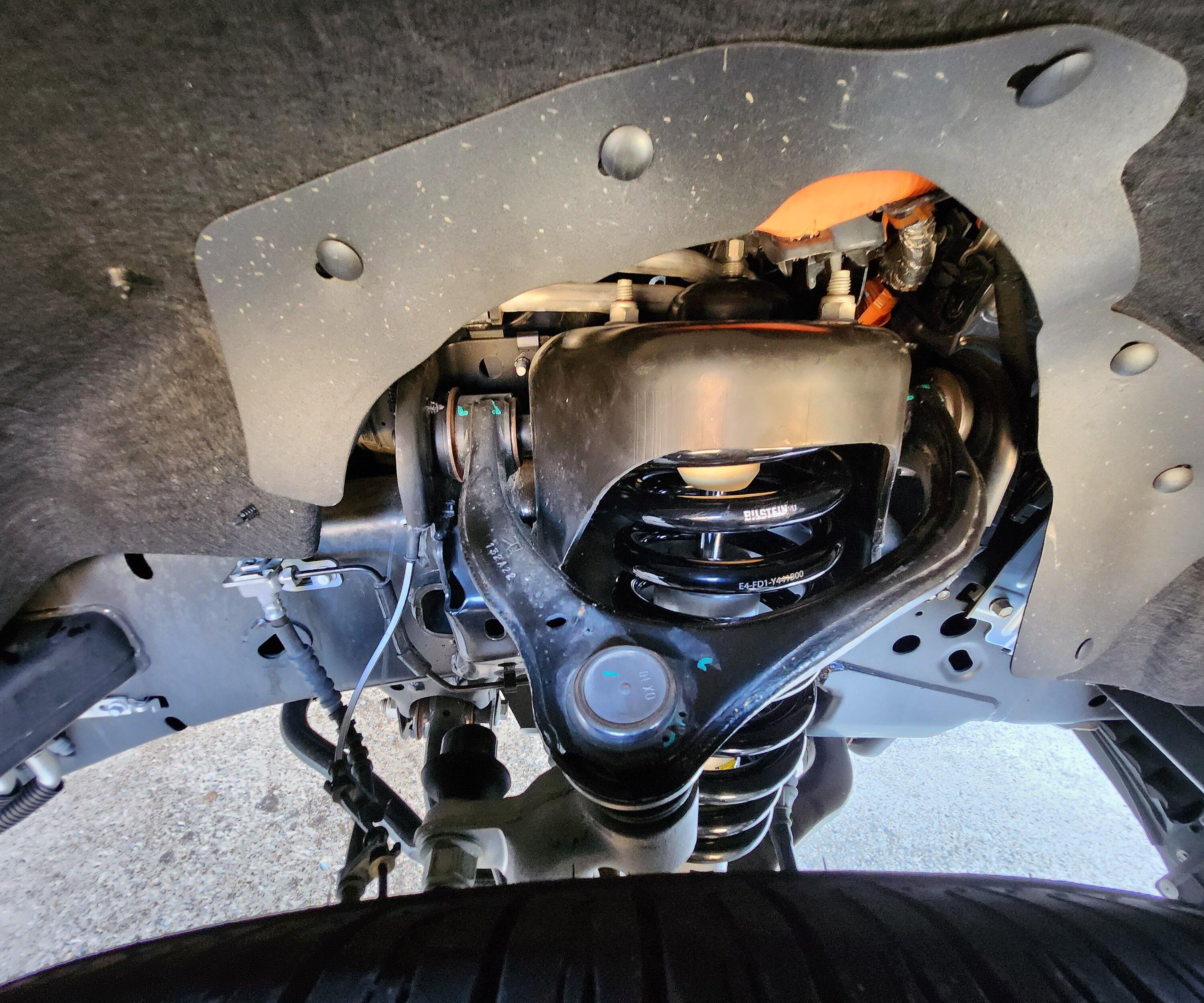

got the local tech to install the kit. ride is immediately better. boat feeling is gone. i had some doubts but now iam a believer
