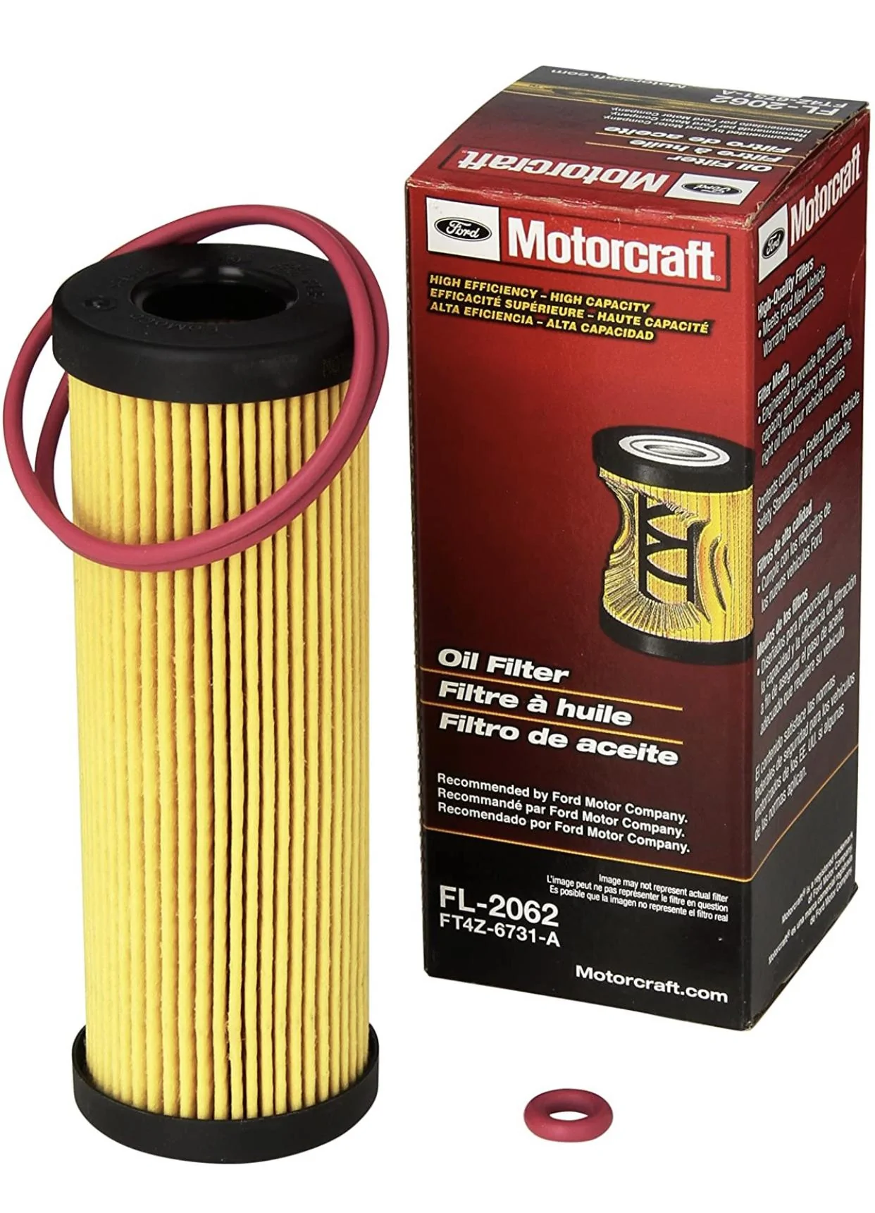

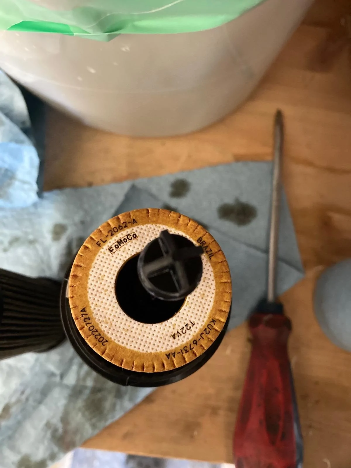

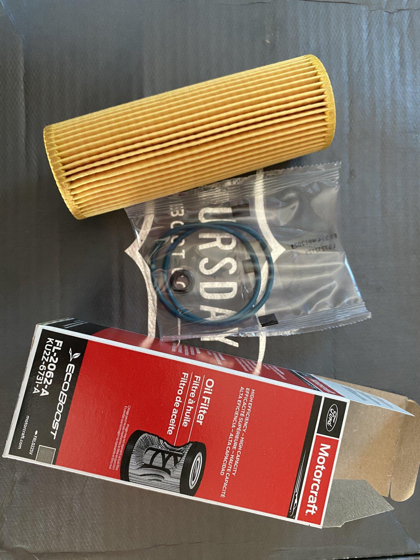

So I ordered 3 oil filters and performed my first oil change with Motorcraft FL-2062 filters. The one that came out of the engine had rubber caps on both ends. The one in the picture had the rubber caps. But, the 3 I received did not have the rubber caps. The original and the ones I bought have the same length and diameter of the old. Is this correct that they will not have the rubber caps?
I think I’m good on this. I just found a thread on another forum about this same issue. https://www.fordedgeforum.com/topic/29113-new-motorcraft-oil-filter-fl-2062-a-vs-the-fl-2062/

The -A removed the stuff Ford decided the filter doesn't need. I just did my oil change Monday.
