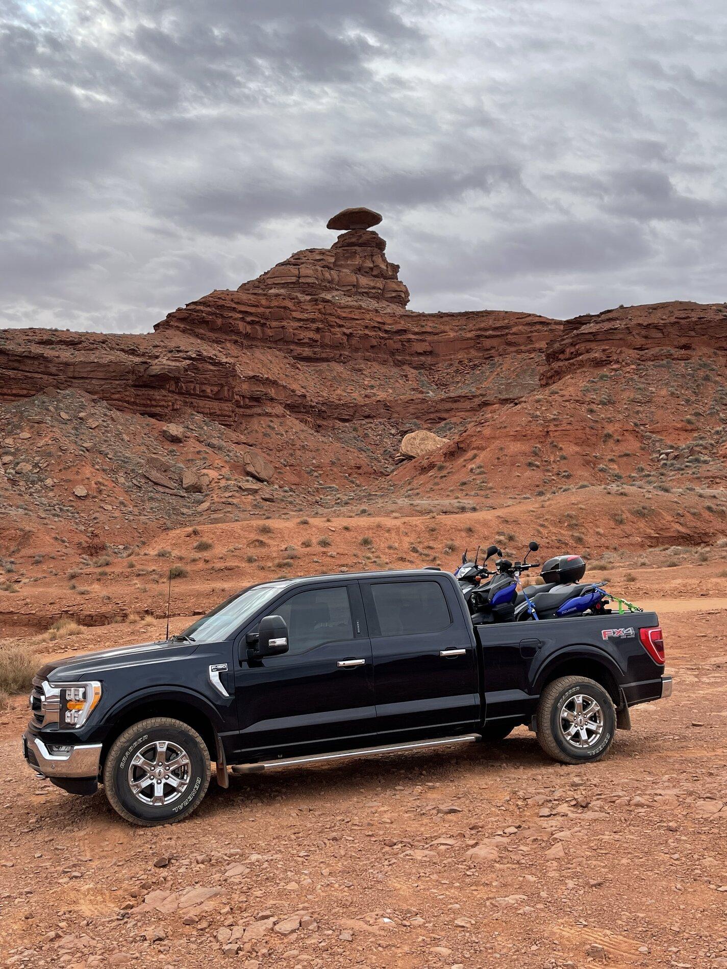

We do a lot of traveling and are sometimes out of reach of cell service so a stand alone gps has come in handy. I actually run both Waze and GPS when traveling, as each one has both offered better routes.
I thought about requesting a rental for our 5k mile trip as not having my 360 cameras makes it more challenging, but my add-on accesories(ramps, tinted windows, tie down points, etc) are nice especially traveling with 2 scooters in the back.
