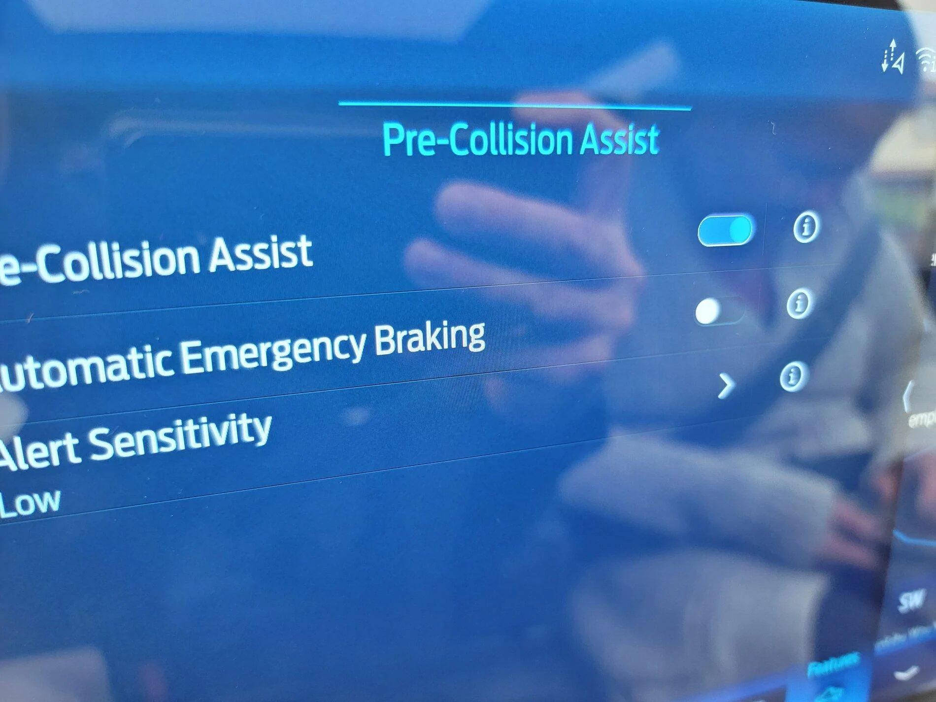

must be a fault because i have it turned on but the light to say its off is on

SO the one below is Automatic Emergency Braking and it is off, might it be that one? Turn it on and see if the light goes away. I am not sure so I am just guessing.
Seems to have worked for now, fingers crossed

Ok, so I just went out to my son's truck and turned the Automatic Emergency Braking System on and off several times and that light came on and went off accordingly so I now KNOW what it is and that is it.
