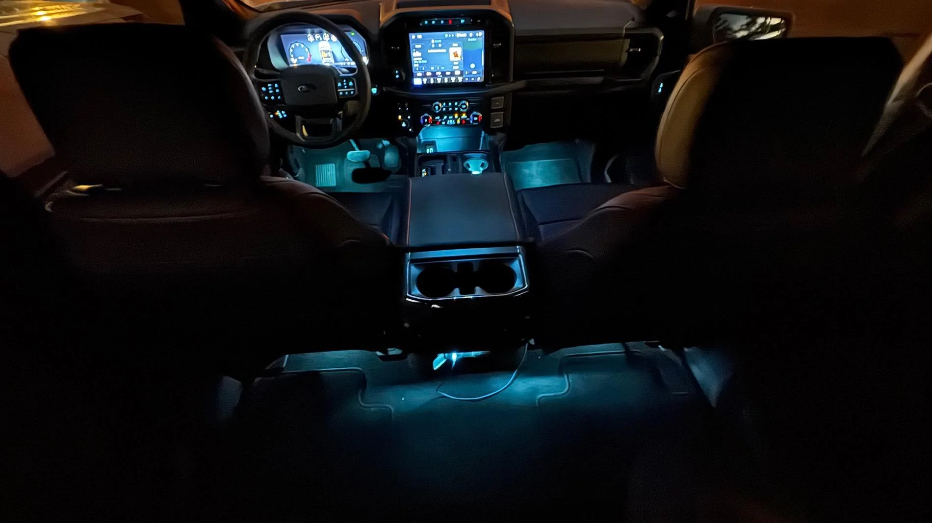

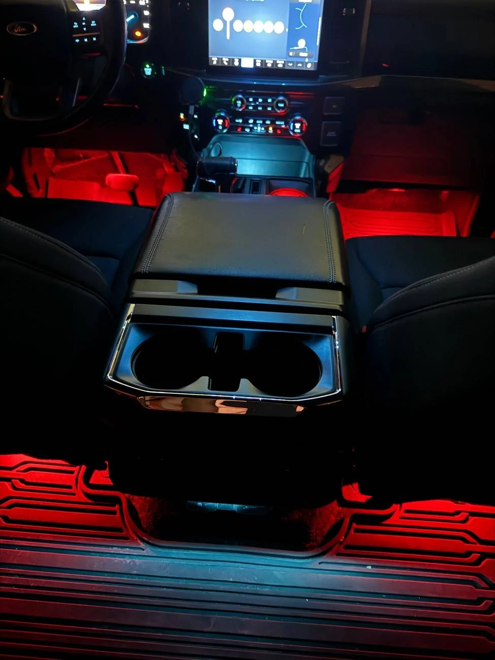

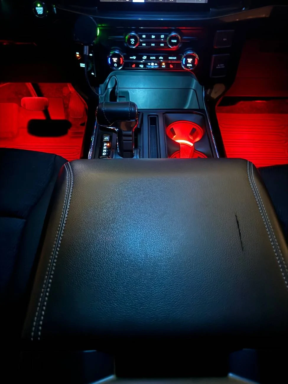

Completed this tonight. Was pretty straight forward with the exception of a Ford issue that caused a short to ground. Big thanks to @JHForman812 for the harness and the tech support. Even though I had the factory wiring ended up with the full harness set because of the short. Harness made the whole thing pretty easy. Works great, looks great.
2021 XLT Super Crew 2.7L 302A
Ford F-150 XLT trucks with push button start cup holder/ambient lighting IMG_4329
Ford F-150 XLT trucks with push button start cup holder/ambient lighting IMG_4328
Ford F-150 XLT trucks with push button start cup holder/ambient lighting IMG_4327
Ford F-150 XLT trucks with push button start cup holder/ambient lighting IMG_4326

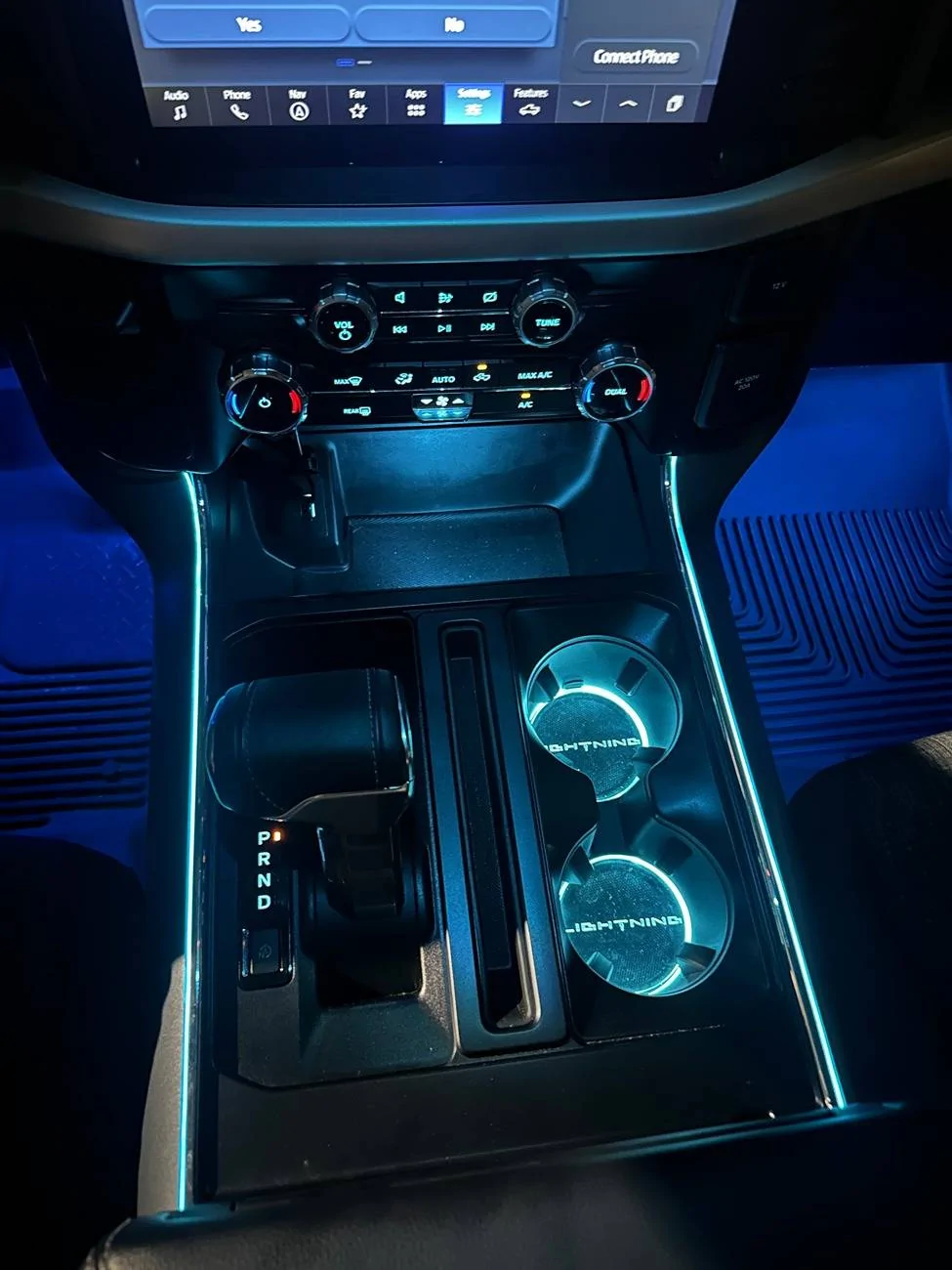

Completed this today on my 2022 Lightning XLT. Big thanks to @JHForman812 and @b bo
Had some trouble getting the connections on the BCM hooked up. @b bo had some great photos on page 7 of this thread showing where to do it. I didn't insert them all the way the first time. I found its easy to use some needlenose pliers when inserting them.
Installed Media bin, cupholders and glove box light. Took me about 8 hours but I'm happy with the final result. Thanks again to @JHForman812 for the harnesses and being available to help me troubleshoot lol.
Strip lights on either side of console
Acrylic Cupholder Inserts
