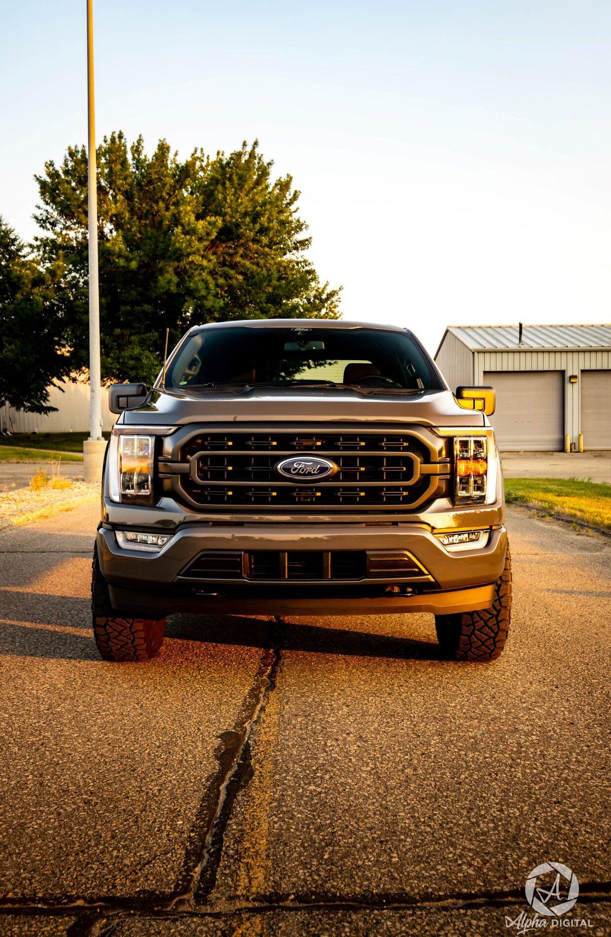

I'd like to ask for your opinion, do you think 315/70/17s with +1 offset , will fit with a 2.5" lift without any rubbing?
Or should i just go same route and put 285/75/17s?
I really want 315s to work, will put SPC UCA also.

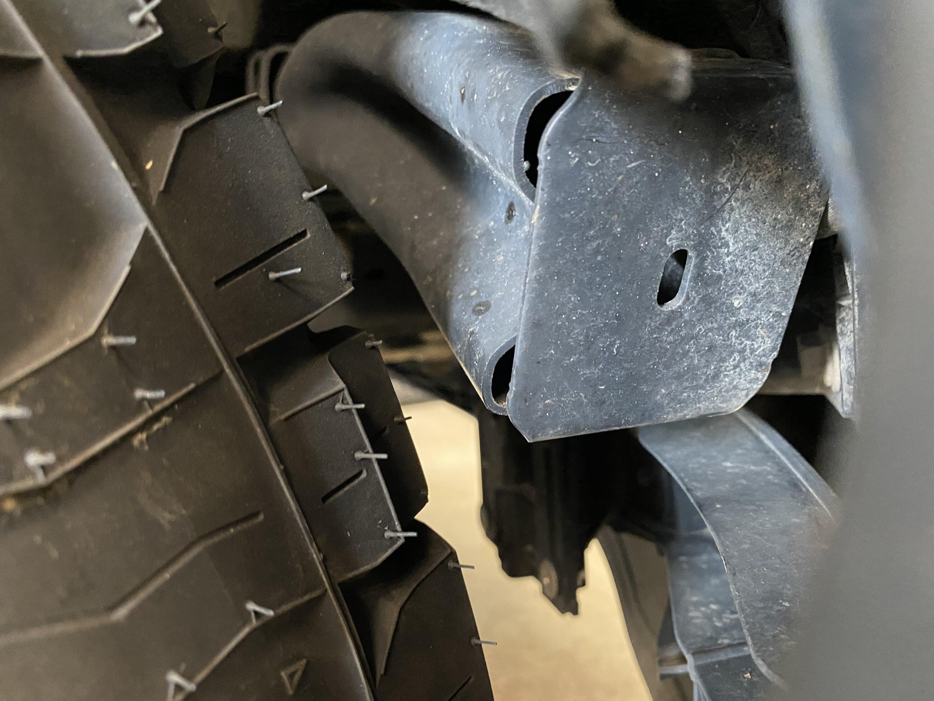

No, I can almost 100% say they will not fit with a 2.5" without any rubbing. So I actually just sold the 285/75/17s and bought a new set of 18x9 +18 Method 305 NV and threw on some 35x12.50 Toyo Open Country ATIII tires.
I can confirm that with a +18 offset they clear the crash bars by about 1/2 an inch or less.
I couldn't even get a finger in there. They were rubbing on the air dam.
I didn't want to cut the crash bars so I used a PortaPower to push them out. This worked awesome and I was able to gain a good 3/4 inch of clearance front and back. Now even at full articulation I have the same clearance as I had before with no articulation of the suspension.

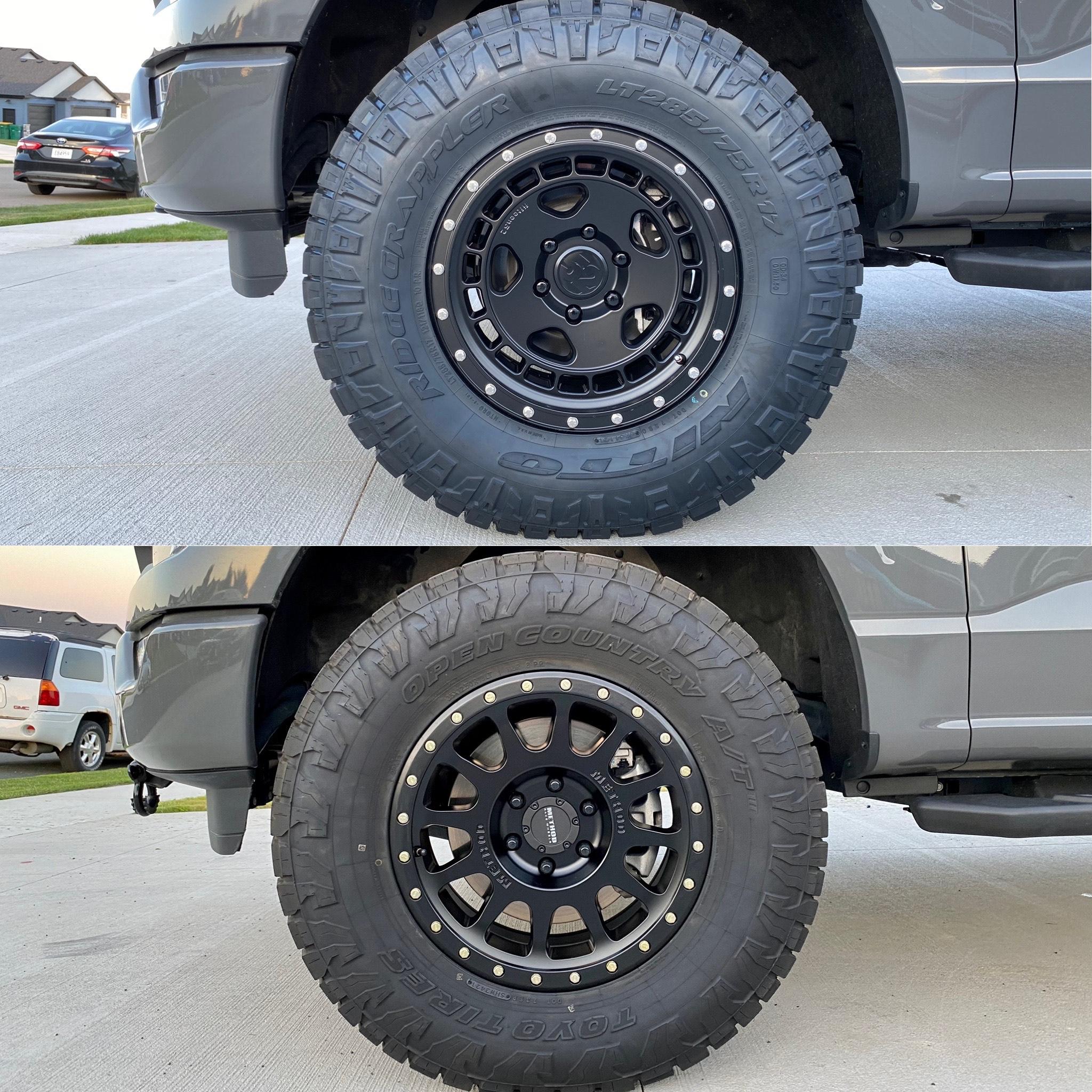

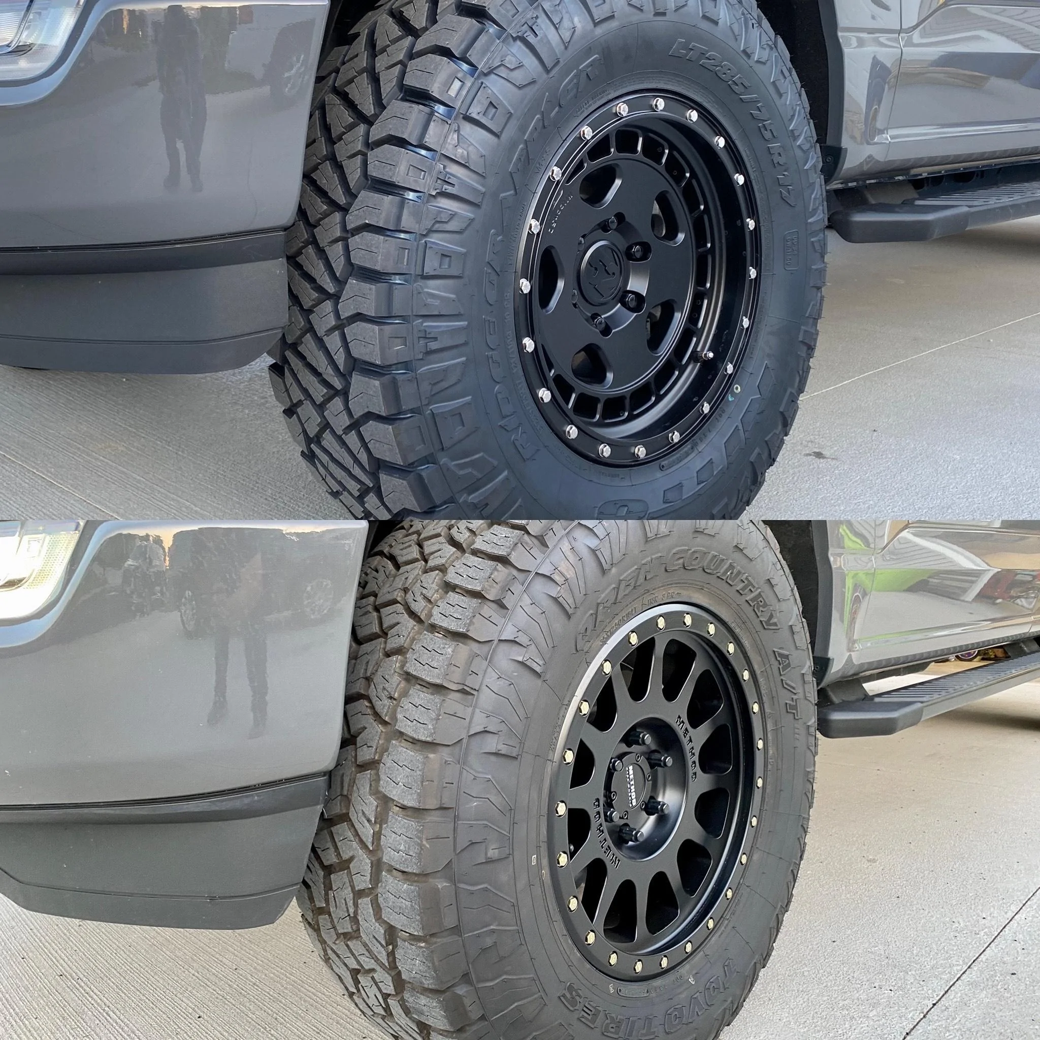

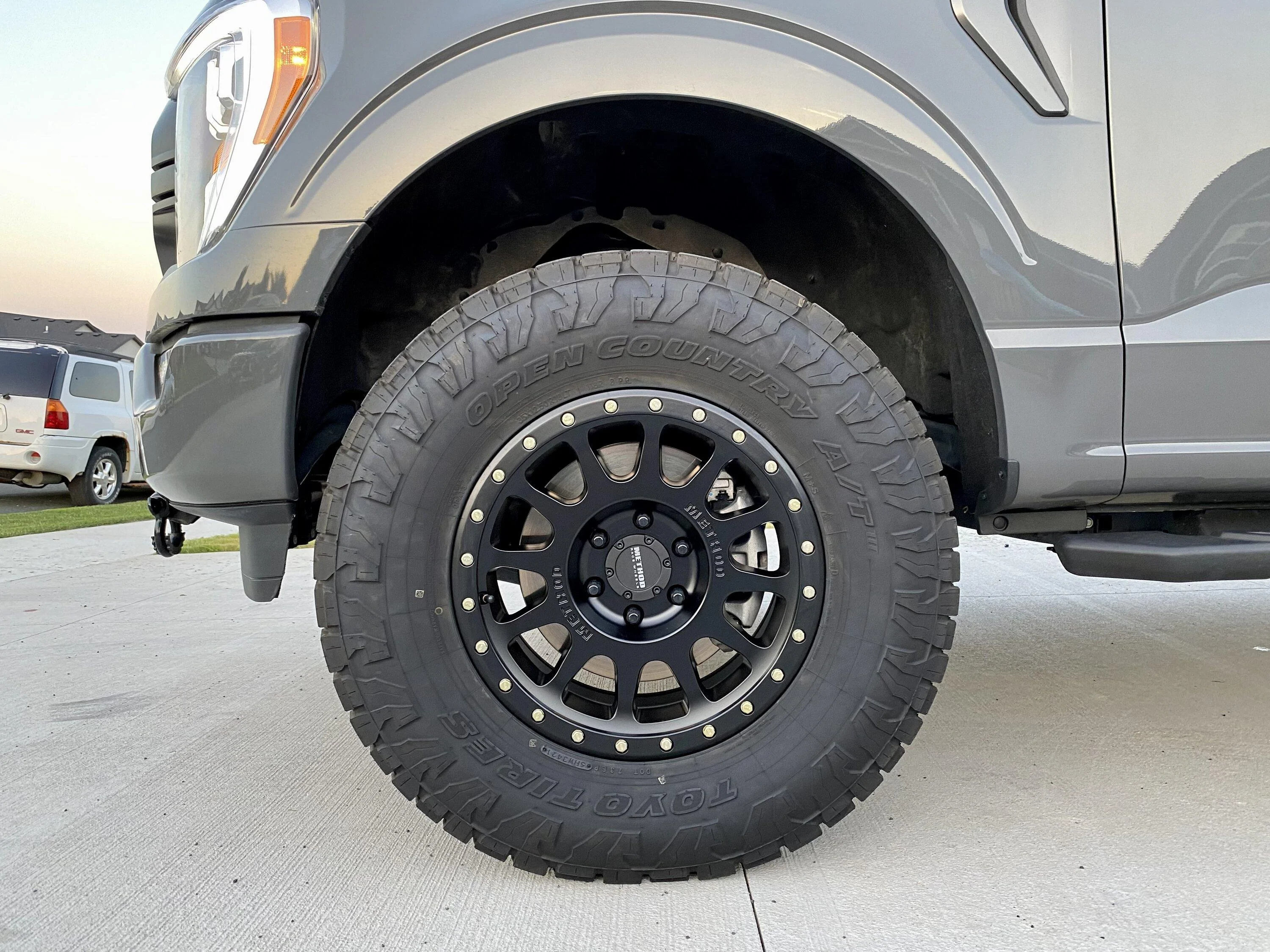

Correct, I squeezed in 35/12.50R18s on a 2.5" level by going with a +18 offset. So these wheels still have 1.5 inches more poke that the factory +44 wheels.
With an offset close to zero you are going to rub pretty much everywhere; air dam, inner fender liner between the air dam and crash bars, and the crash bars themselves. That extra 3/4 inch of poke drastically increases the swing of the tire. To run a zero offset with 315/70/17s you are going to need a bigger lift, and will still have to do some trimming/cutting.
I'm glad I went the route I did with the +18 offset and the 1/2" wider wheel and 1" wider and taller tire. It still has a substantial stance that is VERY close to what the zero offset wheels on 34's looked like.
I'll post a few comparison pics.

There are a few videos on Youtube on how to push the crash bars out with a PortaPower. It's easiest with two people. I removed the wheel and then I sat in the wheel well holding it in place while another person pumped/extended it.
I placed the ends roughly 1.5-2" from the end of the crash bars and then pressed them out until I had an extra 2.5" inches of clearance or so. Once you release the pressure the crash bars will retract a bit so I ended up with roughly 2 extra inches of clearance, or 1 inch in front & 1 inch in back.
I did not loosen the bars. You want them tight so they bend when you press them out so loosening them would not be helpful. I might be able to get another 1/2" of clearance if I pressed some more but there is a wire in front of the passenger side for the fog lights that I didn't want to pinch and still wanted clearance to perform maintenance if needed.
I tested the clearances by backing into a ditch at full lock. I had the truck teeter-totting so I know I had maximum articulation of the suspension and I still had a good 1/2 inch of clearance. Maybe if I hit full articulation at full lock with some speed it would contact, but usually you're moving pretty slow while off-roading so I think I would likely have bigger problems if I were able to get it to make contact.

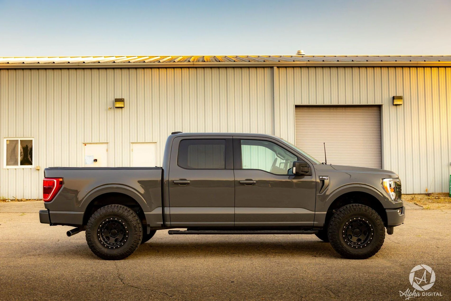

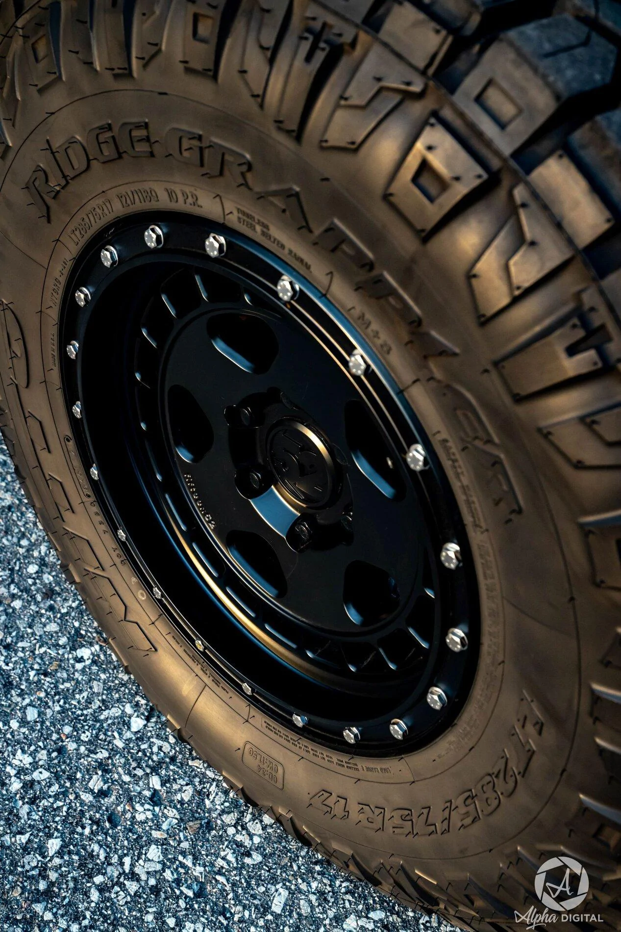

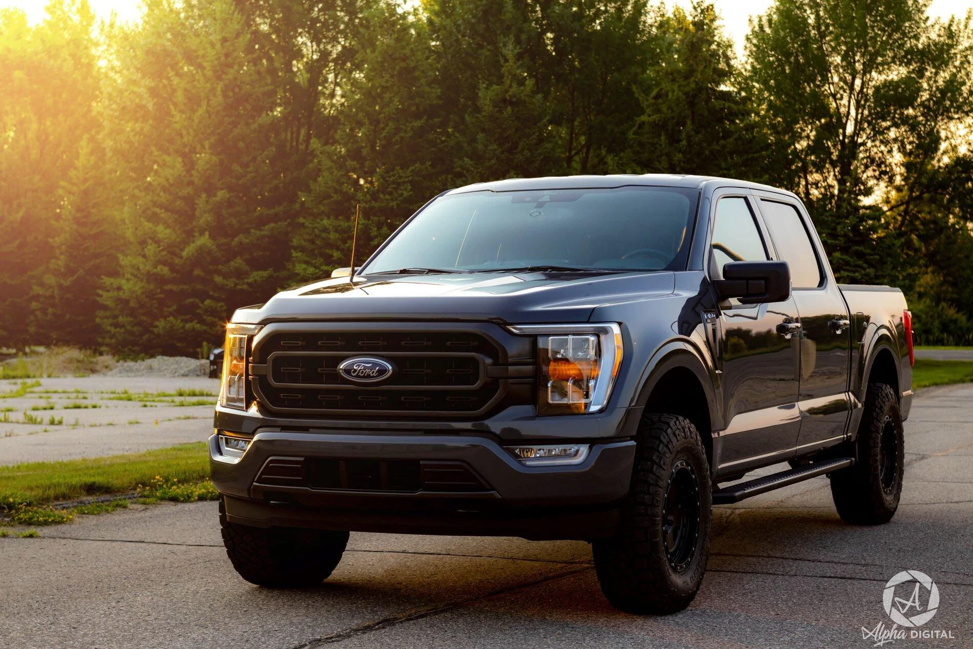

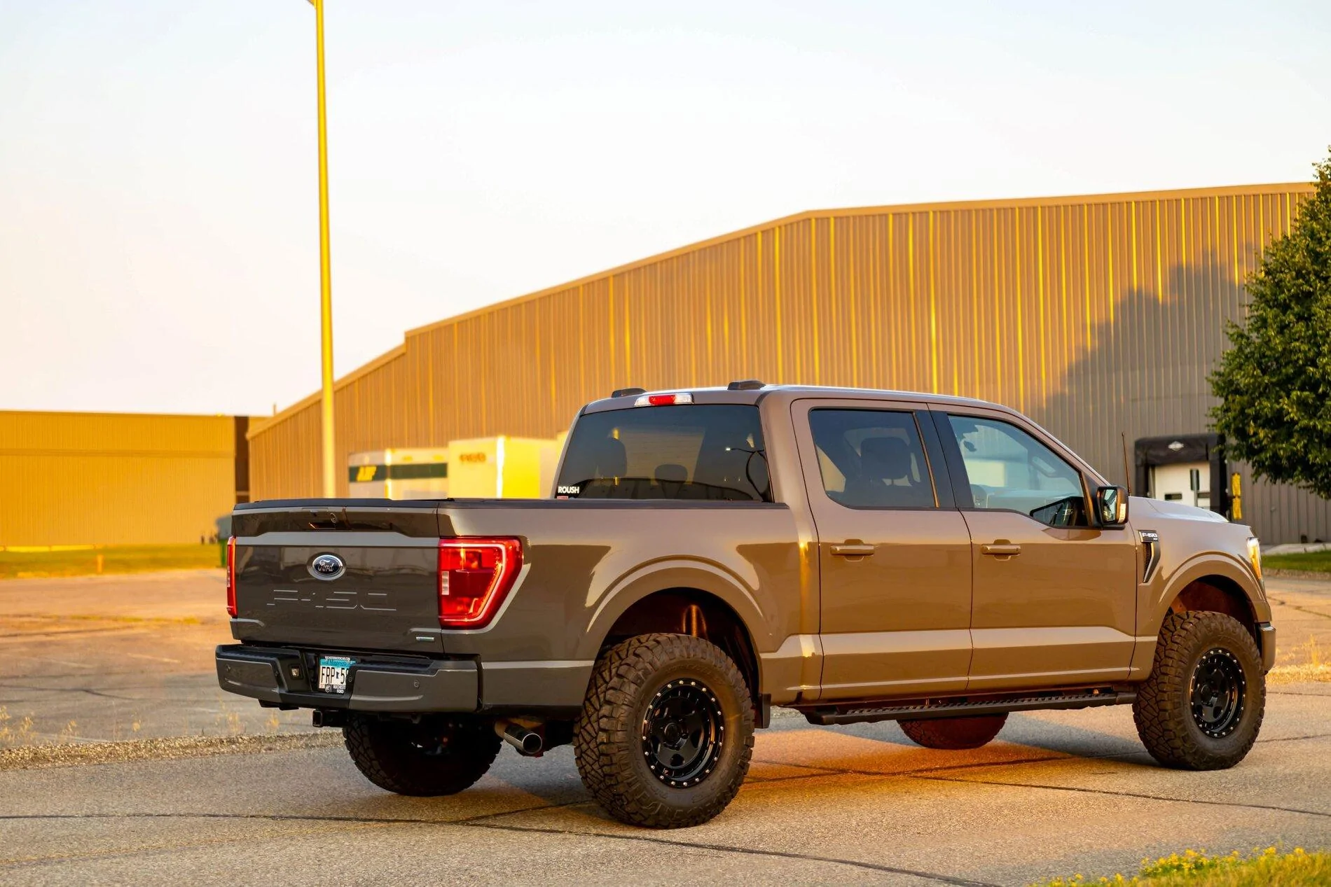

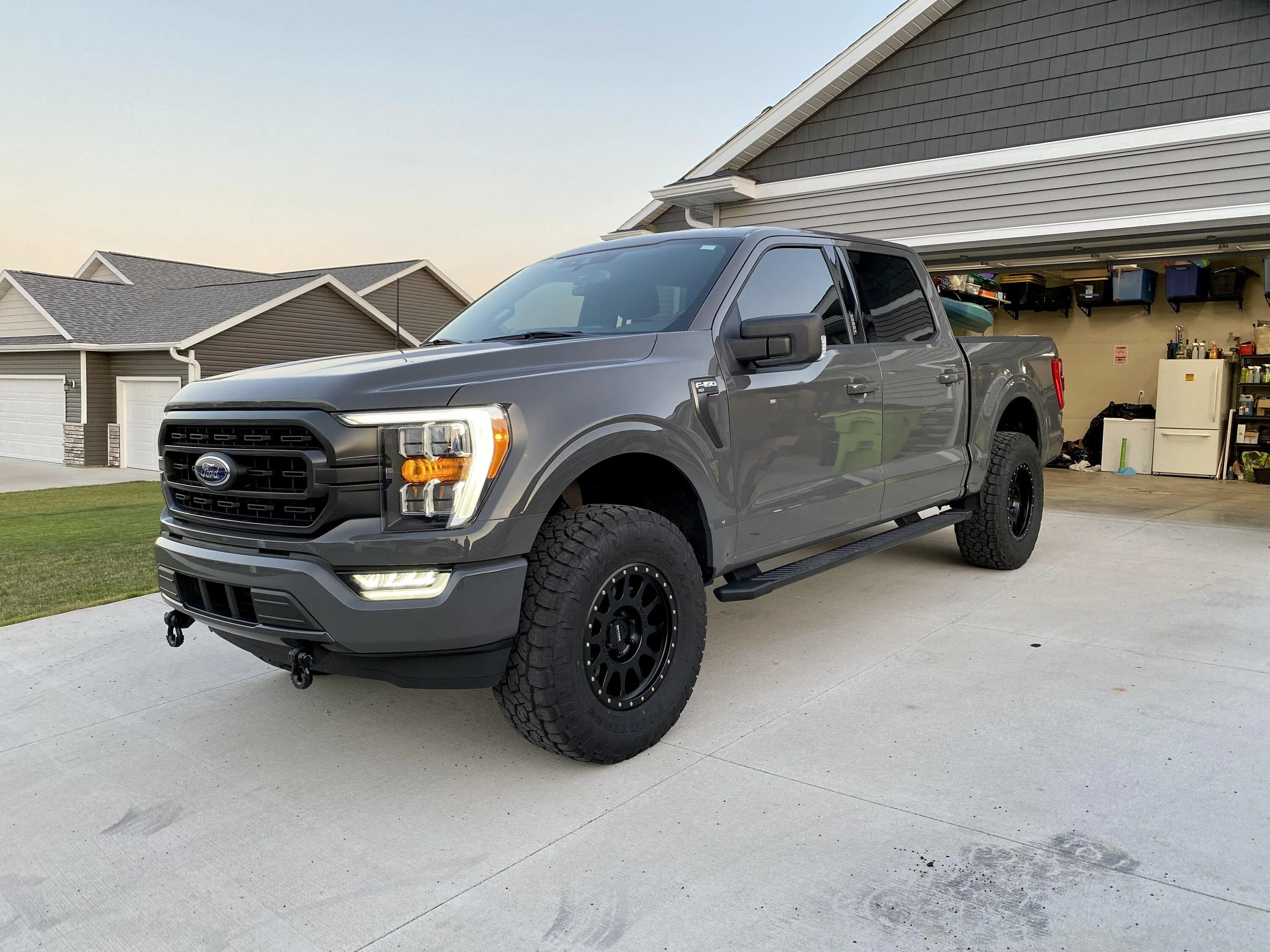

Hey everyone,
I finally feel like I have a truck worthy of posting in the Show and Tell section! Though I can’t really call it a “build”. Just a level and wheels & tires. Still, it’s looking pretty good and I’m excited. So without further a do...
Mods:
  • Removed Sport 4x4 sticker
  • RhinoPro Spray in bed liner
  • Armorflex Tonneau Cover
  • OEM Box Links Bed Divider
  • Roush Cold Air Intake
  • Husky Wheel Well Liners
  • Rydonair 13" Antenna
  • Supreme Suspensions 2.5” Leveling Kit
  • 17x8.5” ET0 Fifteen52 Turbomac HD wheels
  • 285/75R17 Nitto Ridge Grappler Load E Tires

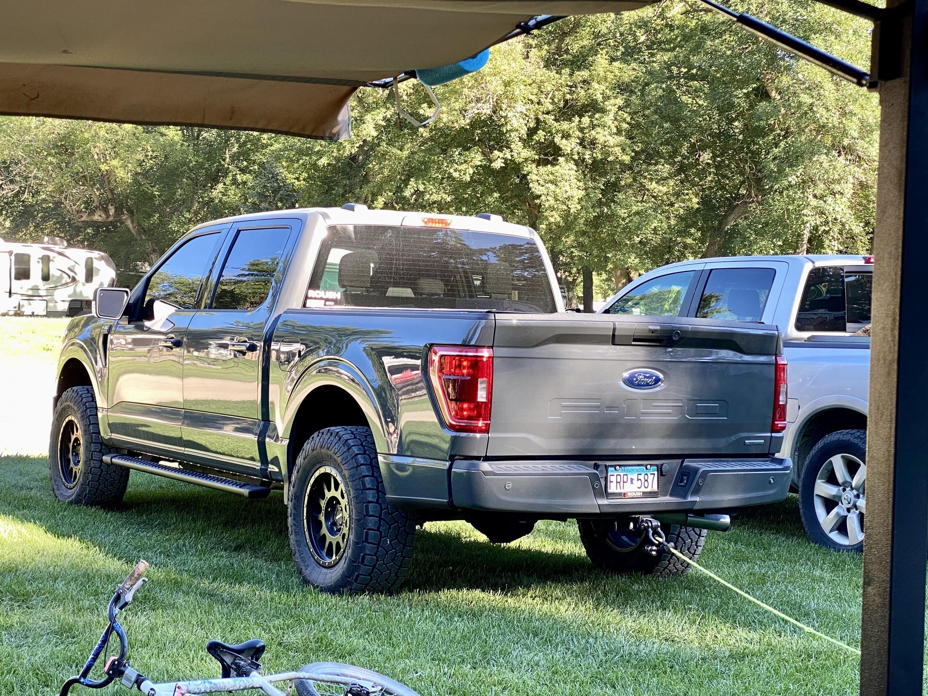

Stock could certainly use a little bit more tire -- always torn between looks and drivability. Perhaps there's a good 34" that'd preserve the caddy ride while also providing a wee bit more tire. Need a tire rental system -- Hard to justify dropping $2k on new shoes without first knowing how bad the ride will suffer.
I can honestly say these 35x12.50 Toyo ATIII ride way better than the 34x11.50 Ridge Grapplers I had. They are an 8 ply load D tire though vs the 10 ply load E Ridge Grapplers. So I guess my suggestion if you want a more compliant ride is to go with a lower load range / less ply tire. These Toyo's still have a higher load rating than the factory tires so no issues with towing or hauling. The E load tires just aren't necessary for a 1/2 ton truck.
I am really loving this setup currently. The truck rides better and well the looks speak for themselves! MPG's may have gone down a bit though, but who the heck cares about MPG's anyways?
