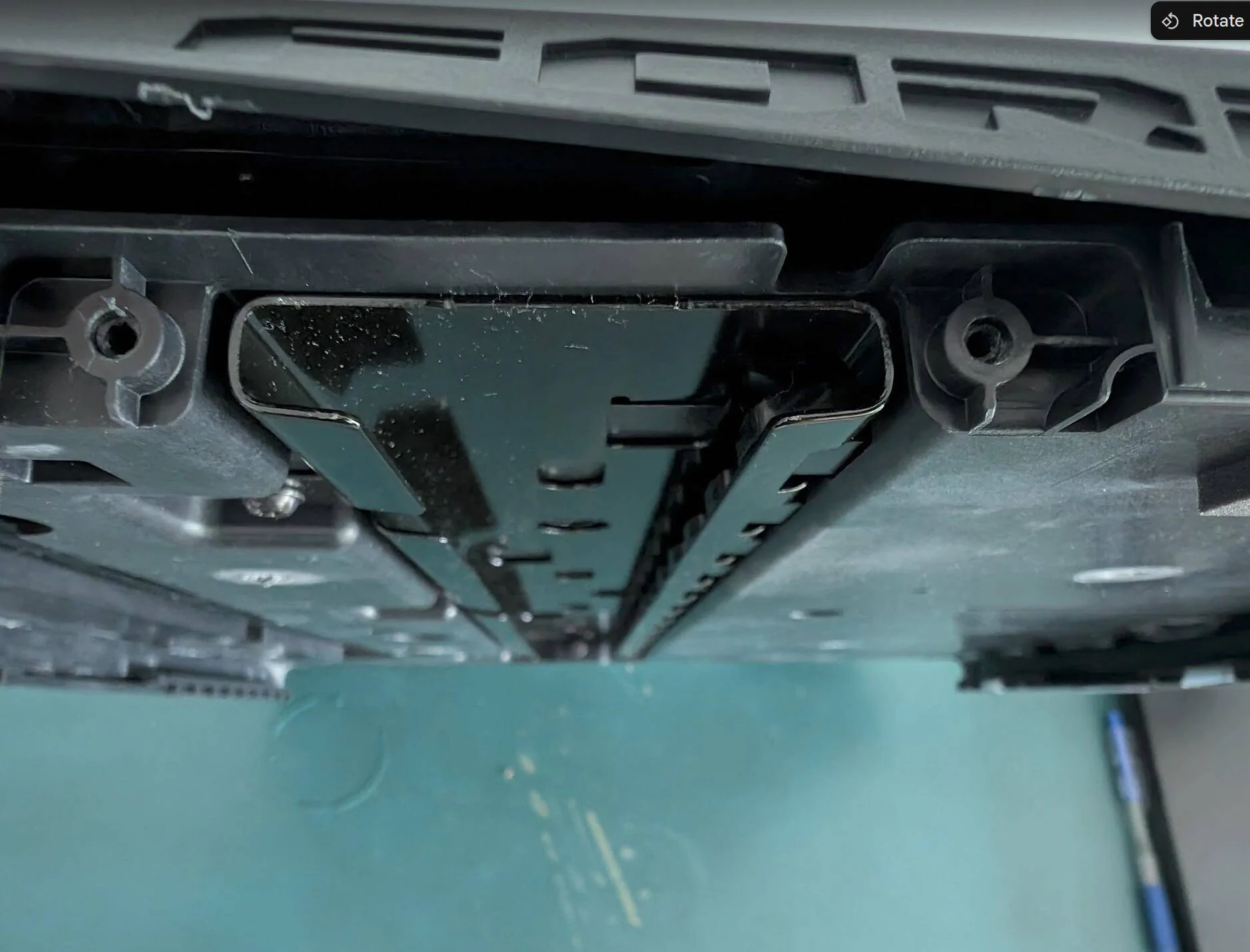

The rail underneath the work surface:

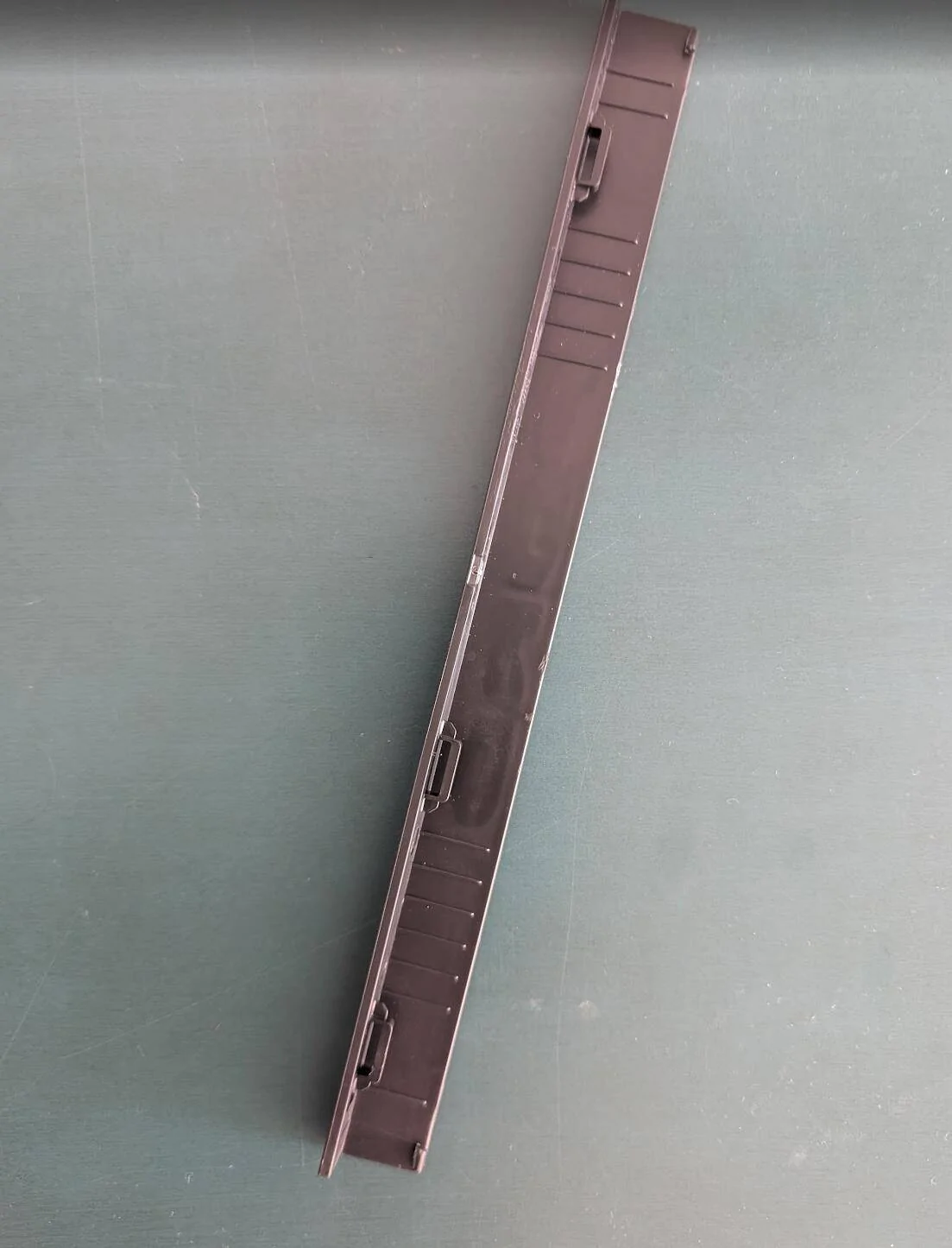

The piece that pops off for reference:
Ford F-150 XL Work Surface Wide Swing Mod iKFVjez

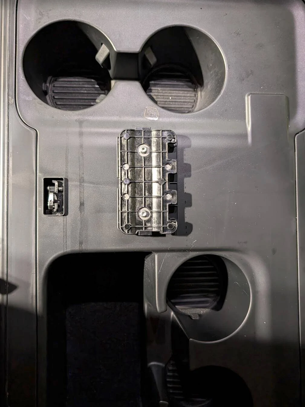

How the rail mates to the cupholder/storage part:
Ford F-150 XL Work Surface Wide Swing Mod PBqfiuB

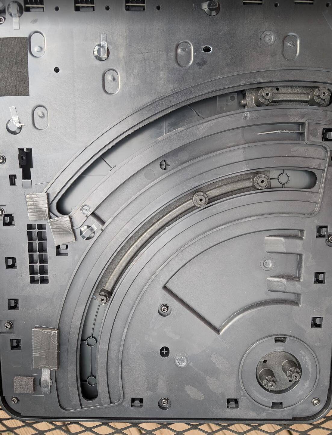

With the top off and turned upside down, you can see 7 more T20 screws that hold the top swinging part to the bottom sliding part. I've colored them red in the pic.
Ford F-150 XL Work Surface Wide Swing Mod xhtSzF8
After you remove that, you can see there is an anchor and two sliding tracks. The top one has an additional piece they added across that prevents the top from swinging very far. All you have to do is remove that piece with a Dremel.
Ford F-150 XL Work Surface Wide Swing Mod IepHx7i
Here it is removed:
Ford F-150 XL Work Surface Wide Swing Mod BIyWFnZ
