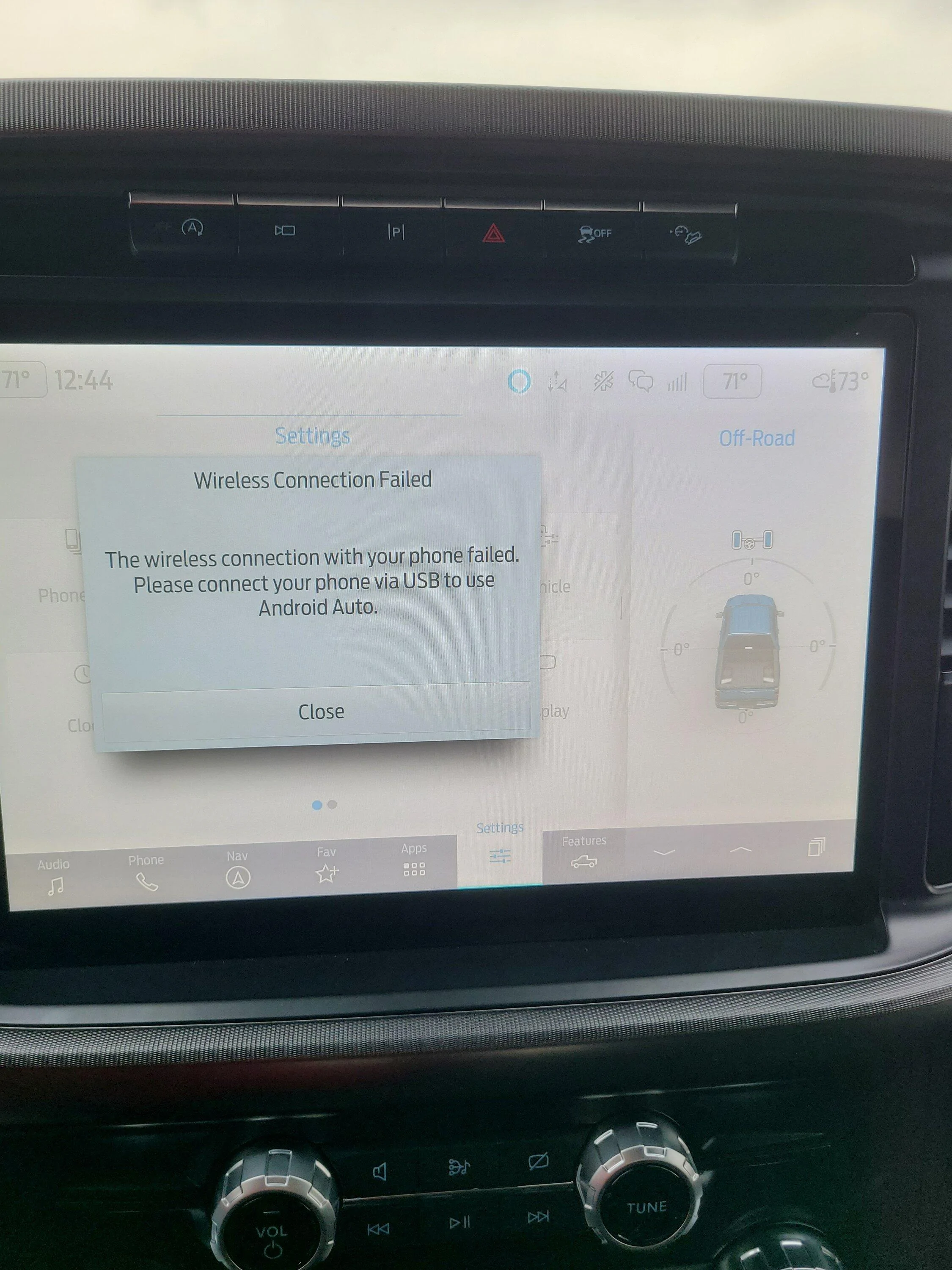

I'm getting the same Wireless Connection Failed message on Android Auto. It's happened multiple times since I got my truck new last week. Does anyone have a fix for this?
