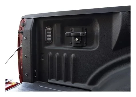

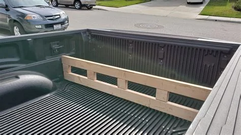

Unless you have the AC power outlets, there are ribbed pockets to slide 2X lumber into as dividers, which should hold a few sandbags as long as they are snug.
Here are some pictures that I found with a quick search:
Ford F-150 Winter driving and adding weight in the bed of a 4x4 pickup? 93039A9A-06A7-48C4-8A69-87F8FF4D5576
Ford F-150 Winter driving and adding weight in the bed of a 4x4 pickup? C2834DDD-2B75-41F4-AD07-F07A191606A0

Nice setup there, thank you! Unfortunately, I do have the outlets back there (pro power on board) which I use quite often and I also have a swing out bin on one side that has some random tools in it and such, so my back end is already quite busy. A wood frame may not work so well in my case.
Is there any other way to have a few sandbags stay put, more or less, back there?
Pedaldude
Jan 27, 2021
1,480
2,005
Arizona
There should be enough clearance under the swing out storage to place a piece of 1/4" plywood, cut it to size to wedge it between the bed sides and behind the wheel wells and ratchet strap your sand bags to it. Several coats of epoxy paint should keep it from warping.
