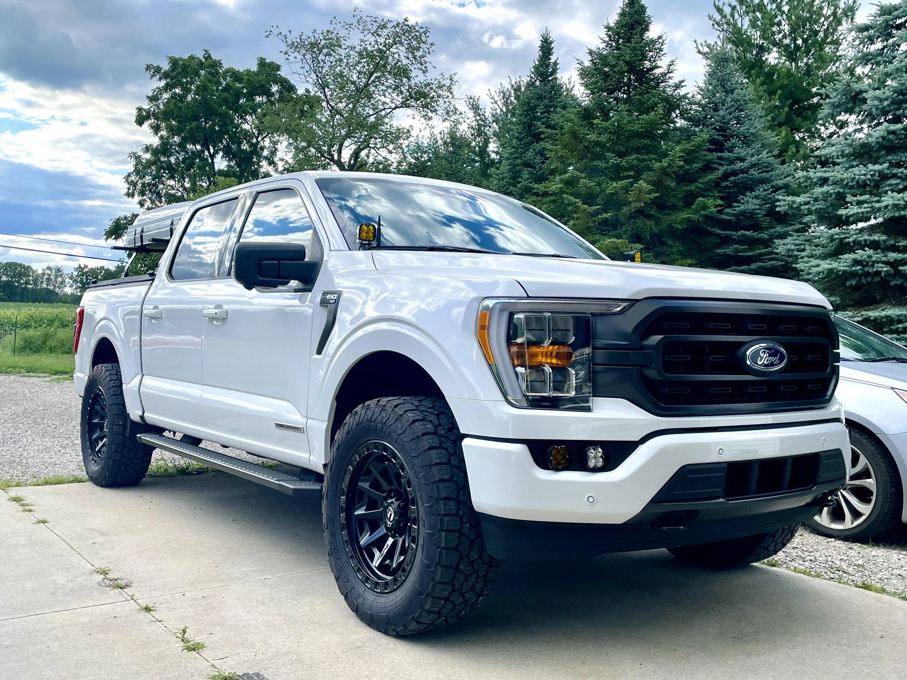

Stock, I thought the ride was soft. With the lift, it rides like a truck. I like it and wouldn’t change it back.
