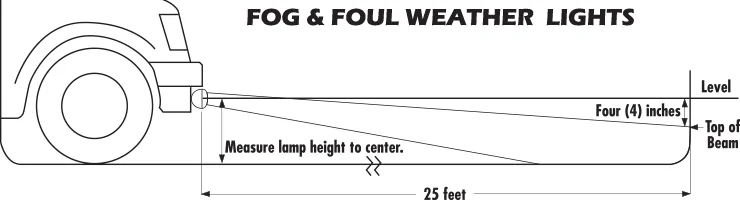

if you re-align your fog lights to where they should be it will make a world of a difference, every build I have seen the fogs have been pointed straight into the ground in front of the vehicle
led’s are better, but too rich for my blood to go up to 302A!

I’ll give that a try. I have LED fog lights. Super bright. Didn’t know I could use them that way without blinding on coming traffic. Worth a shot though.

Ahh yeah they both adjust pretty similarly there’s a bolt you can turn when you look behind that felt fender piece. If I remember correctly I turned mine 4 full turns to get it into being something like this

I complained to the dealer about them, and they aligned the fog lights under warranty.
