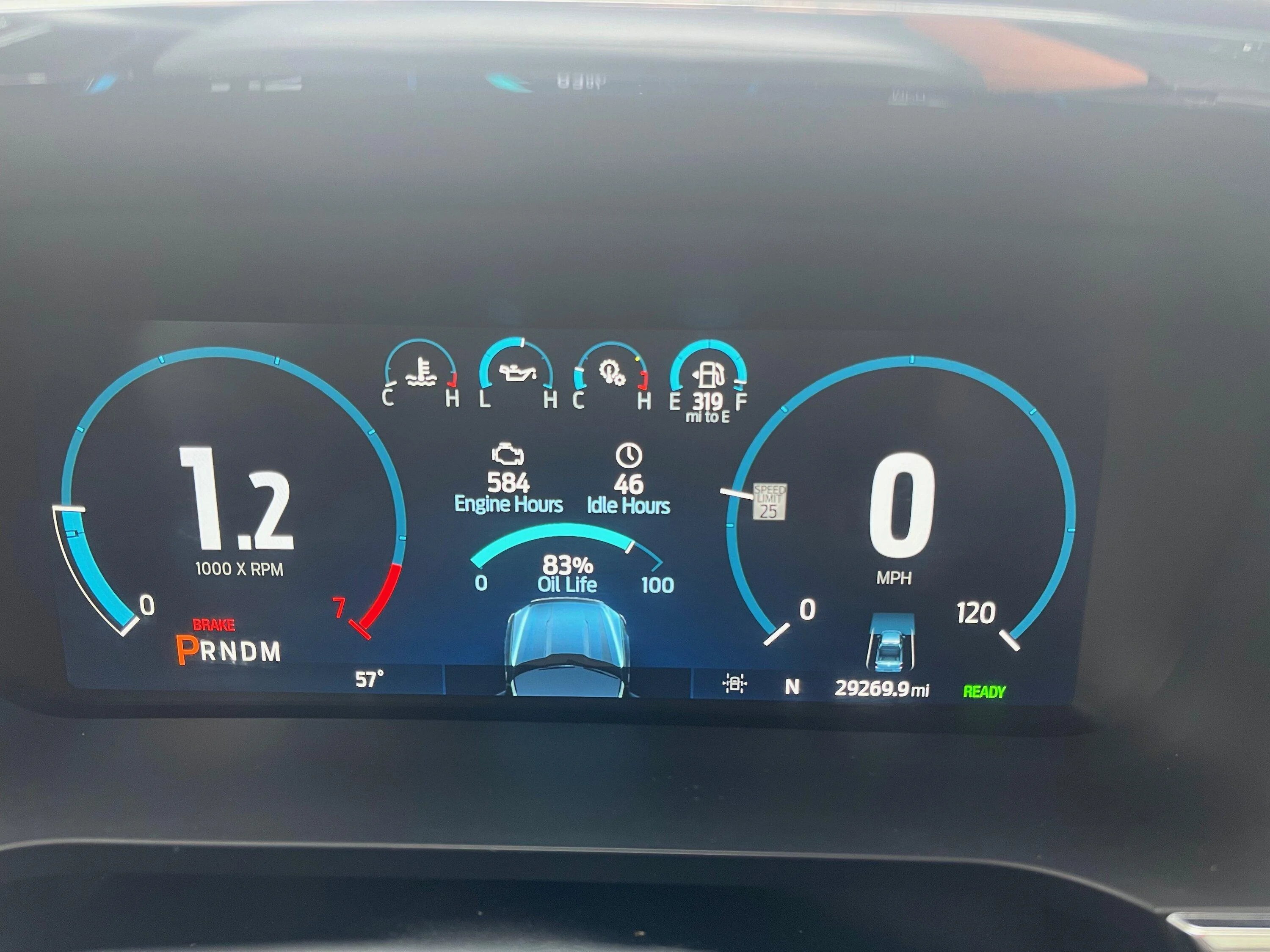

Thanks for the suggestions. It shows 584 engine hours and 46 idle hours. This makes me even more confused. How can Trip 1 show 1,281+ hours but the truck engine time only accounts for 630 hours? Based on the trucks mileage and engine hours it has averaged ~50 mph for its life, which seems reasonable assuming mostly freeway driving. Conversely Trip 1 implies an average of 7 mph. Assuming the truck was idled for a long time during Trip 1 that could explain the numbers, but the total idle hours is only 46, which isn't enough to explain the numbers. Can engine hours and idle hours be reset? Am I crazy? ?

Based on the manual, engine hours is only counting time the engine was on and the truck in park or neutral, so idle time only.
Then what is the difference between engine hours and idle hours?
