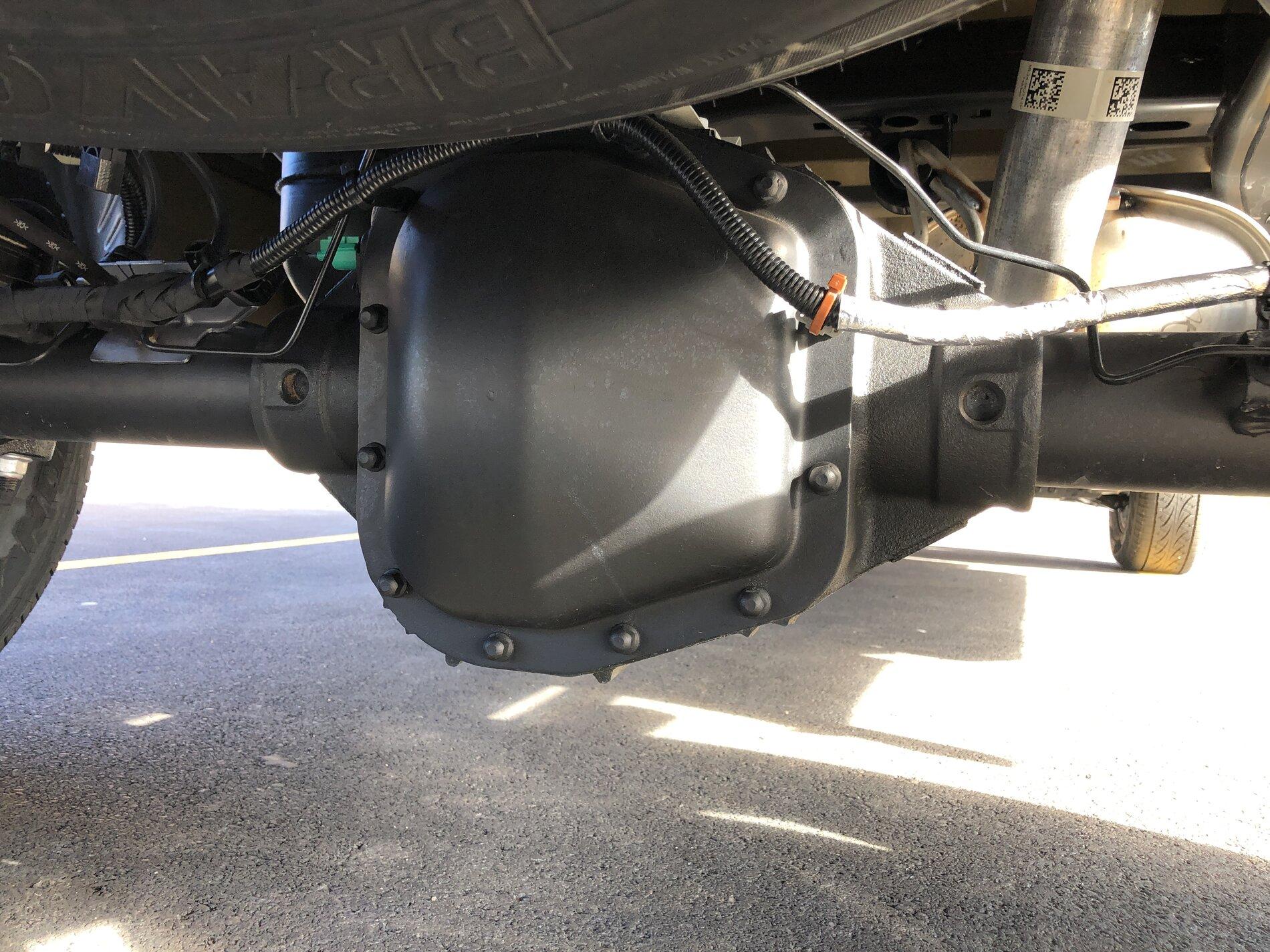

Just wanted to throw this information out there. Ordered a ‘21 super cab with 3.73 locking rear gears. I always wondered if it would be the 8.8 or 9.75 rear end. I did not order any sort of heavy duty towing package.
Turns out it’s indeed the 9.75 per the picture I took underneath today.

Yep - 3.73’s always bring the 9.75 on the 5.0, 2.7, or 3.5

I was told that the 3.73 gears force the 9.75" in all configurations.
There are two different 9.75" axle housings, one for Max Tow and HDPP trucks and the lighter duty axle housing for other trucks.
I think that the Powerboost trucks also get the 9.75" but I don't know if all get the HD axle or not.
I also don't know if they all have the bigger brakes or not but I know the Max tow/Heavy Duty Payload Package trucks won't fit 17" wheels because of the larger diameter brake discs.
