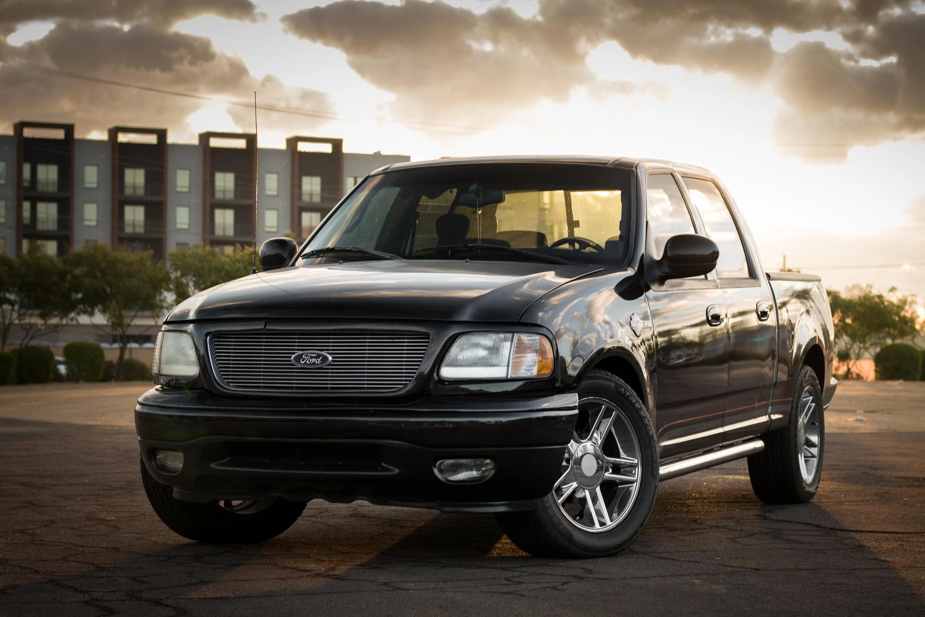

PS. I know we all love pictures of our truck so here is my 2001 F150 Harley Davidson truck. Currently does not have the correct front bumper but I have one in storage.
