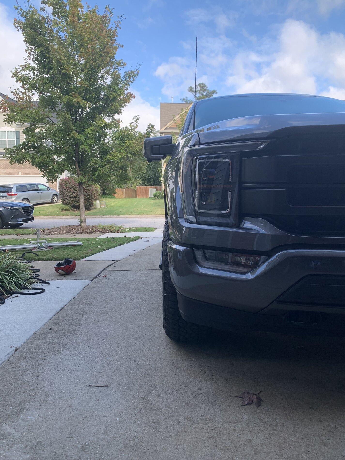

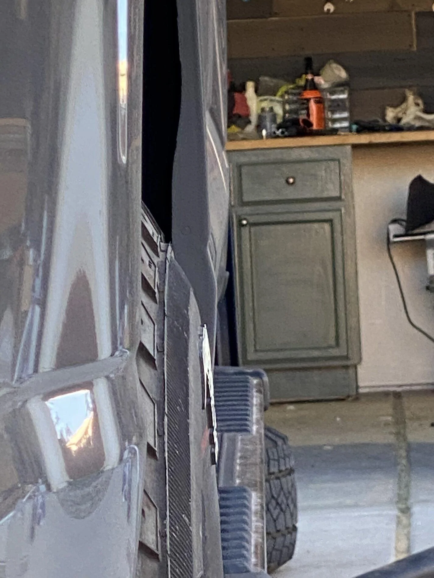

Here is a pic of my stock 18. They don’t poke on top but they do show some tread.

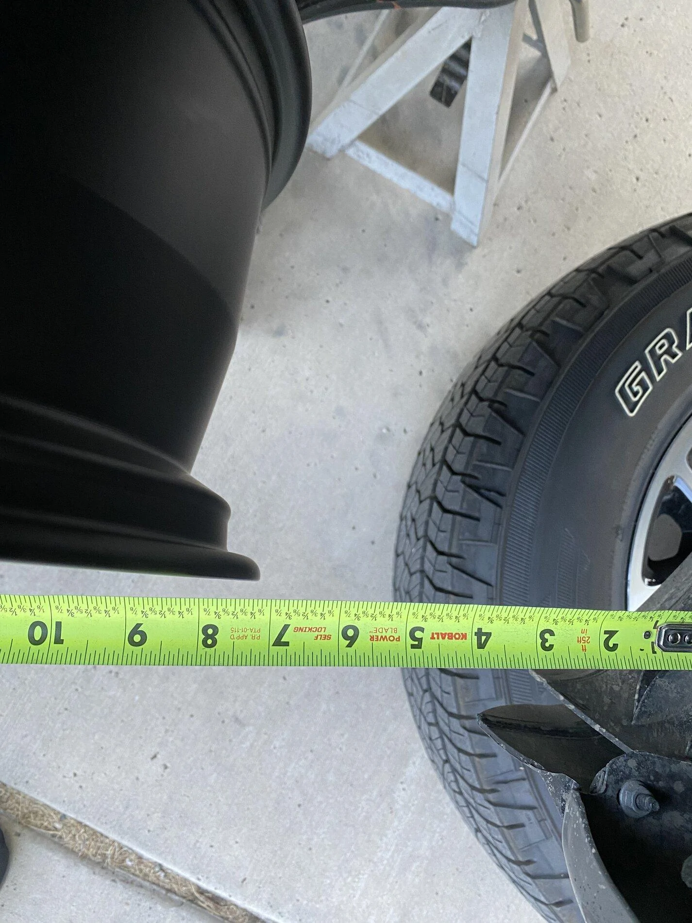

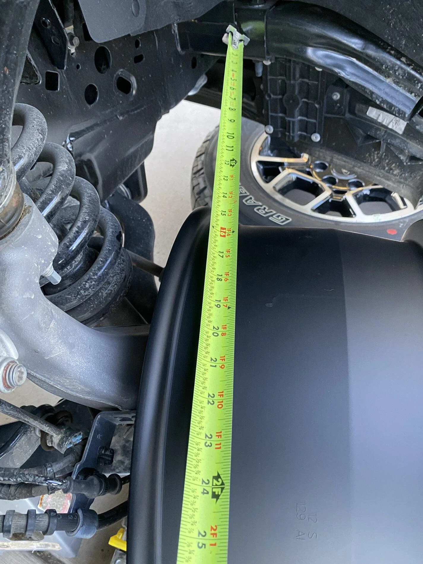

I bought those exact wheels, I haven’t even put tires on yet
I’ll slap one I. The front and do some measurements

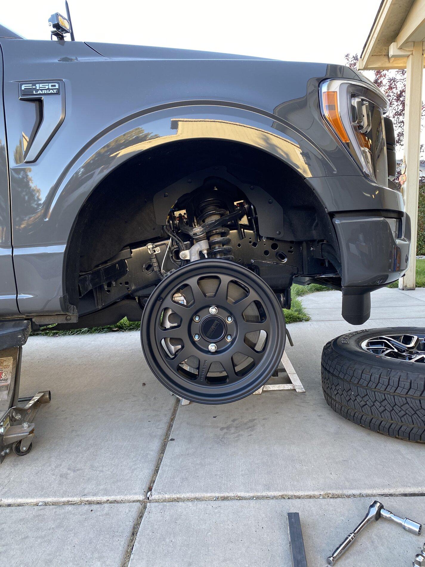

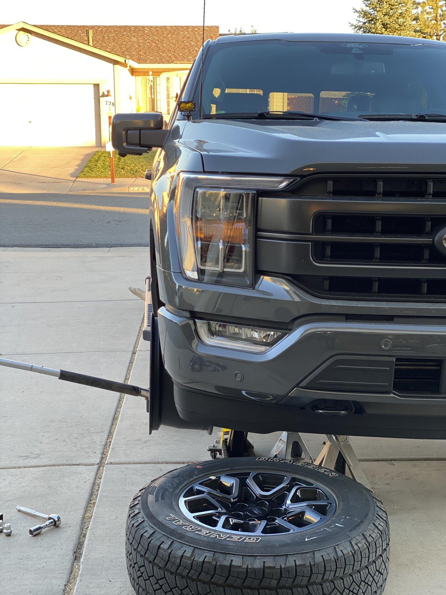

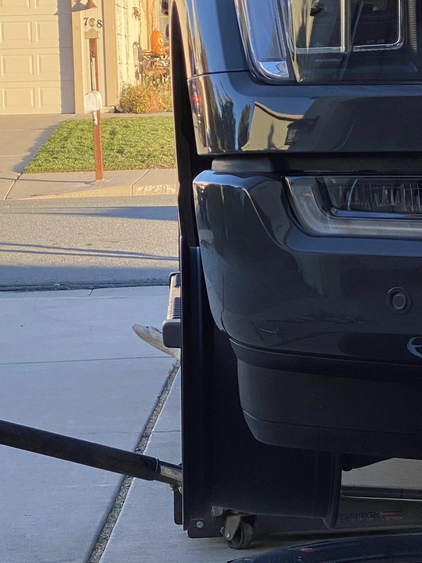

Well I did my best, I do really like the stock wheels, but I had a vision of my “build” before I bought it, and I’m doing the level and tires anyways.
I tried to put pressure under that control arm but it was hard to get realistic compression..
