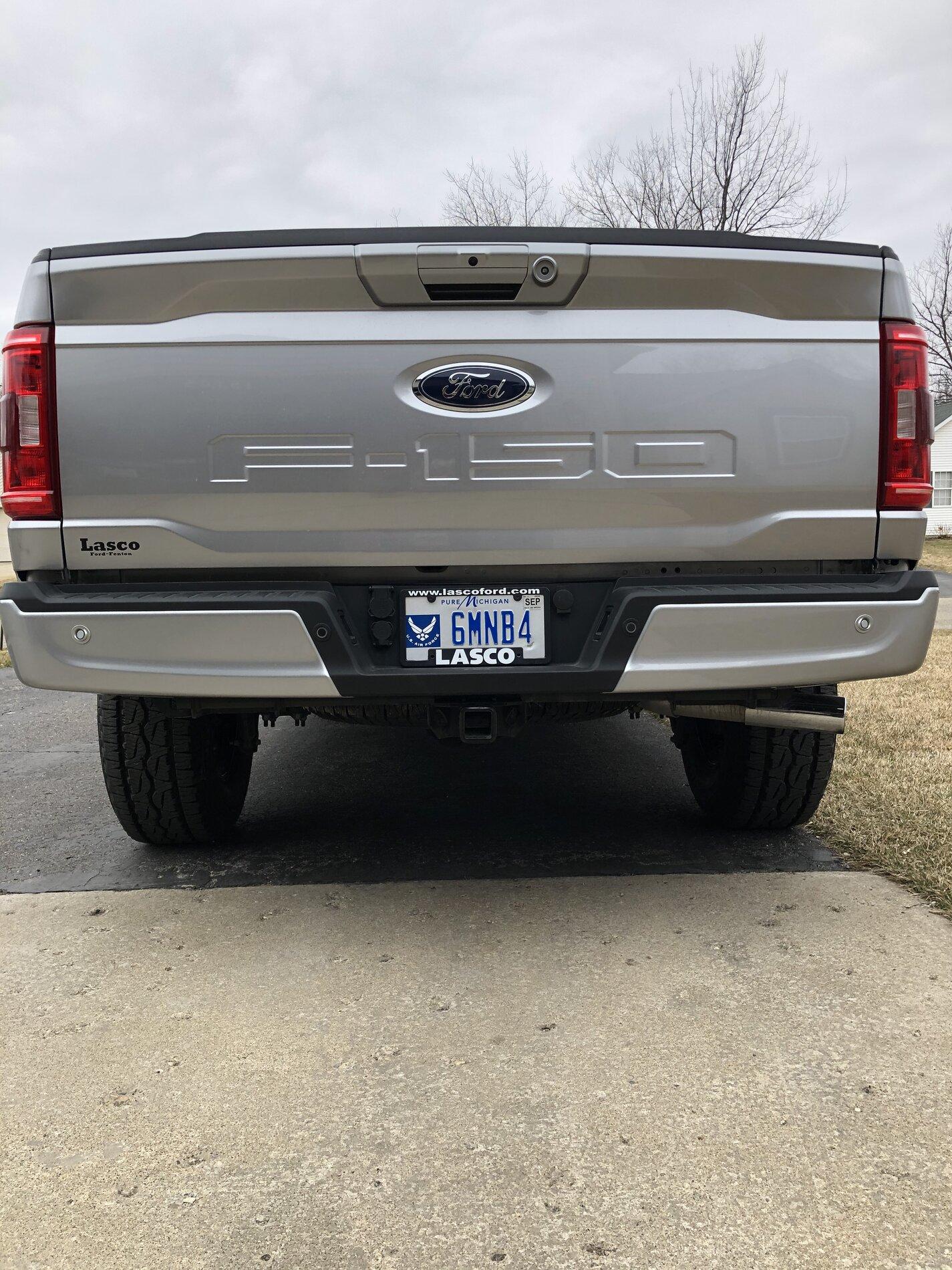

I installed the same size tire as the rest of mine and put it right back up in the hole. 295/70R18
Well shit, now I'm gonna have to buy another wheel and tire that matches to mount under there since I know it fits. Thanks for answering that question, though my wallet doesn't thank you! Haha.
Is the spare the same 18inch sport wheel as the rest?
