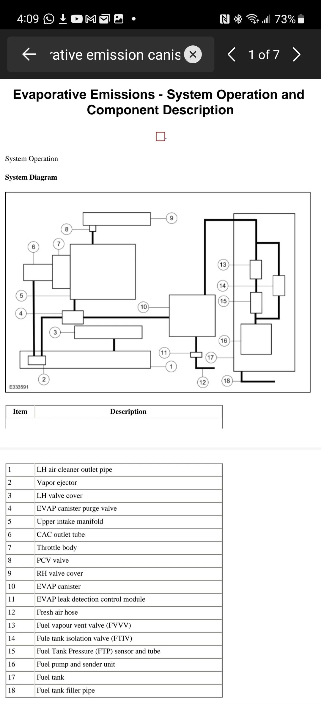

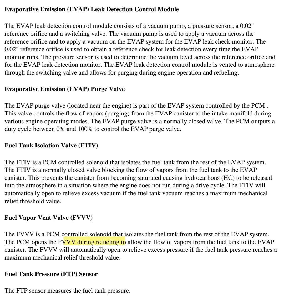

Perhaps the Fuel Vapor Vent Valve (FVVV) didn't open as commanded, so the fuel tank pressure increased until fuel could no longer be pushed into the tank.

Ford F-150 Weird fuel / gas tank issue with check engine light? Screenshot_20230917_160901_OneDriv
Ford F-150 Weird fuel / gas tank issue with check engine light? Screenshot_20230917_160835_OneDriv

Most likely this. The PB fuel system is pressurized, which why it takes a moment from hitting the button to the door opening. If the vent valve didn’t open, the tank was still pressurized and very little fuel was going to get into the tank. This has been reported by some when using the manual fuel door release.
