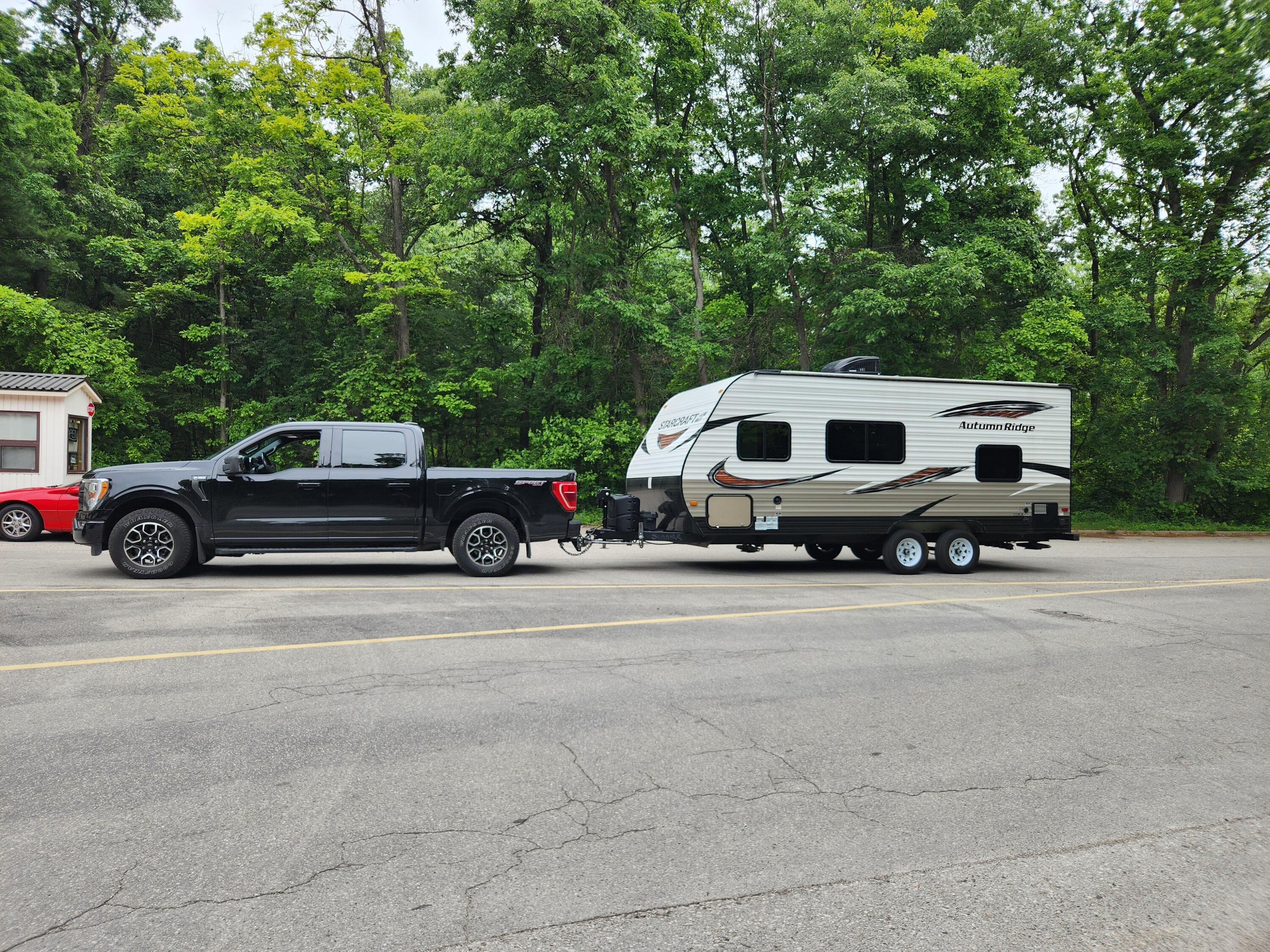

Hi Everyone,
We just got our first trailer and WDH setup. It was a learning experience to setup, but I think I got it. I did find some differences between what Ford recommends in the towing guide and what the hitch manufacturer recommends... I think ultimately the axle loads tell the real story and I'm hoping I made some good decisions. Hopefully some of you with more experience can guide me or give me a thumbs up.
Really happy I ordered the Payload Package for my 2.7L SCREW XLT; seems like the perfect fit for us.
This was basically a worst-case payload for us in the truck:
- Full of fuel (36 gal. tank)
- Two adults
- Two kids
- Dogs (big one, tiny one)
- Big full cooler, extra case of water
- Two bikes, misc. lighter stuff in the bed.
- Other road trip stuff, some luggage.
Trailer was loaded as it always will be but I was carrying about 500lbs more in the grey and black tanks than I intend to on a regular basis. I'm over the trucks GVWR by a tiny amount but I could have fixed that easily by moving a case of water to the trailer, so not too worried.
How does these numbers look to you? I thought getting near-equal axle distribution on the truck, without going over front or rear GAWR was good...do you agree?
The truck setup tows nicely.

Loaded, as-weighed:
Ford F-150 Weighed My 2.7 PP Towing Setup - Looking for Feedback 20230616_134129
Ford F-150 Weighed My 2.7 PP Towing Setup - Looking for Feedback 20230616_183644

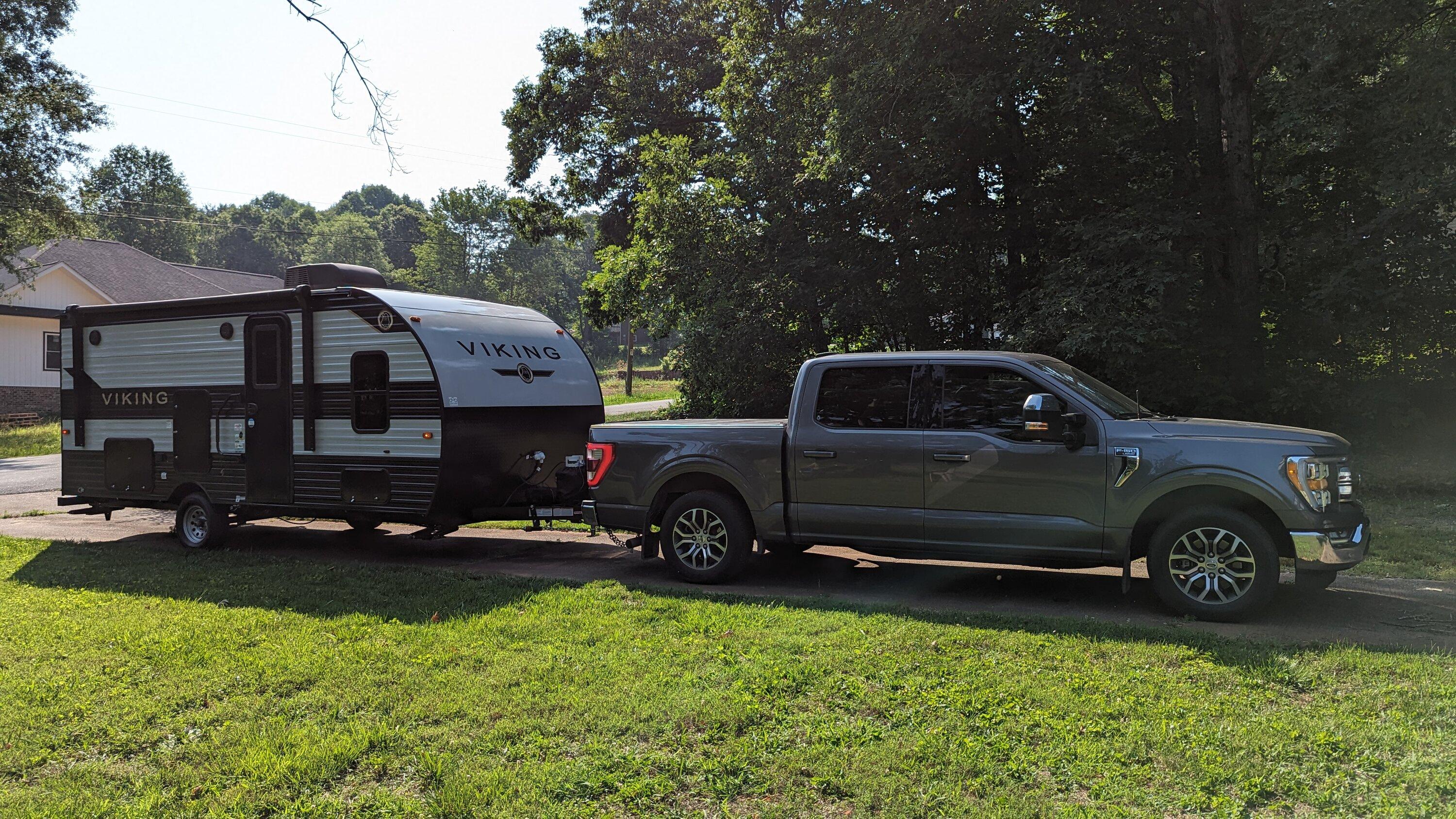

Looks really good to me. I need to do this with mine, I'm just always in a hurry. I'm running a Anderson WDH.
Ford F-150 Weighed My 2.7 PP Towing Setup - Looking for Feedback PXL_20230617_134058680

Ya I mean it looks good for sure. The numbers seem to indicate you would not have a payload problem. But without knowing its hard to say, especially after the description of everything you put in it. The picture seems to be of an unloaded truck, at least from the basis of your worst case description.
If I am reading right, the trailer weighs 5000 lbs loaded? Your only giving 10% for the tongue? I had a similar trailer, one I knew was 5000 lbs loaded as I weighed it on the scale by itself, and when I checked tongue weight I was in the 650 range. Creative loading can get that down, but usually those trailers with the big passthrough storage up front, and probably a large storage under the bed, also up front, and the water tank could be up there....sometimes that number shoots up quicker than one thinks.
The worst-case scenario is what was weighed and what the picture shows. Weights were taken upon departure and photo was taken at my destination. The only difference between the scale sheet and the picture is about 6 gallons (23L) of fuel that I burned getting there and I'm not in the driver's seat; so to the naked eye it looked the same when it rolled off the scale.
The truck is totally stock. no levelling kits etc.
I don't know I'm going to guess ~5100lbs.
The trailer has a dry weight of 3969lbs with 420lbs of tongue weight.
Across the scales, loaded, the trailer is carrying 4500lbs on its axles (combined). I'd not be surprised if the tongue weight is around 600-650lbs (based on the truck payload numbers, I have an idea). I don't really have a concern with trailer weight distribution; though... just that my WDH is transferring appropriately, and my truck ratings are good... After reading some responses, I think I am hearing these results are all positive:
- I am not over any specific axle weight rating trailer or truck (good for DOT / MTO)
- My truck has near-equal weight distribution between drive and steer (good for stability)
- I still have some GAWR left on the truck (and trailer) should I load things slightly differently. Great to have some extra capacity left in the rear axle, as I would likely add weight in the bed, if anywhere. Just eas easily, I can move some things to the trailer...
- My trailer has >10% tonque weight (I can't prove this; it's estimated, probably closer to 12 or 13%. based how much total truck payload has been consumed) - good for stability.
