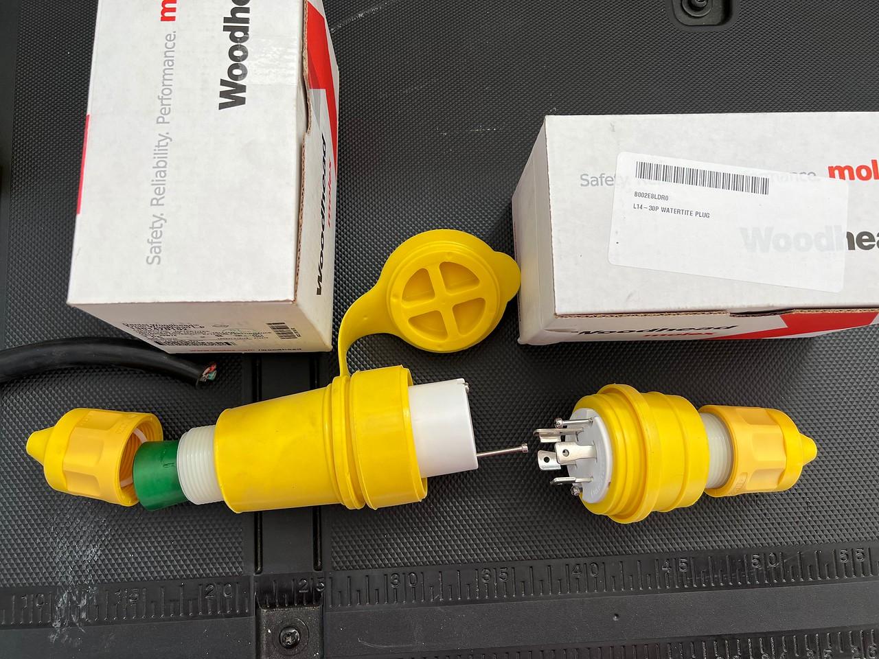

When it comes to connecting a 7.2kW connection I think the best practice is to do it right with waterproof connectors. Look for this connector set. An existing hole in the bed pillar allows the connection to be moved to the bottom of the bumper.
NEMA L14-30 connectors (Molex Woodhead 28W74 and 29W74)

Looks like he "extended" the PPOB 30A/240V bed receptacle to down below the bumper.
Nicely done too.

Thats exactly what he did. I remember when he posted the mod.
And a very nice job of it too. I just don't want it down there.

Thanks. Yes, three umbilicals to the trailer. PPoB extension now has 7,000 miles on it through all kinds of weather. A solid connection to PPoB. The Airstream is fully powered when underway by PPoB, so lithium batteries are always at 100%, refrigerator cold and both air conditioning units running going down the road. PPoB really does change how you use an RV trailer. Boondocking is a word that goes away when PPoB is hooked to the trailer.
