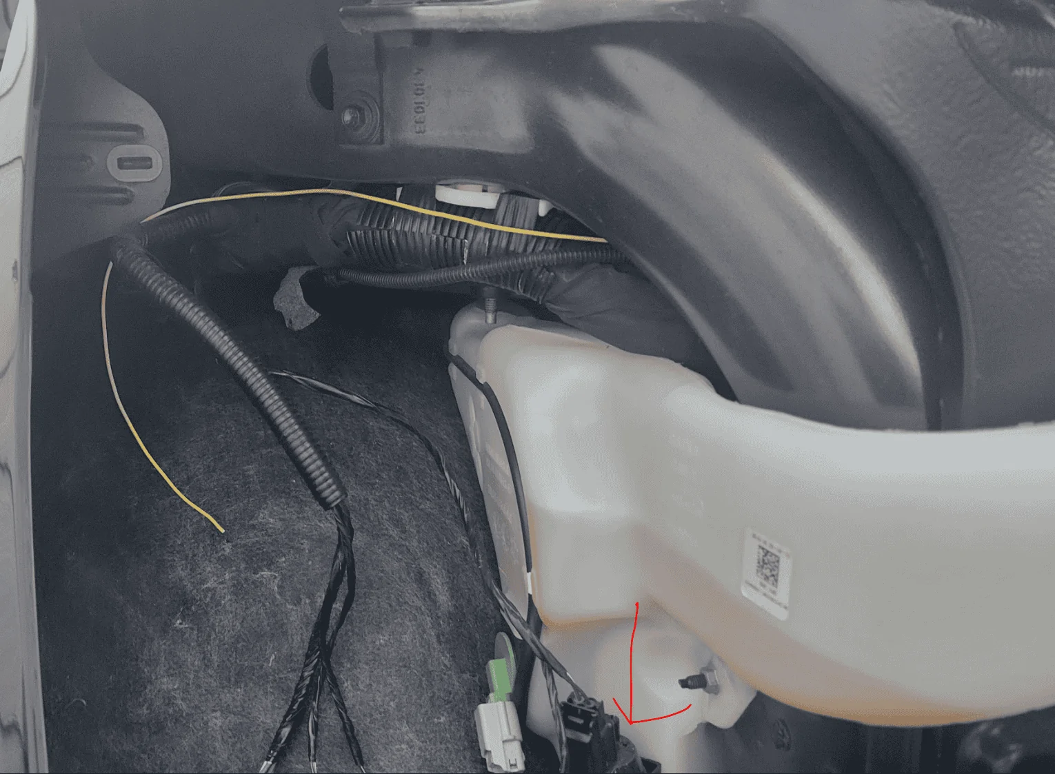

If you wanted to do the repair yourself instead of dealing with ford, the pump is behind the passenger headlight. The grille has to come out. Not sure if you can get to it removing the batt, it'd be quite a stretch if so.

If you hear the pump trying to work, then the filter on the pump is gunked up. You can remove it and then clean the slime off the filter. When you reinstall it, it ill work fine...if the pump itself is trying to work, that is. My 21 Platinum PB did that. It had some orange colored slime all over it from what I presume to be old or bad windshield washer fluid. I could have had the dealer do it under warranty, but it was too easy to do it myself and way faster.

How do I get to the filter on a Powerboost?
In that picture above, it is right behind the passenger side wheelwell. Just undo the bolts for it and bend it out of the way. You will see the bottom of the washer fluid reservoir with the motor sticking out of the bottom. It is pushed into a rubber grommet seal, so it is just a matter of pulling it out with some pressure. Be prepared to plug the hole when it comes out or else the entire reservoir will drain. One of the tools I was using was the perfect size to plug it or else I would have learned that the hard way. You can also do a search for replacing the washer fluid motor on YouTube and several videos will show you how to get to it. On the 2021 F150, I only had to remove the wheelwell cover. I didn't have to do anything with the grille or headlight. I should have mentioned, the filter is attached to the back of the fluid motor when you pull it out.
Right on, you could be able to get to it removing the the wheel well area, didn't think about that. Despite staring at and playing with the wheel well while playing with the headlights it didn't dawn on me that it's an access vector :ROFLMAO:
Your post on the wheelwell saved me a bunch of time. Thanks. My pump was running, no flow. Easy to get pump out from the wheelwell. The filter was stopped up with some sort of green slime. Had to blow compressed air backwards through the pump to blow it out. I have used the green RainX bug remover washer fluid in the past. Will stick to the blue stuff.
