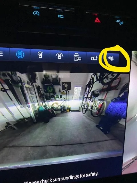

I was changing up a ton of stuff trying to get the cams to work at speed. I do not believe that I had "hitch view" at all, or at least I don't remember it. Now I have a button for the hitch shown below.
Since I changed a bunch of values, I am not sure which one specifically did that, but I would try 7D0-01-04 first. I changed xxxx *xxx xx-- the star from my original "0" to an "F". So, maybe try that and see if the hitch button shows up on your menu. The first pic shows the button and the second is just a view of the hitch.
