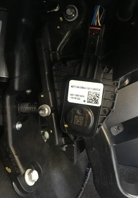

Looking at the parts catalog, it appears that there are two different types of pedals; one with a throttle cable and one without. It’s possible that the problem is with one of those and not the other, which one; who knows?
Ford F-150 Vibration thru gas pedal 7CD86211-AF4B-47D3-A327-AFCA5FFE0C2F
My truck has the 5.0, adjustable pedals and Copilot Assist 2.0
Ford F-150 Vibration thru gas pedal 85654D46-847B-4D4C-BA4B-D5D408F01C06
Ford F-150 Vibration thru gas pedal 7E5F243E-62B8-4787-B6DC-C6F32D1A68B7
it has the pedal with just a wire connection.
