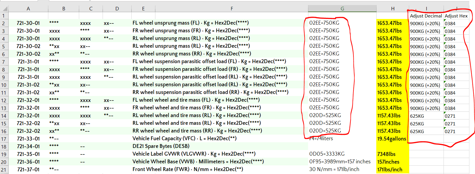

You can see in this photo that the Modules are on the left, and then there are incremental change columns on the right.
When I open my Forscan, I do not see the right columns.
What do I need to see them ??
Ford F-150 VDM module SUSPENSION PROGRAMMING: making the ride FIRM in Normal mode..... VDMedit.PNG
I created those values manually in a spreadsheet in order to keep track of my changes and hex values.
That is not Forscan :)
That's Excel

There is no tutorial for the VDM module that I know of. In fact, I know of very few people who even touch the AsBuilt values in the VDM module.
To edit the AsBuilt values you simply overwrite the existing values appropriately and save the changes.
billkran
Jul 21, 2023
91344
2022 F150 LIMITED 3.5EB
RETIRED

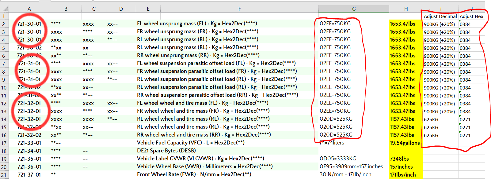

I see in your spreadsheet the factory code for the stock weights, but I do not see a replacement code for the new weights.
In other words, the stock weight of 750kg is coded as O2EE, and the stock weight of 525kg is coded as 020D
Now, moving over to the 20% weight increases, I do not see 'new' code numbers to represent the preffered 900kg and 625kg weights
Am I missing something ?

OK I get that part.
I will try opening forscan again and see if I can figure out where to change the values
THANK YOU
It can be a bit confusing because of the overlap between a single line in Forscan WITH multiple lines in the spreadsheet.
