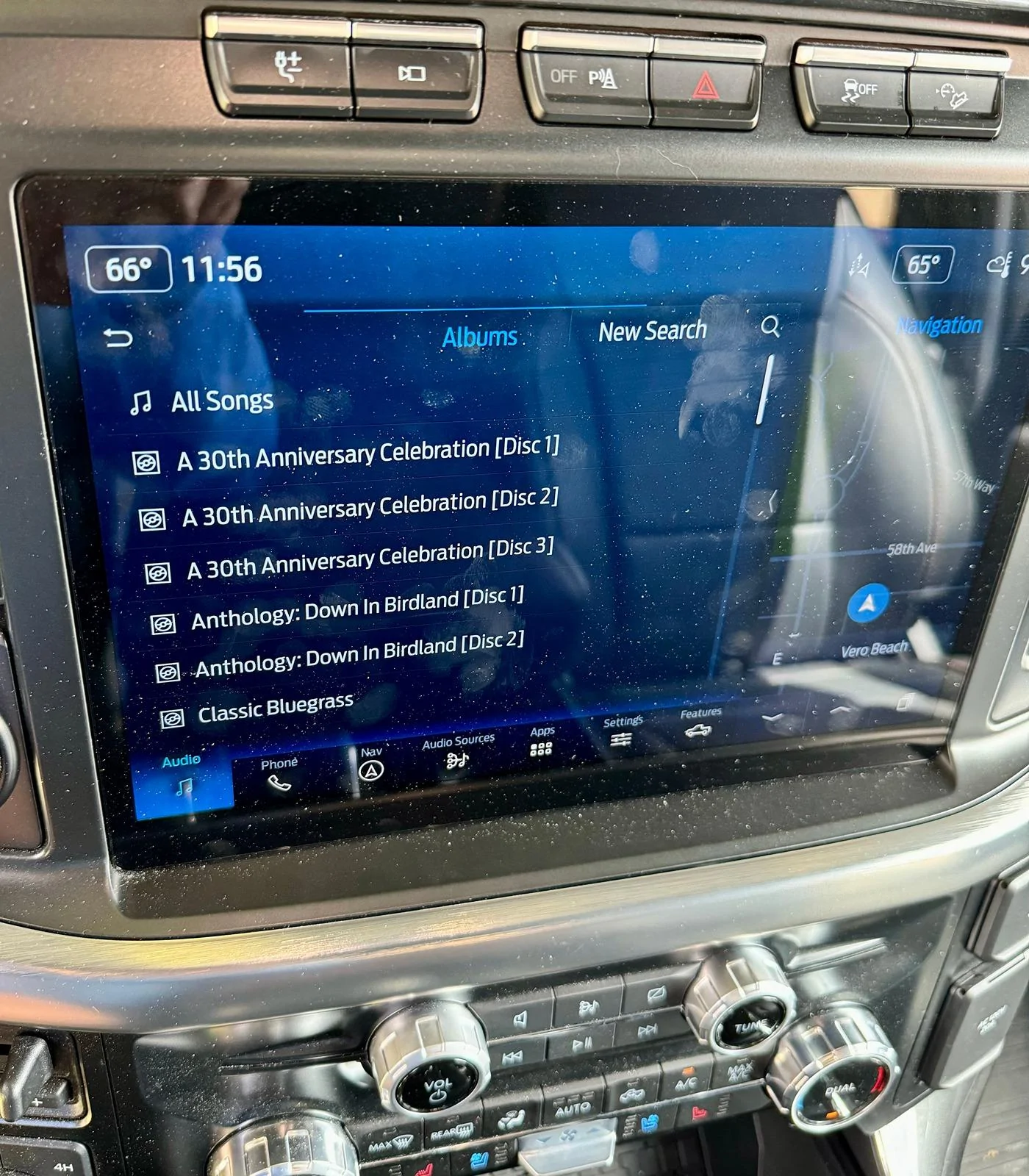

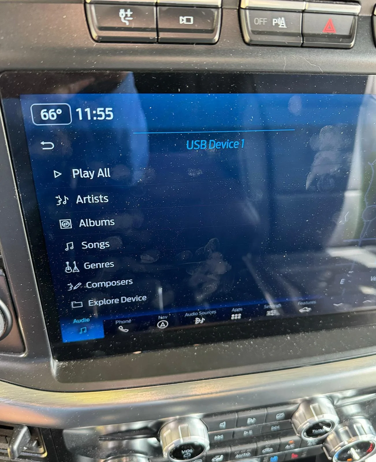

I too have a NAS and roughly over 17k tracks/files. I have a 128G thumb drive with about 5,300 tracks in the truck and still have lots to organize and sort through in my free time. I listen to pretty much anything from A-Z if it has a good beat or fun lyrics.
I pay attn to the filenames and I know it'll play them in alphabetical order. No files on my root folder. In there is "Assorted" then specific genres of music. Under those genre folders, is both album folders and individual files for when I just want certain songs. Again, everything plays in order so for the albums, I make sure they're prefixed w/numbers
01 - Blah Blah
02 - Blah Blah
03 - Blah Blah
No issues. I use MP3Tag to manage the data in the FLAC & MP3 files. Voice commands work about 95% of the time but I typically just play full albums or the bunch of assorted tracks in each genre.
