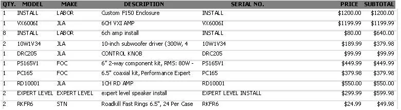

After researching it and realizing what it takes to upgrade the original B&O 8-speaker setup and the price of the amp that was left, I knew the previous owner didn't skimp on the components. Now, I was very interested in finding out the exact setup they used. I ended up contacting him. He was super nice and sent me the invoice from the audio shop that supplied all of the components and did the install.

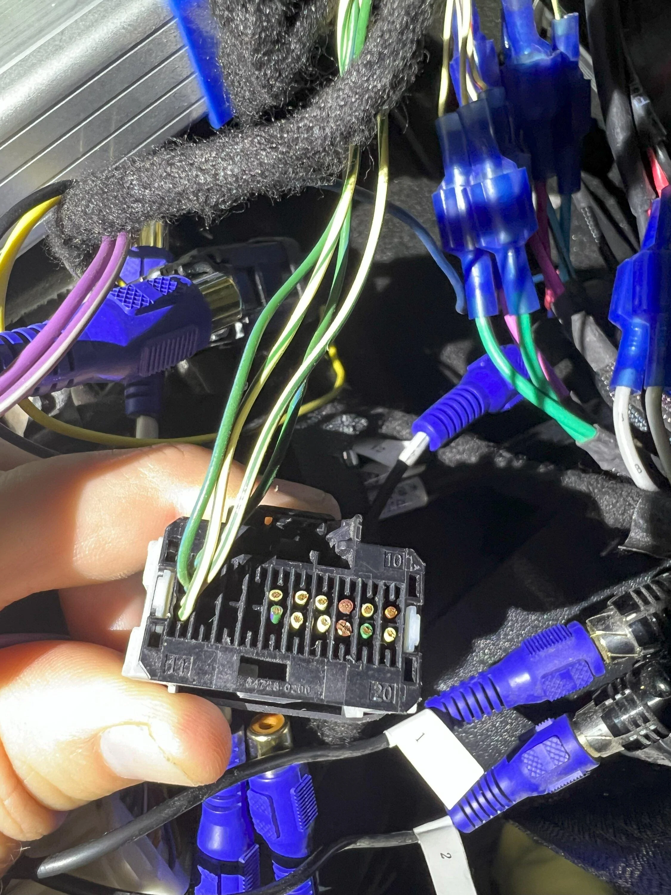

Then, I unscrewed the amp rack to check behind it and this is what I found... It was just crammed in there all tangled up.

It is what it is, but I'd like to get all of this crap cleaned up and have some questions.
1. Is there anything I can do to fix the hacked-up harness? Is it worth it at this point? What issues could this cause in its current state?

3. Looking at the invoice, they charged for "Install AP4". Is an AP4 AND a NAV-TV normally used together or did they just charge 3 hours to install the NAV-TV and label it AP4? If it is a required component, would it be in the dash? I get the chimes through the speakers most of the time, but it does revert back to the dash module randomly.
4. It lists a DRC-205 control knob was installed but the one that’s currently installed looks more like the RBC-1. A phone-line type cord is connected to the VXi amp but there is no noticeable difference when adjusting the knob at the dash. Any ideas here? Initially, I was hoping I could avoid pulling any dash panels off to I.D. this stuff but that’s probably out the window now.
You can buy the PAC Audio APH-FD02 harness and use that to fix the factory plugs/connections.
You only have a ZEN. Chances are they assumed they needed an AP4 or they had issues with the AP4, so they used a ZEN.
Just make sure that the ZEN power + ground are connected to the power/ground from the battery, not from the power/ground in the factory harness.
Might be a setting in the DSP itself on what that knob actually adjusts. I think it can do multiple functions.
