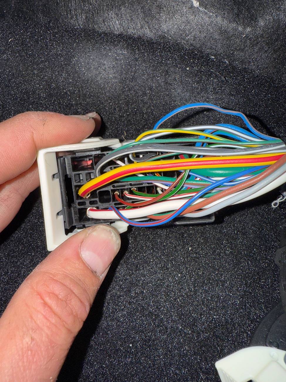

Hi, can anyone help me with a question please. I’m installing the boosted gg harness and don’t have pin 23 available on connector 2280C, which is flagged in the instructions from GG. Only 24 and 25 is open, can anyone help me identify another location that that pin can safely be plugged into?

Got feedback, sounds like I needed to unpin the 23 pin and use the one from the harness. Curious where that original green and orange one wire actually goes..

On the harness I got from them, the unpinned wires you just tape and leave. At least on the I got.

Yeah, I’m just curious where that wire goes. Install was a breeze, but about half of it was trying to figure out that wire.

If you replaced it, it just get tapped and set aside. Will not be used
