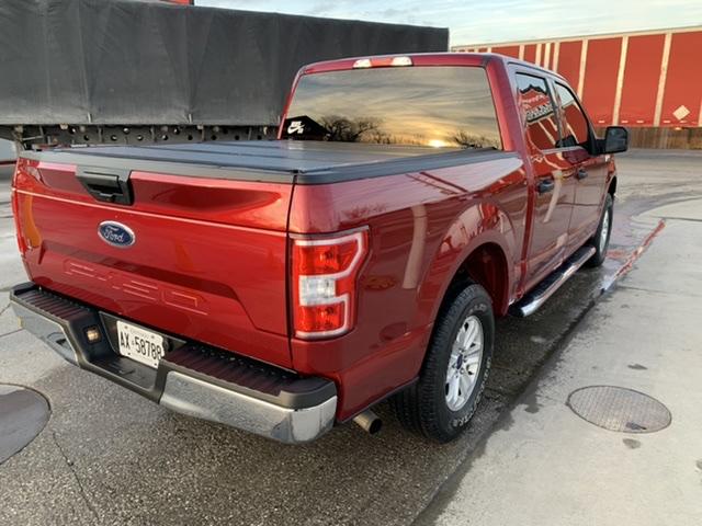

I was really interested in the ceramic coating all the way up until I learned how much it cost and how long it took to do. I personally don’t want to spend that much unless it was a really expensive car or a classic that needed that kind of protection.
I am going into my third year with my 2018 XLT and it’s so shiny and in good condition that I often get asked if it’s a brand new truck that I just picked up.
i’m gonna tell you guys what I do even though I know it will most likely be frowned upon by many.
I said I go to the automatic car wash at least once or twice a week.
The truth is I go almost every day if I have the time. I wouldn’t say it’s a high-end car wash place but it’s definitely above average.
I pay just under $50/month and it includes hot wax and some type of ceramic stage(probably bs), Under body spray and I don’t know how it works but it does some thing that makes my wheels and tires really shiny.
now I know that automatic car wash is leave a lot of swirls but maybe because of the wax and other chemicals this one uses my swirls are very minimal. I did get a small scratch one time which looks like a little rock or piece of glass or something got stuck on one of those spinning things probably from another car but other than that my truck actually still does look brand new.
I will put some pictures up later after the wash because it’s actually sunny and above zero today.
The main reason that I wash it almost every day is because when I originally went to pick it up I ordered a black XLT. Then on the last day before pick up the dealer told me that they sold the last black one and the only other model with 4x4 available was the red one, which I hate.
I’ve always hated this truck up until a few months ago, I guess the red finally grew on me. I do get a lot of compliments on it but that’s mostly because it’s always super shiny and looks brand new. There are absolutely no modifications on it at all except the dark tinted windows.
The 2021 that I’m waiting for is a white two-tone. I’m going to do the same thing with that one.
Car wash almost every day and if it behaves for three years (unlike my 2018)and I decide to keep it then at that point I will probably bring it in for the fluid film application and maybe get it professionally hi speed buffed and polished.

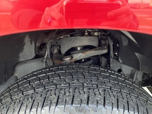

This is the only rust I can find. Front wheel well.

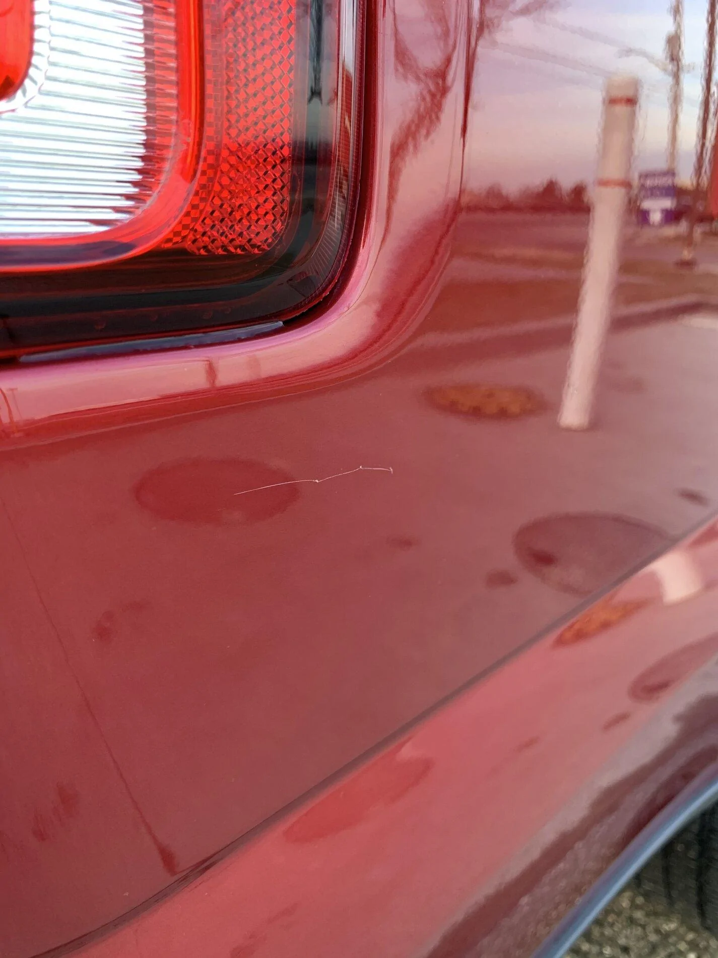

That’s the little scratch that I got from the car wash.
I am not a paint expert but I was trying to find some swirls to show from the car wash but I honestly couldn’t find any.
I’m pretty sure it would be a different story if I had proper lighting but From what I could see in that natural light there weren’t any swirls at all.
