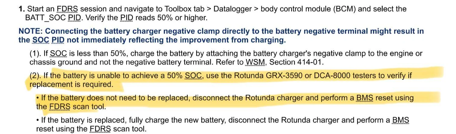

I urge you to not reset the BMS by whatever means.
The Ford Workshop Manual is explicit in saying the BMS should only be reset when the battery is replaced with a new battery. That procedure resets the battery age parameter in the charging algorithm to zero, which bears on the long-term algorithm behavior (the battery age parameter is stored in non-volatile memory so it is retained even if the battery is disconnected for whatever reason / duration and then reinstalled, as might occur when doing a lengthy unrelated repair procedure).
Resetting the BMS is not a recommended action found in any of the Workshop Manual charging system troubleshooting procedures.
I strongly suggest you put the battery on a proper AGM charger (e.g. Noco 10) to bring up the SOC and see how things go from there. Your system is likely set with a default target SOC of 80%.
FYI it took ~30 hours for a Noco 10 to bring my H8 battery from ~70% up to 100% SOC. Since doing that my truck has had no problem keeping the SOC at or near 90%, which is the revised target SOC I set with FORScan (PC version). Noting that frequent short trips do pull that SOC down, but it recovers with a good highway drive.

I concur that you shouldn’t just reset the BMS willy nilly without a good reason. It is primarily to be done when the battery is replaced. But even the latest software update TSB and others has the Tech possibly doing it without replacing the battery. Example below:
So, my point is don’t panic just because you reset the BMS one time.

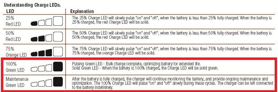

I pulled the charger off this morning after about 23 hour charge and the one light on the charger was going on and off, stating it is done.
Excerpt from noco10 manual for reference (red box highlight added by me)
Could be wrong but I suspect that you've not reached the noco "ongoing maintenance and optimization" mode. Note that the "on and off" of the light for that mode is very slow, with a long interval between the "on / off" lights.
If you did not observe a period of solid green light than I suspet you interrupted the charging process while still in the mode of "optimizing for extended life" which displays a pulsing light.
it can take many hours of uninterrupted charging with no other loads like door-opening (yes, more than 23) for the noco 10 to achieve 100% charge as indicated by a solid green light.
Once at 100% charge, the noco won't enter a cycle of "ongoing maintenance and optimization" (with attendant slow off/on light) until the battery has depleted a bit due to a load (like opening a door) or sitting totally undisturbed for a period of days with only 'sleep mode' loads.
In summary, I don't jump to any conclusion about your battery health. I think it's likely you've not been though all of the time-consuming the steps required to truly fully charge your battery and then assess its health.

Hmm...I have to admit that the Pulsing green and the On-Off green seem very confusing and I might get those mixed up.
