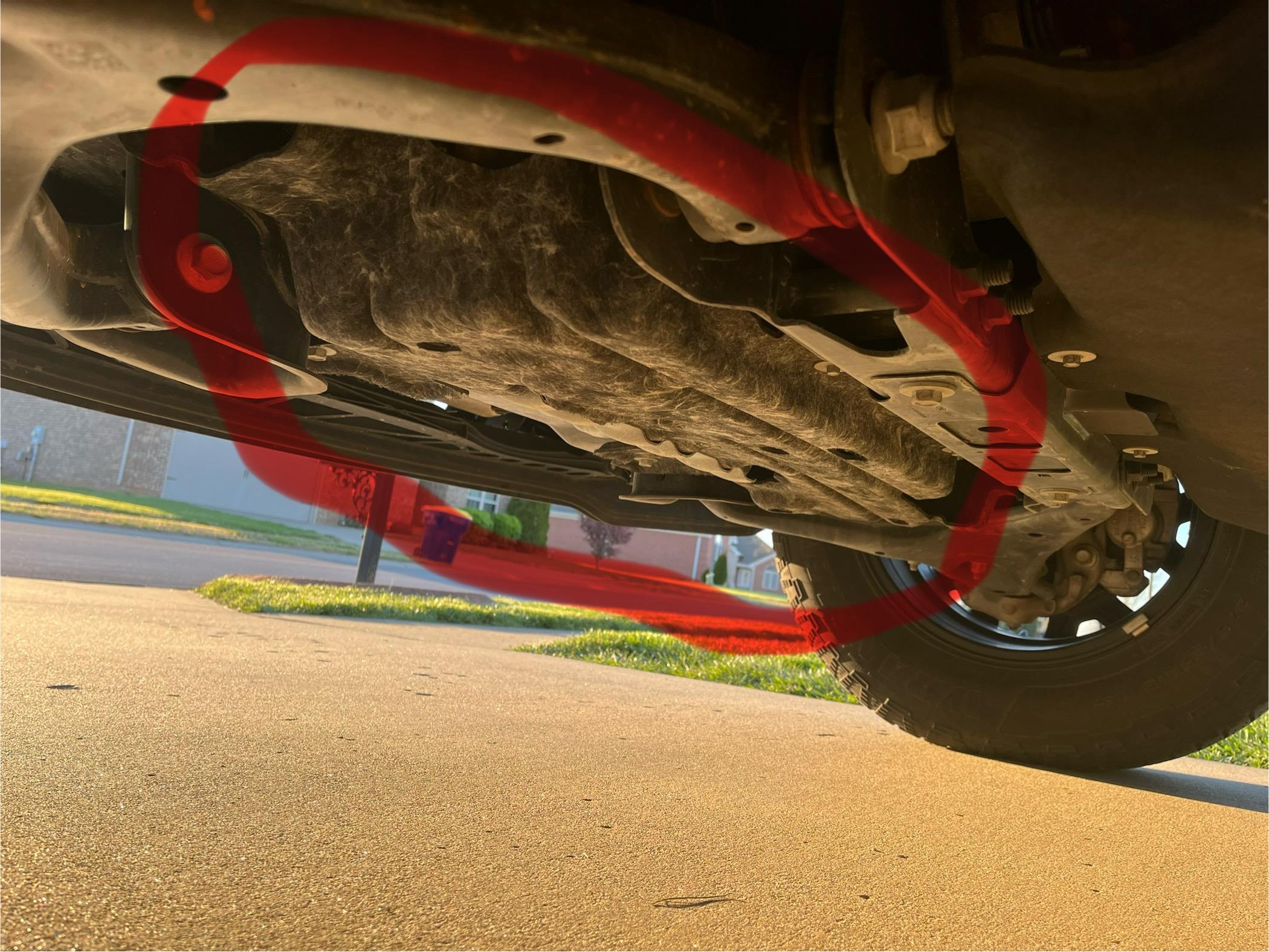

Hoping to find source of noise without having to take to dealer. Noticed today when I crawled under front, this felt piece seems to be a little loose in spots when tapping on it and it’s making some noise when hitting bolts….got me wondering if this being loose might be making noise when I press the gas. What is this piece and what is it for? Heat shield?
That is there for noise reduction. You can take it off. Many trucks left assembly line without it. If you have less noise with it off then I'd keep it off.

Unfortunately not. I removed that felt diaper but still has the same issue. It’s the only thing I don’t like about this truck. Sure wish I could find a fix…..let me know if you find anything
