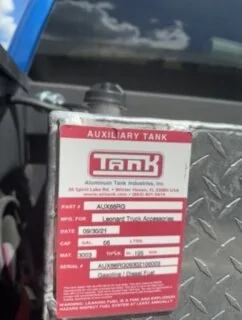

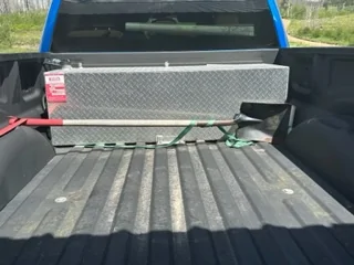

I've done that. I purchased a 66g tank from Leonard Online Truck Accessories and installed it a few months after taking delivery of my truck. I can now achieve some 2000 miles range which means I can get down to I-80 where gas is typically 50¢/g less. Here are some pictures. Also whatever tank you purchase, ensure it is both a Transfer and an Auxiliary tank. For gasoline, the fuel suction must come out of the top of the tank, it cannot come out the bottom as with diesel tanks.
Note that you have to use aluminum nuts & bolts. I also put some rubber strips on the bed ribs to minimize rubbing damage.
