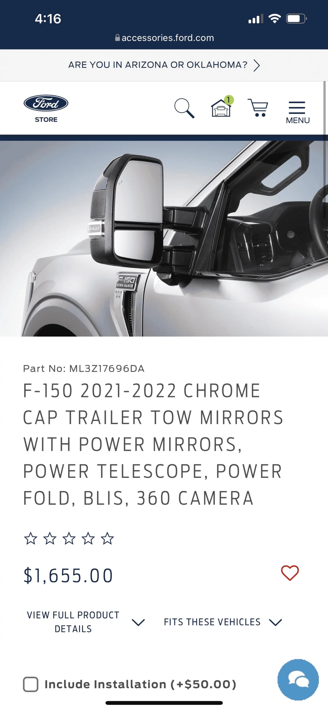

If one’s truck is equipped with a 360 degree camera, would it be a plug and play to install factory trailer tow mirrors?? TIA!

I have seen people say the cameras would need to be calibrated, but a trim guy at the dealership said it would be plug and play. One thing I was thinking about doing, but have not pulled the trigger on yet, is to purchase the mirrors from the Ford accessories site. There you can schedule to have them installed at a dealer of your choice for $50. If that is the case, I would not think they would give it back to you if the cameras were not calibrated. Have you bought the mirrors yet?

only labor is $50?? that sounds too good to be true!

Well damn weren’t you correct.

I swapped from standard mirrors to the manual fold tow mirrors. I do have 360 cameras. You will need to recalibrate the cameras after the install. If you don't, the image won't quite line up correctly, and you will get a Reverse Brake Assist Not Available error every time you shift into reverse.
If I did it all over again, I'd pay the dealer the $50 and make sure they recalibrated before I left. It's even more worth it if you're buying the power fold mirrors since there are a few more steps involved.
Almost forgot, you'll need Forscan to activate the side marker lights on the tow mirrors. From what I have read, dealers can't or don't know how to do this.

do you think you could’ve installed power folding and power extending tow mirrors on your XLT?

Absolutely, I just didn't want to pay $1600 for them. I think you'll need to make some Forscan changes to get them fully operational.
Does your truck currently have power fold standard mirrors? If not the dealer might not be able to do the install for $50. I'd call and ask them before ordering.
