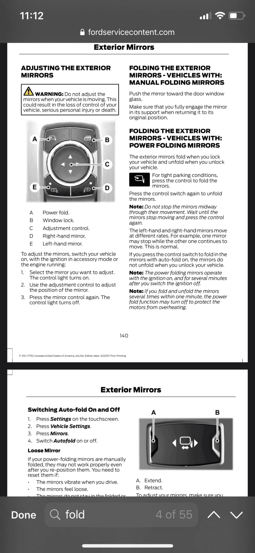

Interesting. The manual pasted above shows the "autofold" setting as an option. But you have always had the tow mirrors so I also trust your knowledge.
Which raises one more question, which is telescoping... I thought they were electronic telescoping as well but I don't see where it is an independent function. If they fold out to normal drive position, do they automatically telescope out as well? I just assumed I'd be able to add a few inches only when towing, but then pull them in the few inches for normal everyday driving.
Well the manual is showing a stock mirror, the tow mirrors use to work some different so don't know what they are doing for the 21s.
Will have to check the manual and see if there is a specific info for the Tow mirrors.

In 2019 non of the mirrors auto folded. Depending on model the mirror could be power folding and power retracting or manual folding and manual extending / retracting. Power Folding, power telescoping is Lariat on up...
It appears that the 2021 will come equipped with auto folding suspect this will be the case for both the standard mirror and the Trailer mirror but I am not able to verify.
Trailer Tow Mirrors, Power-Folding, PowerScope Telescoping, Power Glass – Heat, Turn Signal, Memory, Auto-Dimming Feature (Driver's Side), High-Intensity LED Security Approach Lamps, LED Sideview Mirror Spotlights and Chrome Skull Caps
and from the 2021 manual
FOLDING THE EXTERIOR MIRRORS - VEHICLES WITH: POWER FOLDING MIRRORS The exterior mirrors fold when you lock your vehicle and unfold when you unlock your vehicle. For tight parking conditions, press the control to fold the mirrors. Press the control switch again to unfold the mirrors. Note: Do not stop the mirrors midway through their movement. Wait until the mirrors stop moving and press the control again. The left-hand and right-hand mirrors move at different rates. For example, one mirror may stop while the other one continues to move. This is normal. If you press the control switch to fold in the mirrors with auto-fold on, the mirrors do not unfold when you unlock your vehicle. Note: The power folding mirrors operate with the ignition on, and for several minutes after you switch the ignition off. Note: If you fold and unfold the mirrors several times within one minute, the power fold function may turn off to protect the motors from overheating.
Exterior Mirrors Switching Auto-fold On and Off
1. Press Settings on the touchscreen.
2. Press Vehicle Settings.
3. Press Mirrors.
4. Switch Autofold on or off.
Power Telescoping Mirrors (If Equipped) This feature lets you position both mirrors at the same time. E218902 A. Extend. B. Retract. To adjust your mirrors, make sure you switch your vehicle on, with the ignition in accessory mode or the engine running.
1. Press and release the control switch.
2. Press the adjustment control to position the mirrors. 3. Press the left arrow to extend the mirrors out. Press the right arrow to retract the mirrors in.
Note: Moving the mirrors 10 or more times within one minute, or repeated folding and unfolding of the mirrors when holding the control down during full travel, could disable the system to protect the motors from overheating. Wait approximately three minutes with the vehicle running, and up to 10 minutes with the vehicle off, for the system to reset and for function to return to normal.
