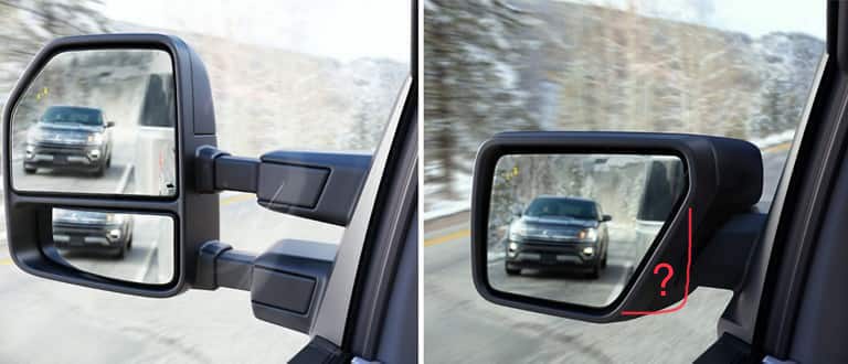

I have the tow mirrors on my 2021 Platinum and just dont care for them. Is it easy to convert back to the standard mirrors? Are there people willing to trade who want tow mirrors? I surely dont want to go directly through Ford as it will cost me an arm and a leg!

I got my standard mirrors replaced by the tow mirrors. I think that the truck looked better with the standard mirrors but I can see better with the tow mirrors.
I'm also guessing that the tow mirrors increase the drag just a little and gas mileage is therefore a little worse. I'm not sure how significant that is.

Again, nonissue, but could depend on your height. If you are one of those folks where people do a double take to see if there’s a driver behind the wheel, you might have an issue. I suggest going to a dealer and sitting in either an F150 or a Superduty truck with towing mirrors. The cab sizes and formats are identical for all Ford pickups in terms of where the driver sits and placement of the mirror, so it will tell you what you need to know.
I sit relatively low in the vehicle so the tow mirrors blocking forward view at intersections is a real thing but not what I would consider an "issue" if you adjust your habits for them. If you look for pedestrians and bicyclists (lots of sharp metal things on them that will damage paint) as you roll up to an intersection and not just after stopping or reaching the intersection you can see the area that is later blocked. It's a small adjustment well worth it for the advantages of the tow mirrors. As I posted a few weeks ago (I hope it wasn't earlier in this thread), it's a lot like adjusting to the 157 WB, pulling a trailer, carrying cargo that blocks the rear window or something as basic as having the sun visor down....you just need to be aware of it and adapt.
