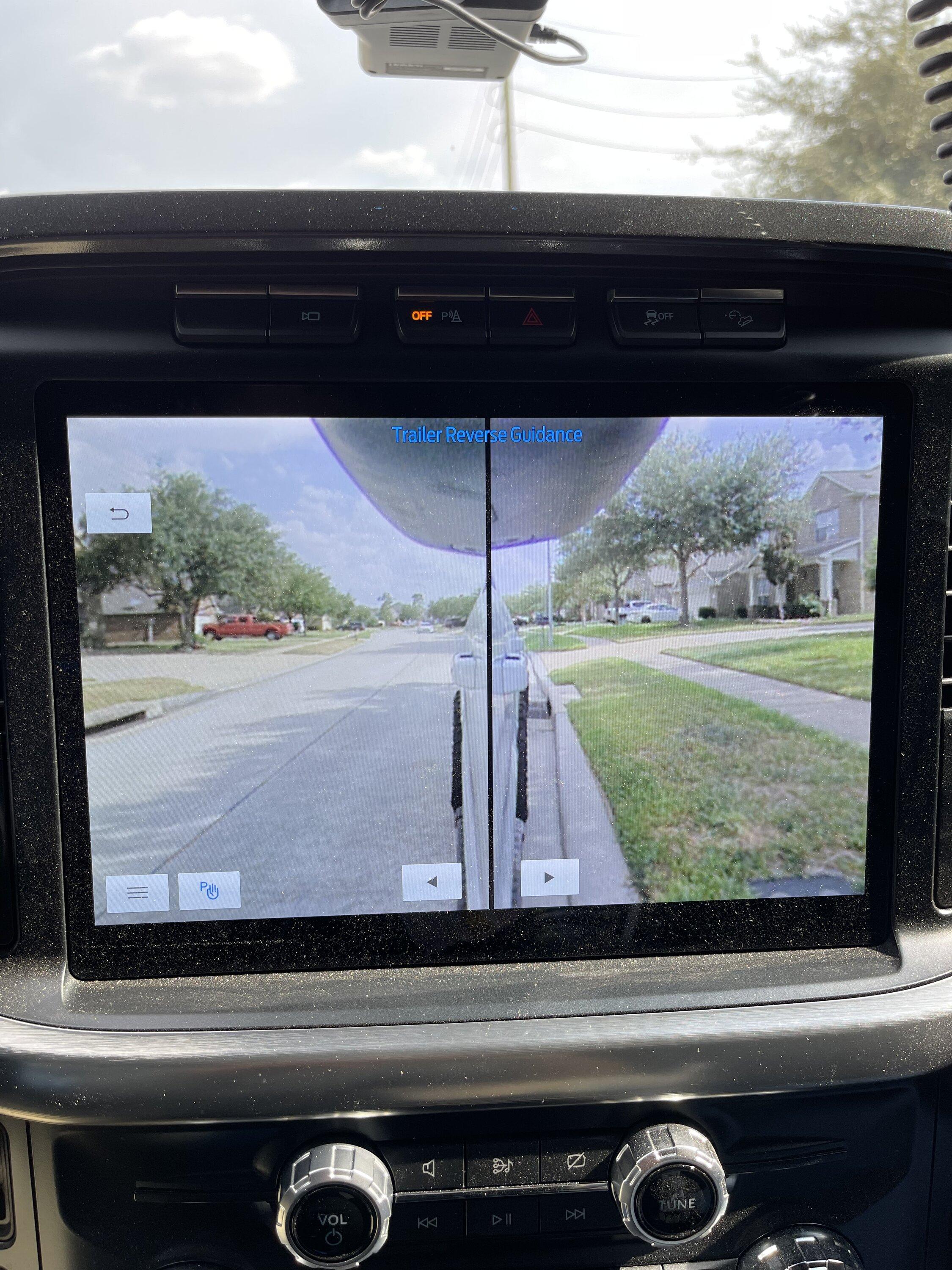

does anybody know if you can have the trailer tow mirrors recalibrated? mine are somewhat off center and i’m curious to know what can be done?

What do you mean "recalibrated"? What part of them is off center? There's so many moving parts, which one? More details, please.

the actual view on the screen display. my apologies for lack of explanation.

Hmmm, ok, but what mirrors are you talking about? Are you talking about the 360 Camera view that uses all the cams, including the ones in the outside rear view mirrors? And that view is off?

Ah, so this has to do with your 360-degree cams display, not your trailer tow mirrors per se (the side cams happen to be mounted in the non-moving base of whatever mirrors are installed).
Please post a pic of the "off center" display to illustrate your problem.

the camera that is attached to my side mirrors.

yes that is correct. they are fixed to the base of the trailer tow mirrors.

Can you post a pic of your display screen showing the "off-center" problem?

notice the position of the mirrors on the screen.
Ah, thanks for the pic, now getting closer the the specific situation - this relates to the Trailer Reverse Guidance split-screen view in particular? No other views?
Yeah I see that the two sides differ slightly relative to each other, but honestly that doesn't strike me as disturbing or detracting from the functional purpose of the view at all. I guess my OCD isn't as rampant as yours in this case (light hearted comment in good spirit, no offense intended, there's certainly things that bug me ;) ).
I do know there's a complex procedure described in the Workshop Manual for 'recalibration' of the cams to ensure the different cam images 'stitch together' correctly for certain views.
I quickly reviewed that procedure when I had a 72-hour subscription to the online Workshop Manual but that's not a section I chose to save to my archive for later reference so don't have it to share it with you, sorry. I do recall it required the use of Dealer Diagnostic Tools, nothing that could be done using menus we can access in the vehicle.
I wouldn't hazard a guess about how getting the dealer to undertake that procedure that might change the problem you perceive in that particular view. Personally if that's the only problem with the cams / views I'd be loath to let a dealer mess with things (for fear of a worse outcome or other unintended consequence), but that's just me.
Good Luck! :)
