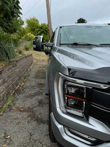

I recently ordered OEM trailer mirrors from Fairway Ford in Ohio. Mirrors showed up extremely quick and I love the new look of my truck.
My truck is a 2023 Lariat FX4 with BLIS 360 camera power fold, heated, power adjust capable.
The mirrors I bought are all of the above with the addition of power extend capable
Install was extremely simple, and plug and play. The entire install took me maybe 45 minutes from start to finish
BUT
Now I'm having a couple issues.
My First issue- Telescoping feature does not work, even with the included switch from ford. Yes its plugged in correctly.
My second issue- Running lights on the new trailer tow mirrors don't stay on while driving. I've seen people say they are supposed to be amber but mine are white lights. They DO turn on when I manually activate the puddle lights using the switch inside the cab.

Ford F-150 Trailer Mirrors not Telescoping. PLEASE HELP IMG_1010
Ford F-150 Trailer Mirrors not Telescoping. PLEASE HELP IMG_1014
